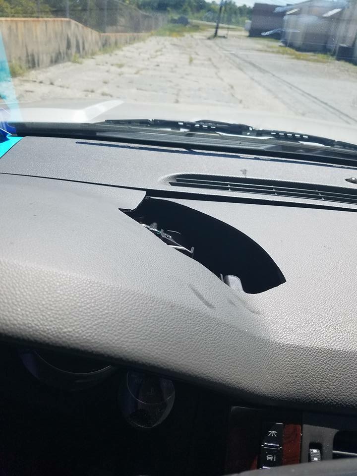

Mine looks like POS as you can see. I guess the overlay is an option to consider.
I was thinking it was a cheaper option and if you are going to reinforce the bottom of a new dash anyway then you may as well cover it and reinforce the old one.
It's more labor intensive but would save a lot of money on buying a new one from the stealer.
