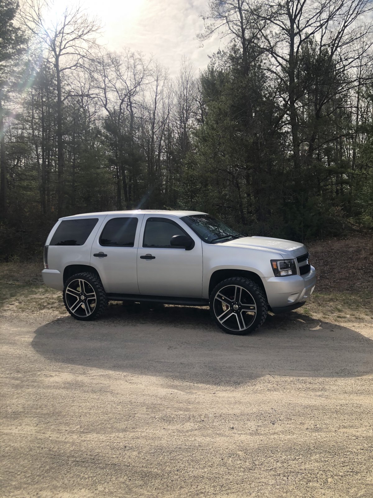

2005 tahoe, with level kit. Keys are just about maxed out. 33" fury country hunter m/t x 12.50 x 24's
24x10 Positive 24 offset no rubbing
Wanted 35" m/t but would've had to trim
