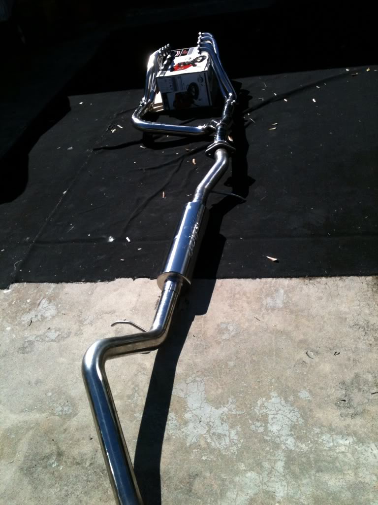

Side note and not to jack his thread, but speed engineering protype header kit *should* start rolling in within the next few days. I recommend you get one asap @chevync @ezdaar
