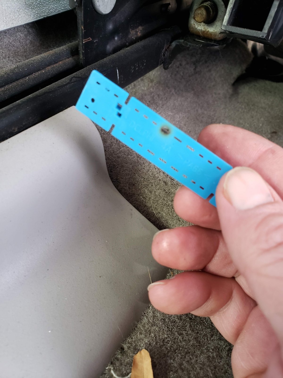

Now if I can only figure out why the power seats stopped working and the cooled seats and heated seats turn on but nothing happens ????? thank you in advance

Did you look at the fuse for the seats. The owners manual should have the location. I think they are located under the hood, left dash panel and right dash panel.
My friend, all the lights on the controls come on, but no heat and no cooled seats, so if controls are lit up I would assume power is on >????

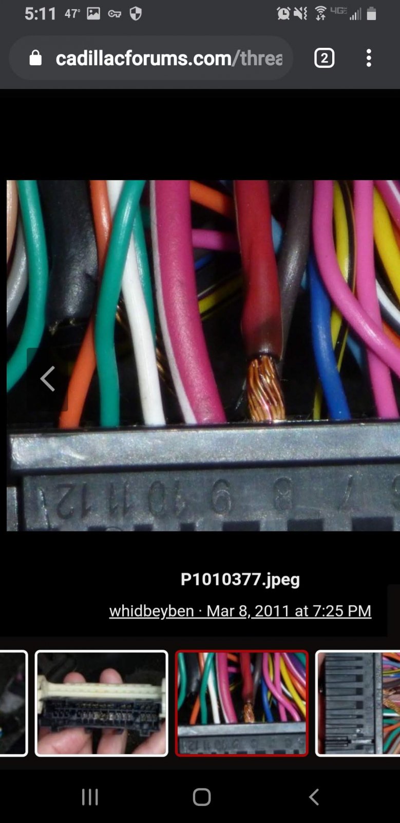

Did you check the memory control module under the seat or the ground on the B pillar?
