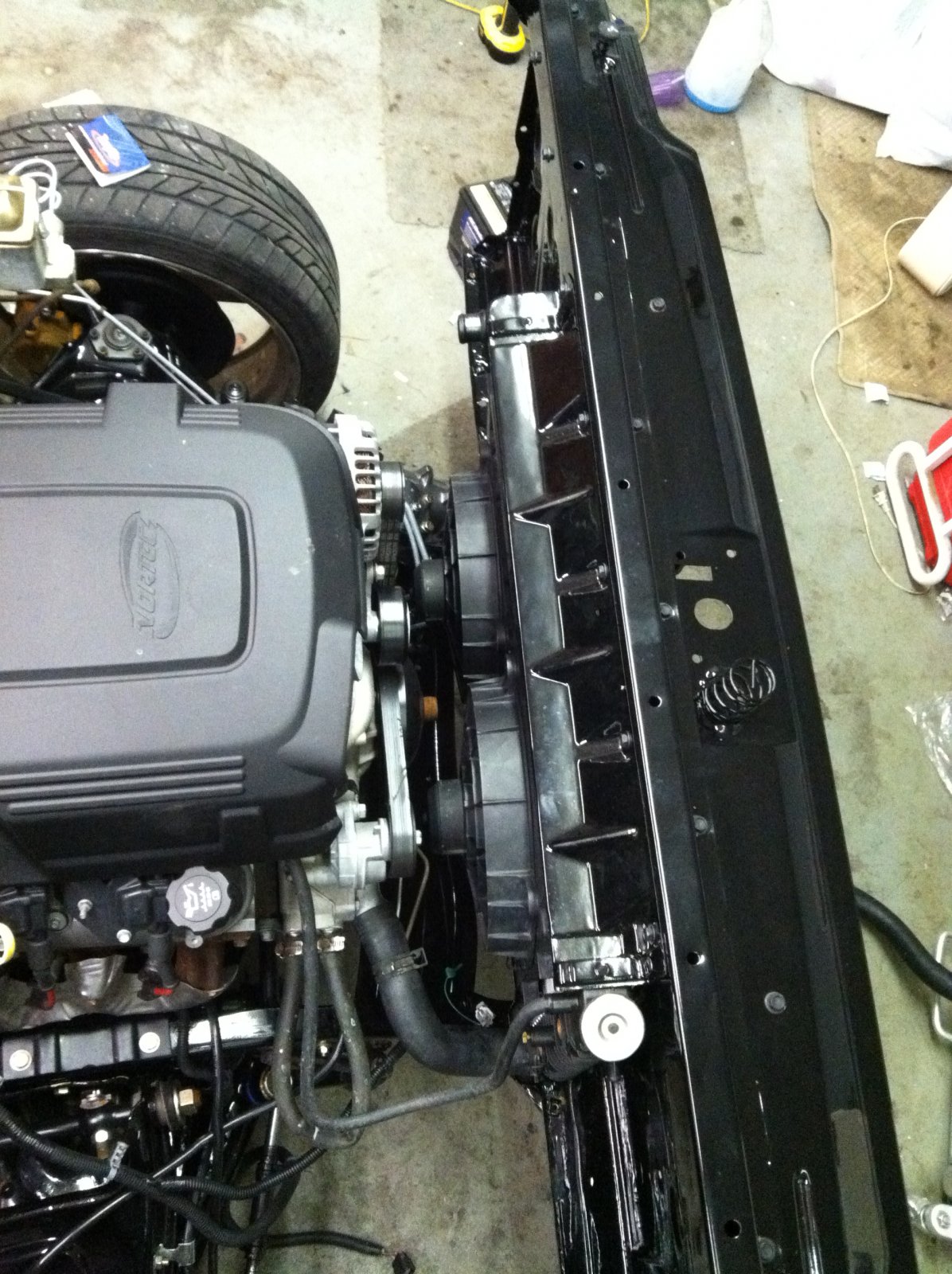

Aluminum radiator baffle thing, hopefully i don't hate it... lol
Not much left of the original, so i did my best to make a template from it. :gr_grin:
I found I had some push button center lock retainers that fit the holes perfectly.
So at least it will be easy to remove if it's annoying.
I used a screwdriver handle to make the little checker board looking lines.
stiffened it up by quite a bit.
I'm assuming it will make a terrible noise on the freeway, so i plan on using some rubber weather stripping on the ends.
:D

And i completed the radiator baffles
I decided to rock some gorilla tape to give it some thickness and prevent the sheet aluminum from damaging anything, flopping around, or making noise like a kazoo driving down the freeway.
:jester:
Doesn't show up well, but they are pretty black.
The other side is pretty seamless, i did my best to keep the ends of the tape on the inside of the engine bay.
thought is that they would be less likely to flake and come apart this way.
Incase anyone is looking, the little plastic holding clips appear to be 1/4in or 6.4mm per my little kit.
Kit: https://www.amazon.com/gp/product/B01IXXNP9S
I didn't get a good picture of it, but prior to blacking it they really stood out in the grille view.
I wasn't sure if i liked the look or not.
but now it blends right in.
