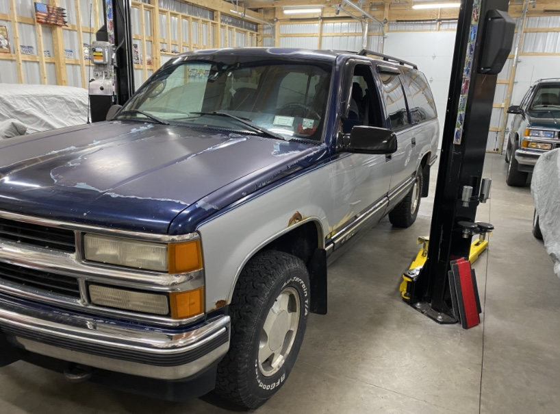

Just put the '96 Burb back on the road for the winter and...
Hoesgottaeat2
Dec 7, 2022
726
2,277
Western NY
Discovered I had a fuel leak upon the first fill-up. The same dreaded leak I had on a '98 Burb we had years ago. Right at the seam.
So I went shopping on the inner webs.
Yay, I found a new 42-gallon tank on RockAuto for $109!
But, they wanted $143 to ship it to me!
So I started my typical search for the best price.
Autozone - around $240, local pickup.
Advanced Auto - I couldn't seem to find one on their site.
Amazon - around $250(ish), free shipping.
Summit and CI were doing me no favors in price or shipping either, I felt.
AND THEN, OF ALL PLACES...
I found one on Walmart's site - $159, plus free shipping.
So I pulled the trigger.
I then proceeded to buy the pump lock ring, O-ring, tank straps, strap bolts on RockAuto.
I even broke down and bought the fuel line removal tool. No more using a small screwdriver the hard way LOL!
25,995
38,779

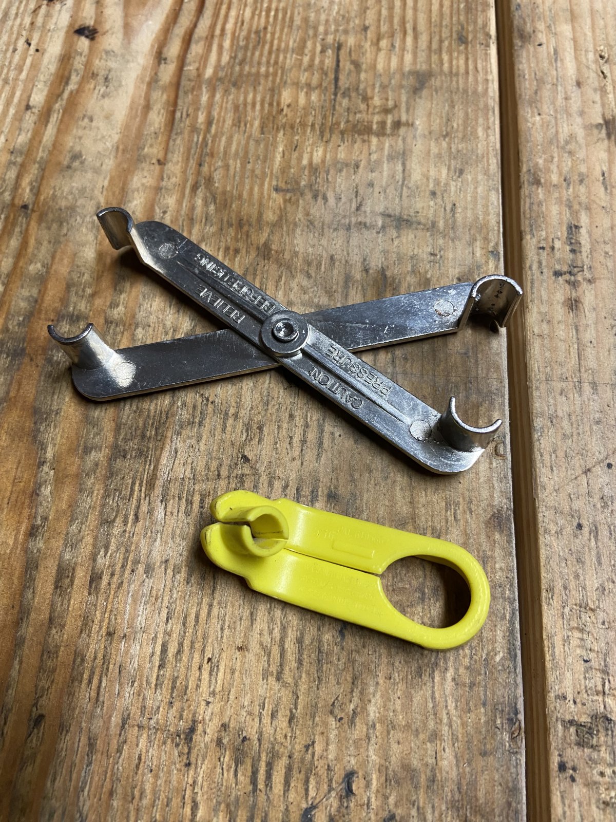

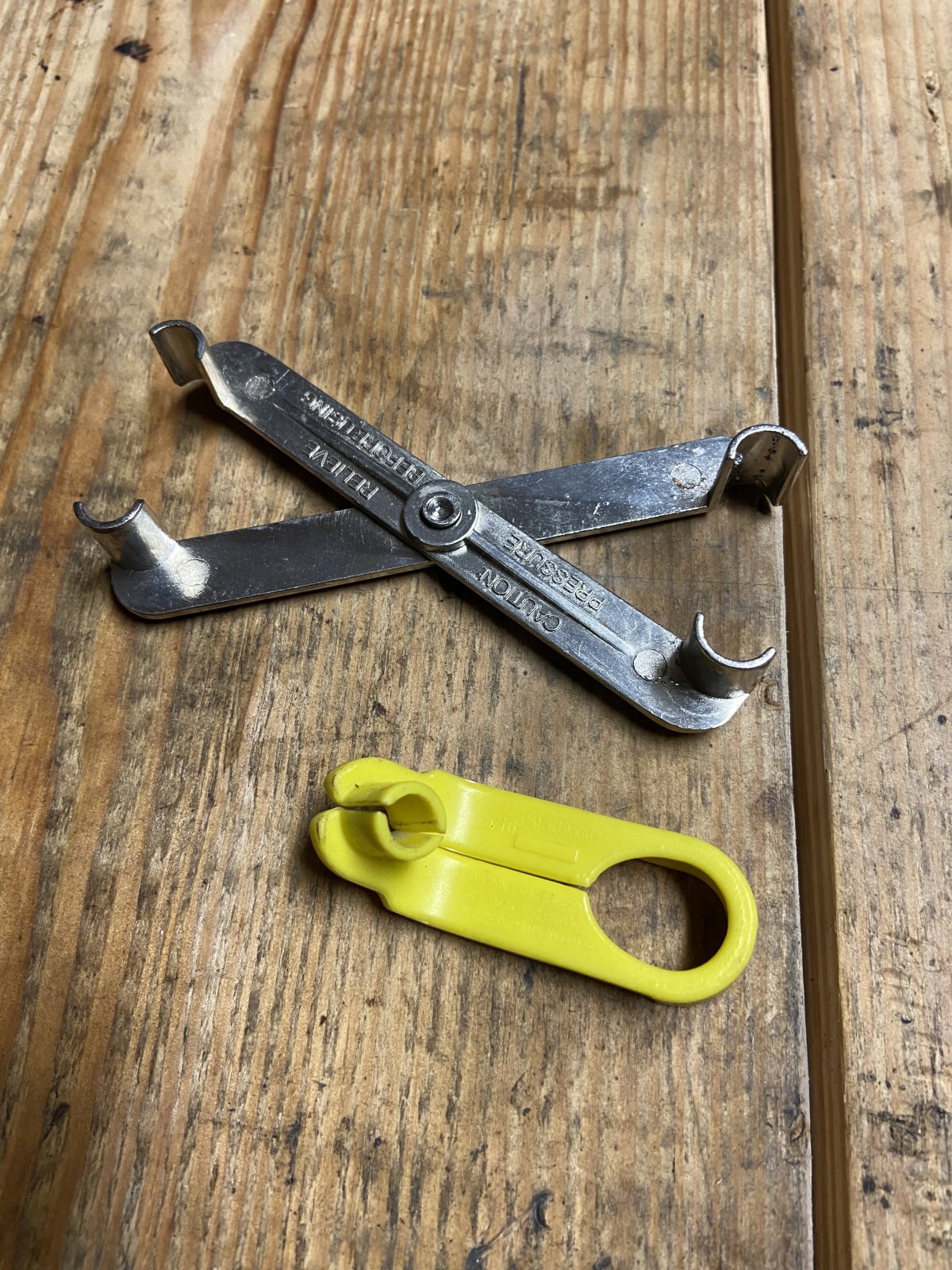

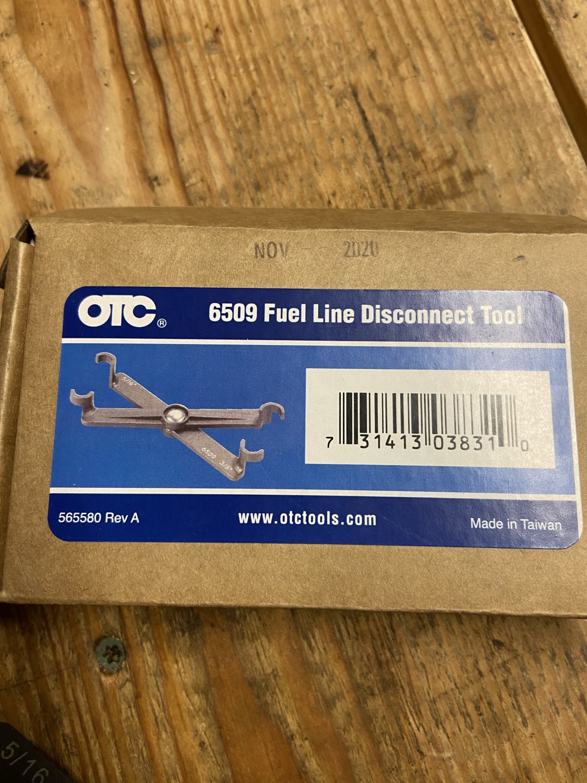

In case you haven’t seen them, this OTC 6509 worked pretty well on my 98. The end is narrower and gives you better clearance to get the lines off.
These two styles made me cuss and want to resort to violence…

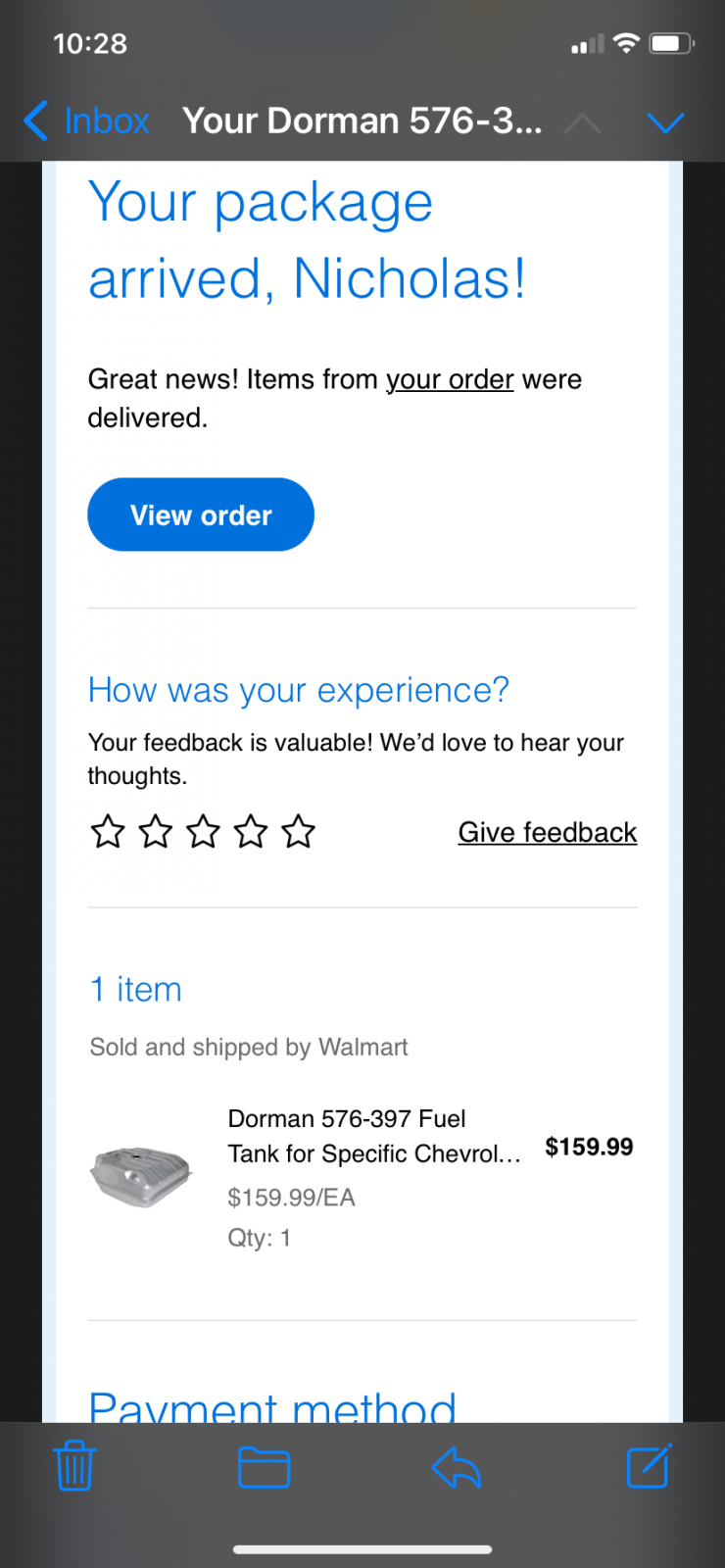

Good news just arrived in my inbox…
