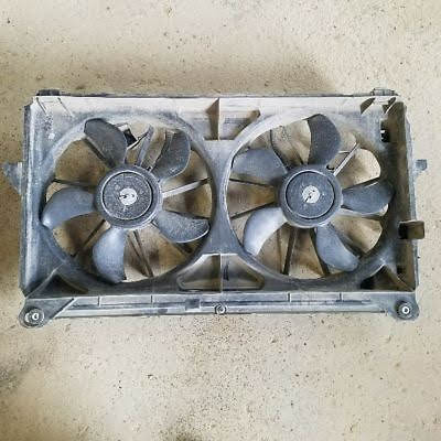

So for future reference I just measured the cfm of the 700w 7/9 rimmed blade (k5l) fans both sides measured approx 2300 cfm on high, measured inside the engine compartment right up against the fan, can anyone measure the dual 5 blade non rimmed 700w? You just need a anemometer
I wish I had something to measure CFM , because I have the 2011 and up K5L 5 blade rimless 700w fans in my 09 tahoe, and I have the 7/9 rimmed 700w on my 06 Sierra Denali. The fans from the 2011 are much louder and feel like they suck more air in compared to the 06 7/9 setup but they are much quieter.

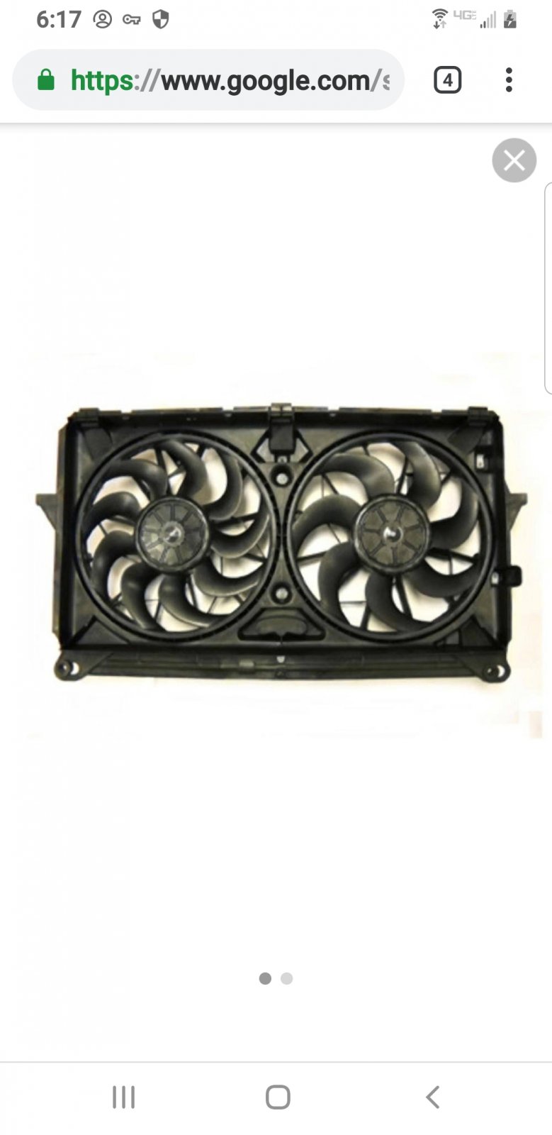

So now that we are talking FANS....
I installed the TYC 622210 fans last spring. They are the 7/9 blade listed for "performance cooling".
My fan set up was a 7/7 blade assembly.. Not sure if it was the OEM setup... as I bought used.
Is there any way of knowing what the wattage is on these??? I do have the the HD cooling, towing,
etc options on my XL 6.2 denali.
I can't find specs on the TYC as far as wattage

you would probably have to contact tyc they must have it in there technical data somewhere
