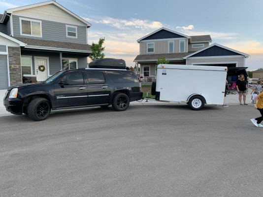

I've towed a lightly loaded, single-axle 5x10 cargo trailer across Kansas from Virginia to CO and back twice - once in May and once in July. The OAT driving westbound in July was 102ºF in a hot spell and the engine and transmission were both getting warm. For our trip to Yellowstone this August, I want my cooling system upgraded and fully sorted before we set out, so that's why I'm doing this work now while I still have time to experiment.

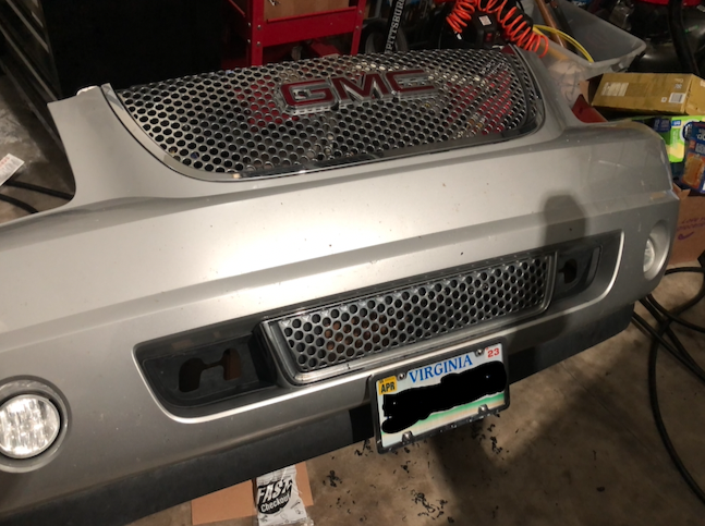

My next steps are to get as much ram air into the Derale as I can, and monitor on some longer trips we have coming up.
