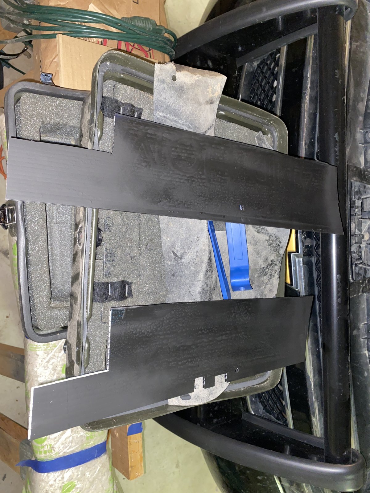

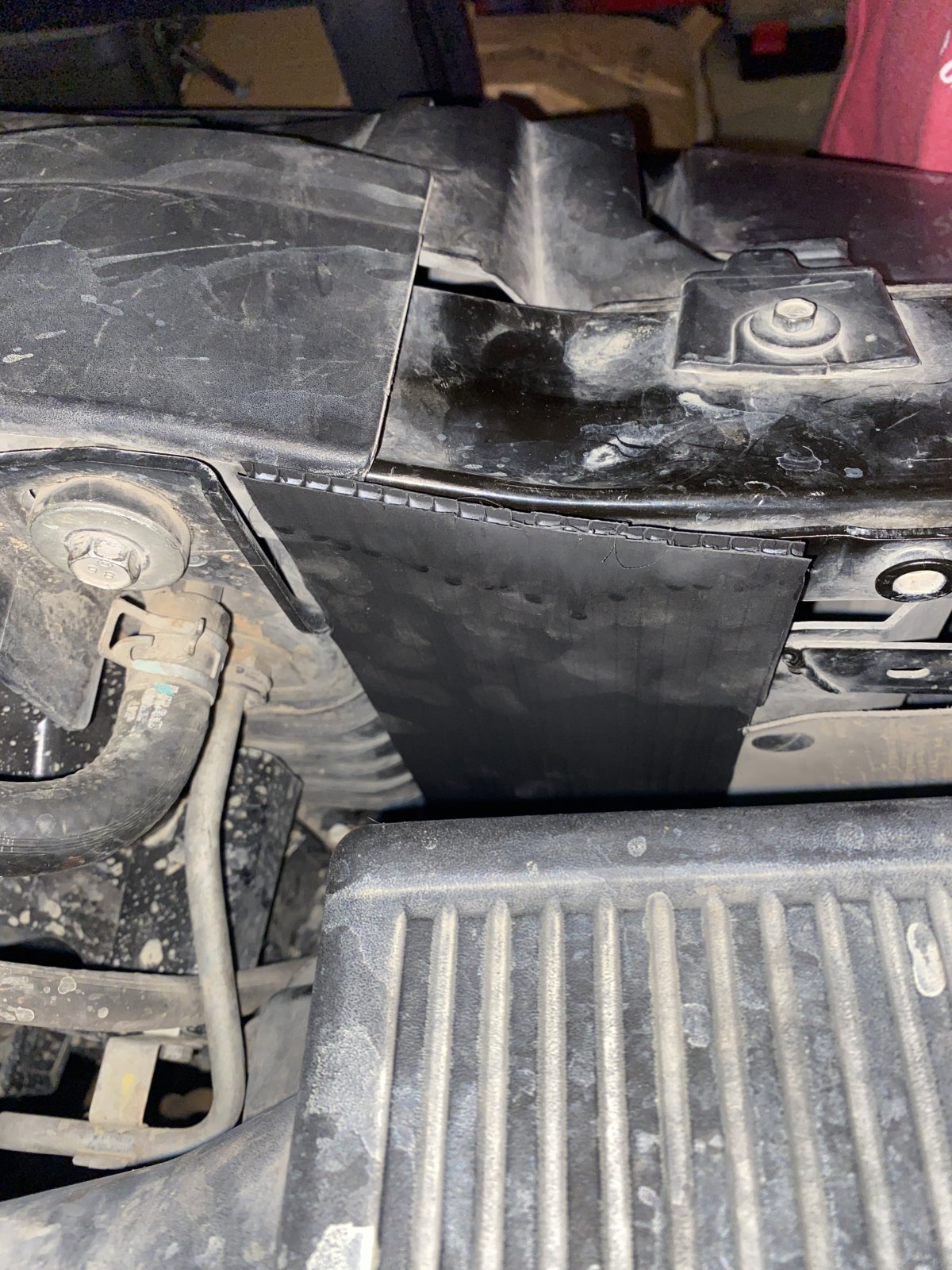

So it wasn’t, but I popped out the grille and cut the plastic backing out and then cut out the same area on the bumper. I knew the Denali’s lower grille would allow for airflow if I did that after doing some looking. The big trip starts in the 9th so I’ll let you know how it does! Right now I have constant 12v to the thermostat so I think I’m gunna run a wire for a switch inside so that way I can kill the fan if it’s still running after we stop and I shut the vehicle off.
Shouldn't need to worry about it. The longest mine has ever run after shutdown is about 60 seconds.
