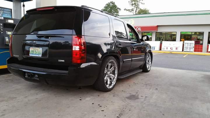

Haven't done the front yet haven't fully committed. I not sure I can make this just a summer vehicle as I live in the great white north lol yeah I'm defiantly going to do the aero sport bags after seeing them installed. The rear is super simple and with all the stuff I bought the rear is nice and solid. I cant imagine the front being that hard with the bag over strut as long as you are running belltech lowering shocks in the front
---------- Post added at 07:45 PM ---------- Previous post was at 07:43 PM ----------
I personally like the looks of the autopilot with how you can automatically set ride height as opposed to relying on psi numbers. I was thinking of maybe doing manual valves for now lol
---------- Post added at 08:08 PM ---------- Previous post was at 07:45 PM ----------
33" front
32 1/2" rear (lowest I would drive at can go lower no sitting on bump stops)
Tires: 305 35 r 24
Front is 2" drop spindle and belltech adjustable strut at 1" lowered
Rear is tbss air spring spohn pan hard djm rear hardware and free travel mod which is a must. 5/32 air line off the tbss bags to 1/4 adaptor to 1/4 schrader valve for now relying on gas station for air
Ride is a lot better then my old broken autoride lol would imagine the air springs make for better ride then lower spring

Very impressed with the rear tb air bag idea.. Tony you made an awesome discovery with these. With everything installed the back end is super tight and looks like there would be no other way to go this low with the djm rear kit free travel mod and the spohn pan hard
ive done a lot of them. Also replaced the kieldermans or howevver you spell it set up. ALso the tbss bags tow more and tons more lift.
Just a few things on the rear. If you want to get it even lower you can do 3/8 tall energy suspension bumpstops BUTTTTTTTTTT make sure your tires dont get cut up by the fenderlip so before you do that remove the rear bumpstops completely and air it out. The frame will rest on axle and the tire will tuck. That being said if it does hit you can cut the aftermarket bumpstosp down so that the truck will get to the lowest position it can get before tire touches fenderlip.
If you have any other questions just ask.

ps do the upper/lower spohn arms this will push the rear axle back to make the rear tires not looked sucked forward in the well.
