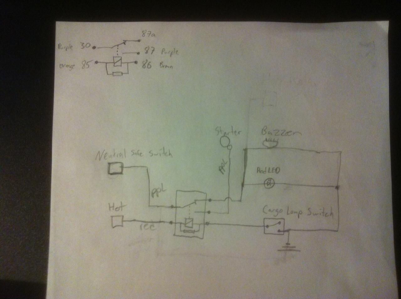

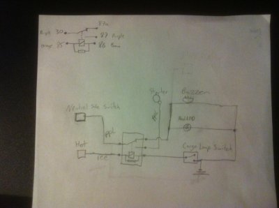

Nice. Instructions make it sound easy. I'm used to messing rc cars so!!! I do have one ? Do I run the jumper wire from terminal 30 to 85 or 86?
85, I fixed my post. That was a typo. 86 should be the ground wire from your switch, 85 should be jumpered to 30, the key side of the starter wire.

Best way to do it if you dont already have an alarm is with a relay and a switch. Cut the starter wire and wire it to a relay and also wire the positive horn wire (under the hood) to the relay. When you flip the kill switch on to engergize the relay, the relay will then reroute the voltage to the horn wire when the starter wire is energized. So if somebody tries to start it with the kill switch on, it will not only not start, but it will honk the horn each time he tries to start !! This can all be done for under 20 bucks in parts.
