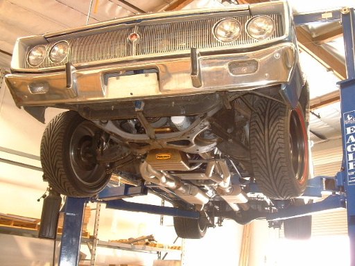

Nick... For a year, I was honored to work for the famed, Art Carr " Performance Transmissions ", in Huntington Beach, Ca.
I R&R'd trannys & installed coolers. I knew nothing about transmissions, but being around his artists, was quite an experience.
He built me a transmission & converter for my '88 GMC truck ( could handle 650 HP / 700R4 ) .. Since, my transmission failed 6 times before I met him..... He is famous for his STOUT, 2004R builds.
