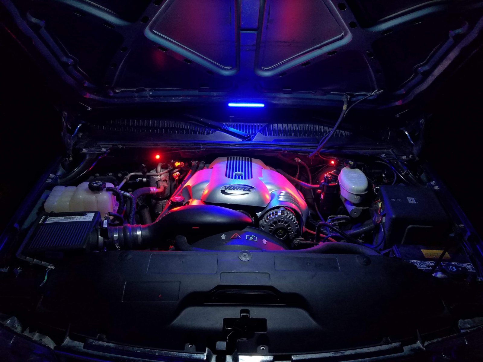

Well was on the way home and truck started over heating got home and water was pouring out from behind the water pump, it was toasted, So this weekend was work on the truck to fix it so trip to autozone later I had New water pump, and some YouTube videos from 1A auto, and watched a couple others. I got the pump changed, coolant flushed, holding temp no leaks. Been looking at alts for the truck, thinking about mechman 320amp for system. got it washed up aswell

Didnt get alot done today but I did get my second battery tray for under the hood and some stuff for my big 3 upgrade. Mounted up the New bracket/battery tray, spent more time messing with coolant overflow container than getting mount flipped
pulled old one out
This is new one I mounted
Now I gotta get another agm for under the hood and order some more 1/0 wire so i can get it wired up. Talked to my stereo buddy trying to find a weekend to get down there so we can rebuild the amp rack and sub box. Need to get more sound deadner in the truck but being lazy waiting on color matched handles so I can do it all at once.
For anyone who would like to know, In order to add the battery tray. You will need ,The second battery tray out of a 2500 with second battery option, doorman Battery Tie-down and Bolt
1. GM 15246518
2. GM 11509853 (Bolt for Battery Tie-Down)
3. Dorman 00587 Battery Hold-Down Kit
Also note all that is need for install is a 10mm socket, 13mm deep well, and a 3 and 6 inch extension was all that was needed to flip tray over the bolt at front mount of your coolant overflow must be removed, both extensions were used to reach down in between air box overflow, so i could slide it out of the way to install new battery tray.
