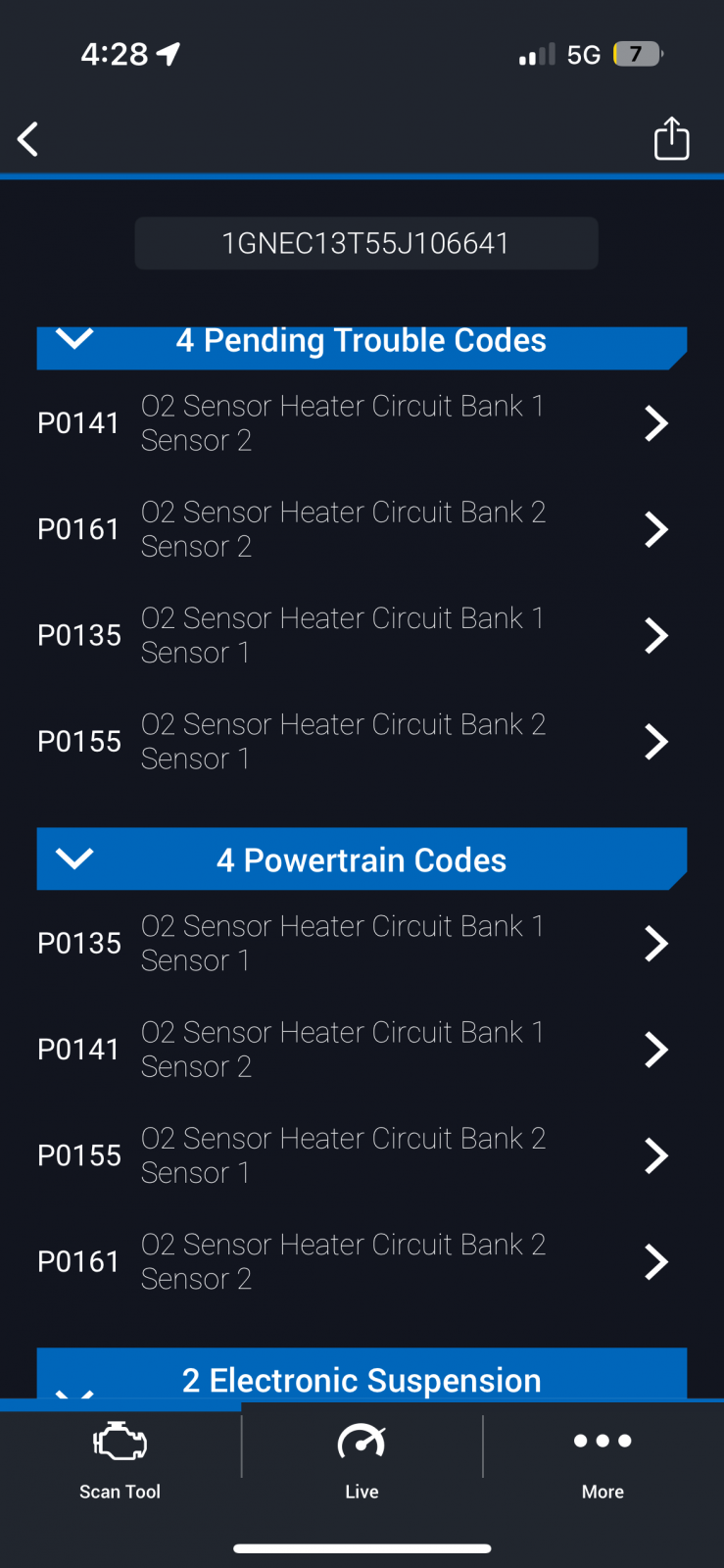

Have a massive drop in mpg
Smoke from exhaust on start up
Goes away after you start to drive
Rough idle at start up stops after so long rough idle starts back when you go to park
Replaced 02 sensors 2/3 times before doing a cat delete cats were bad
Gas problem was before cats got deleted
Replaced fuel injectors
Coil packs
Spark plugs and wires
Long term fuel trim reading 25
Short term fuel trim reading 55
Any insight on what might be the problem

Everything but fuel injectors 2/3 fuel injectors were slightly black on the bottom thought that was the problem helped some but not allot

You should see if your app can be changed to read g/s, but if my conversion is correct the MAF appears to be a problem:
The MAF value -- in g/sec -- at hot idle should be close to what your engine displacement is. I assume that's a 5.3L engine, but the ECU thinks it's a 21L engine (!) based on the MAF, so that would 'need' more fuel.
Unplug the MAF for a test to see if it runs any better without it.
So I'd recommend to replace that MAF with a GM OE one, or a known good one, to see if the issue is alleviated. Re-read the MAF reporting value after that.
Hope you saved your OE injectors; they're probably much better than something bought online (if that's what happened).

Backing up a bit, was the freeze frame data at idle? If not, we need to see what the MAF is reporting at hot idle.
