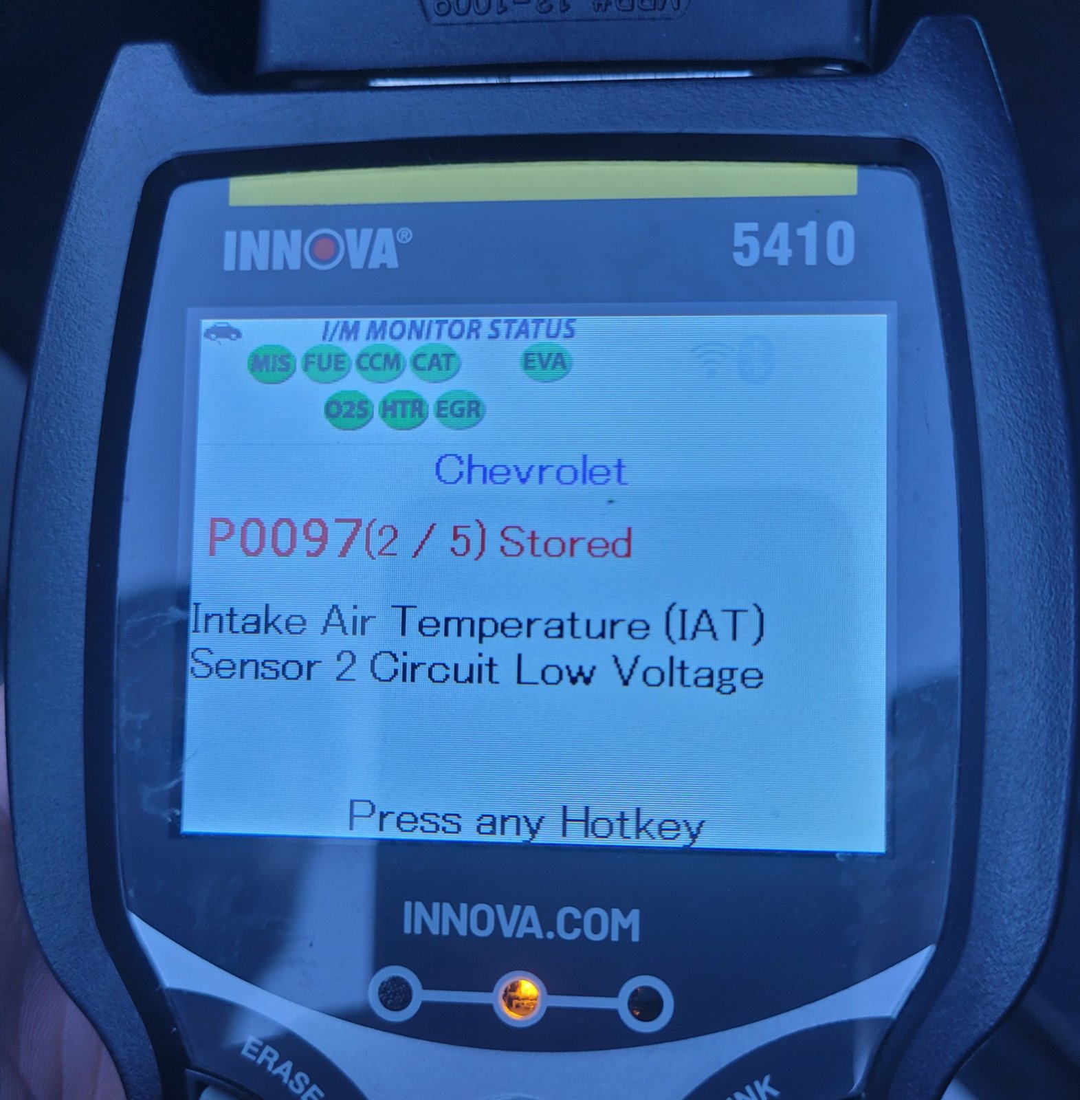

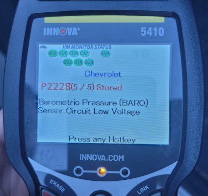

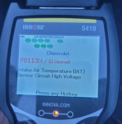

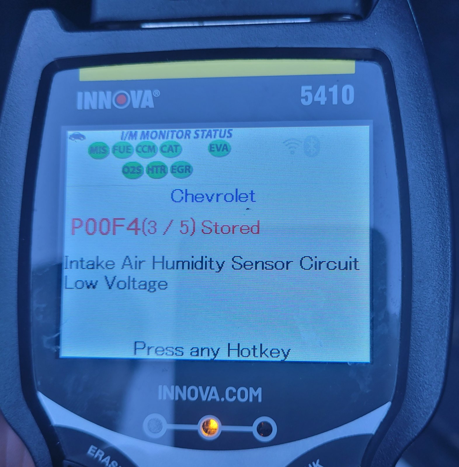

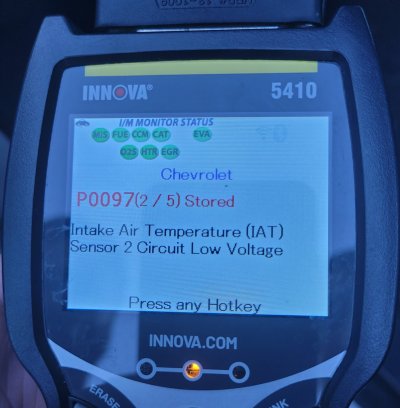

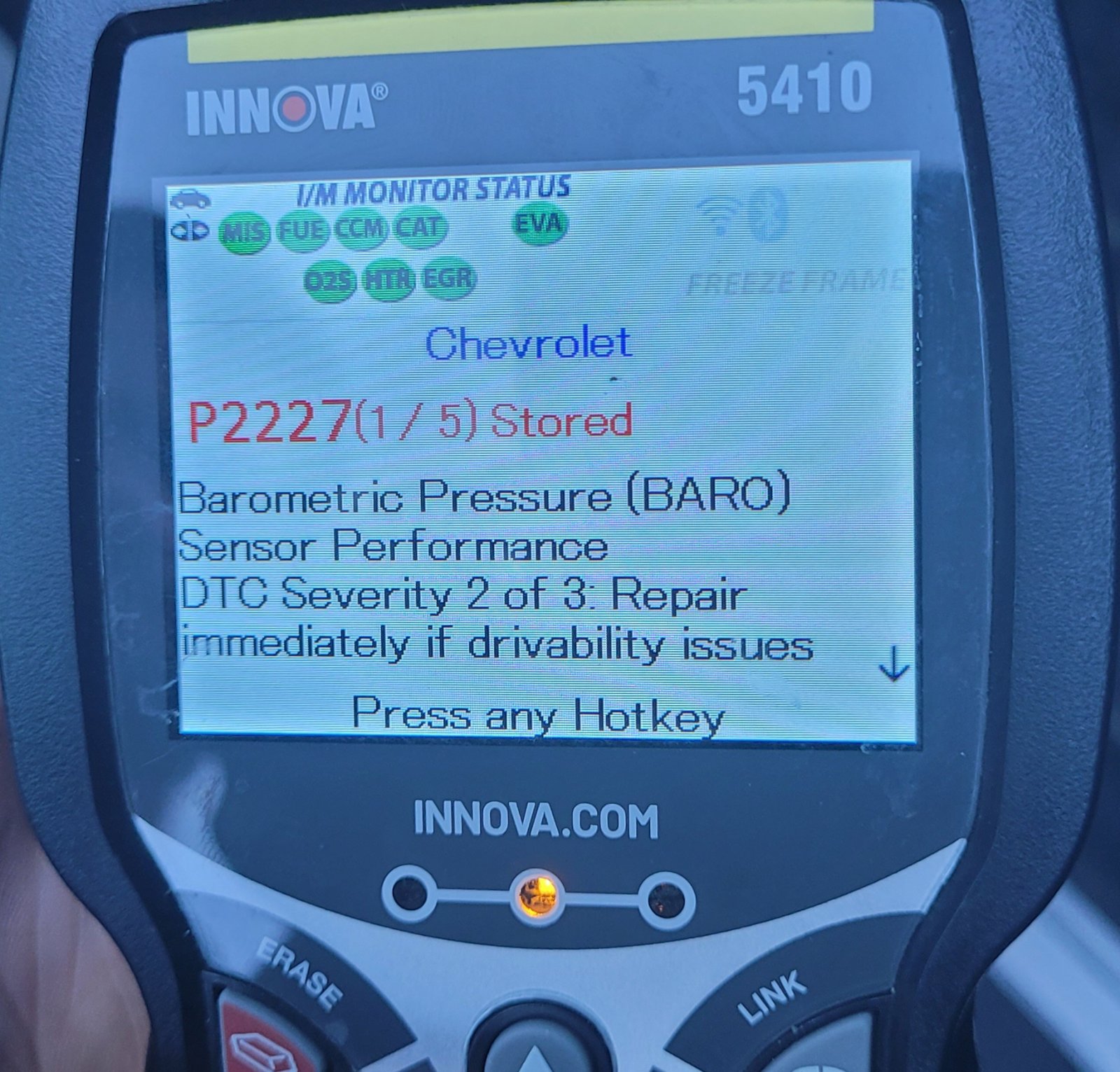

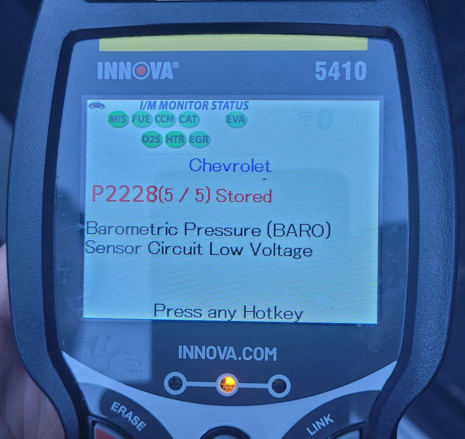

I wanted to get a set of LED headlights for my Tahoe but I’ve heard so many stories about them throwing Check Engine lights. Anyone have any success with a particular brand that didn’t cause a check engine light?
I just installed some Sealight H11s and my check engine light is on... Now to figure out the issue. :(
Jroby42
Jun 24, 2021
26
25
Check that connection (MAF) on the passenger side air tube is tight/connected and air box is nice and tight.
Hattie2879
Apr 17, 2018
54
58
It's raining pretty good right now, so I'll probably swing by auto zone or advance auto tomorrow to see if they can tell me. I did double check to ensure that the MAF and air box are both tight. Hopefully it's just being funky bc I disconnected it.
