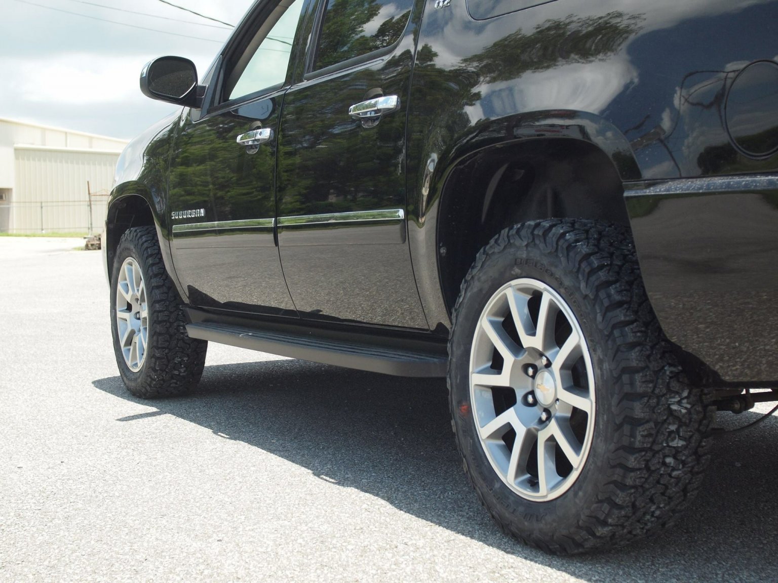

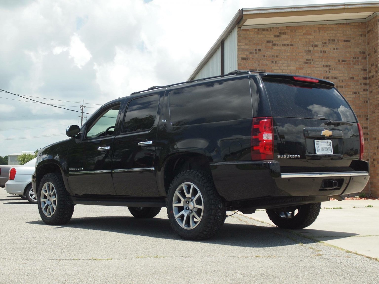

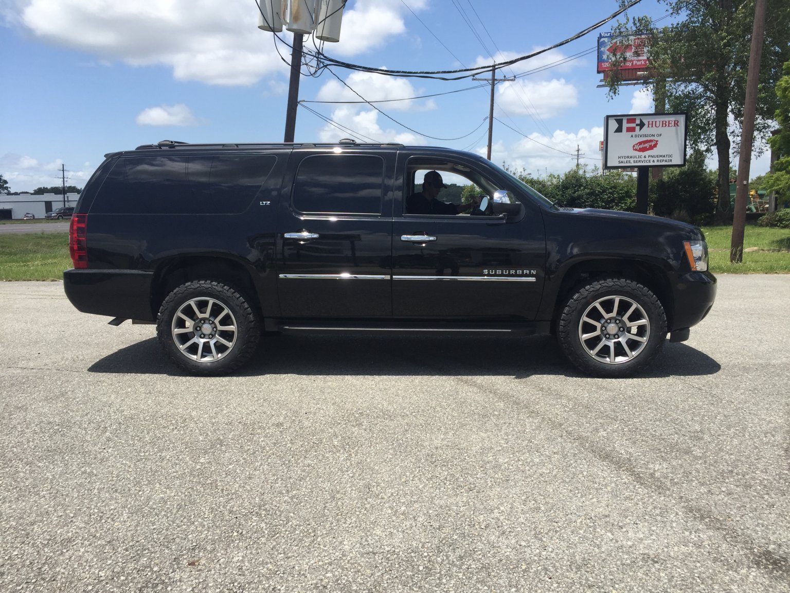

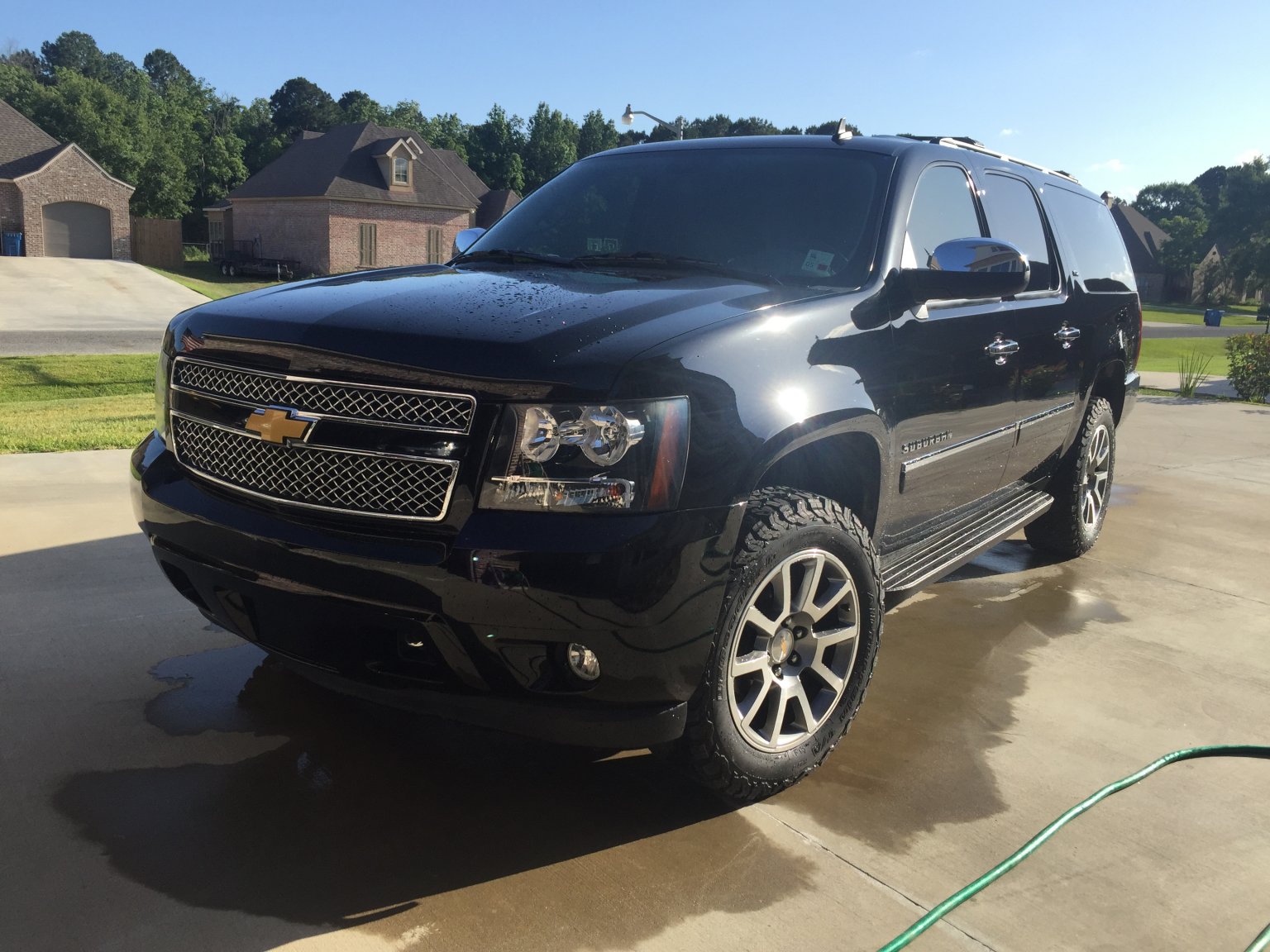

Just got the 3/1.5 leveling put on last week. And put the 17x9 -12 fuel hostages on the same day. With streeties 265/70-17. Need to put some 33s on and tint. Kinda debating on a 2" BL or a 3" spindle. Not sure yet

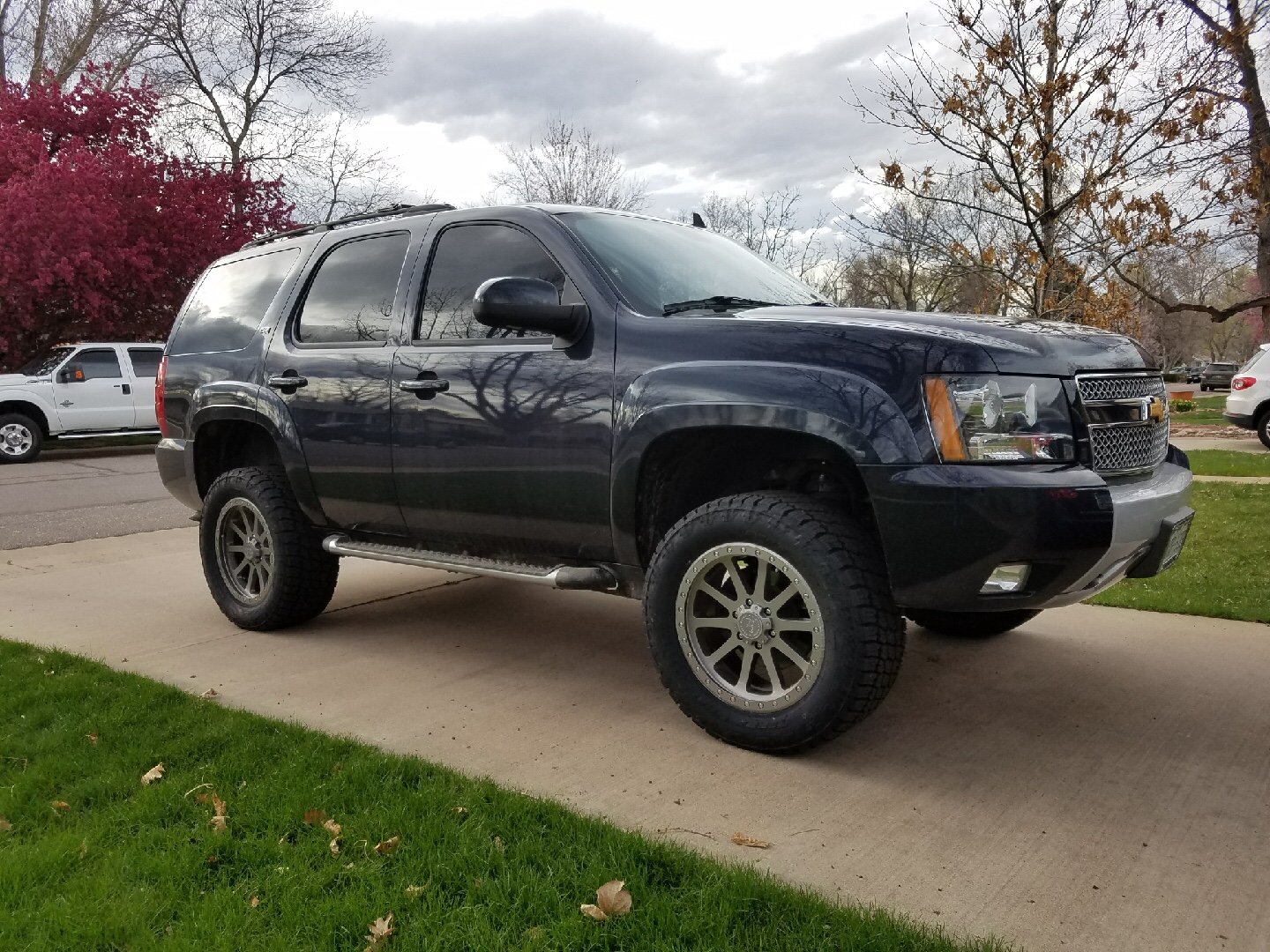

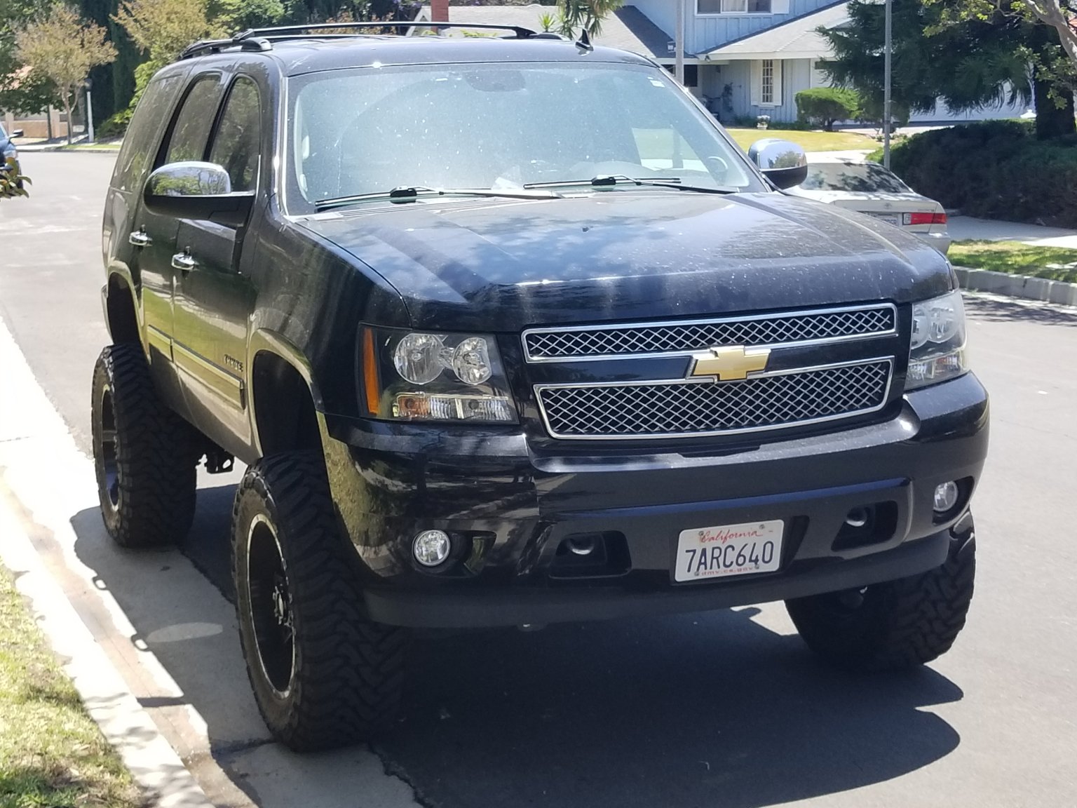

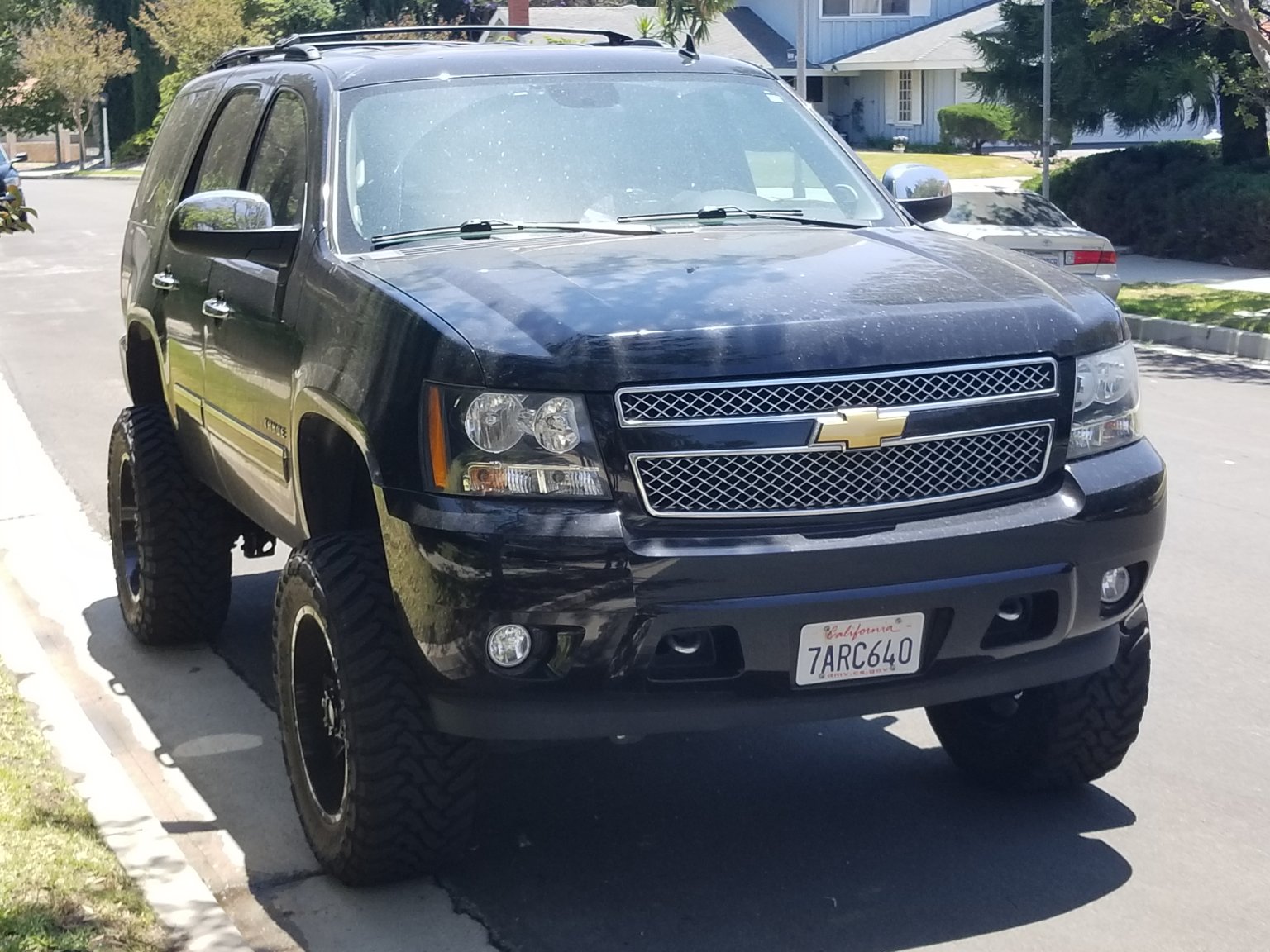

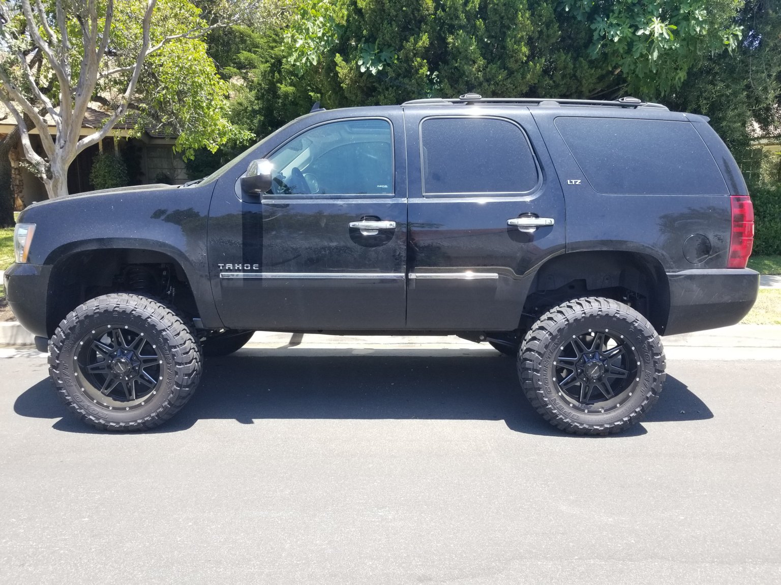

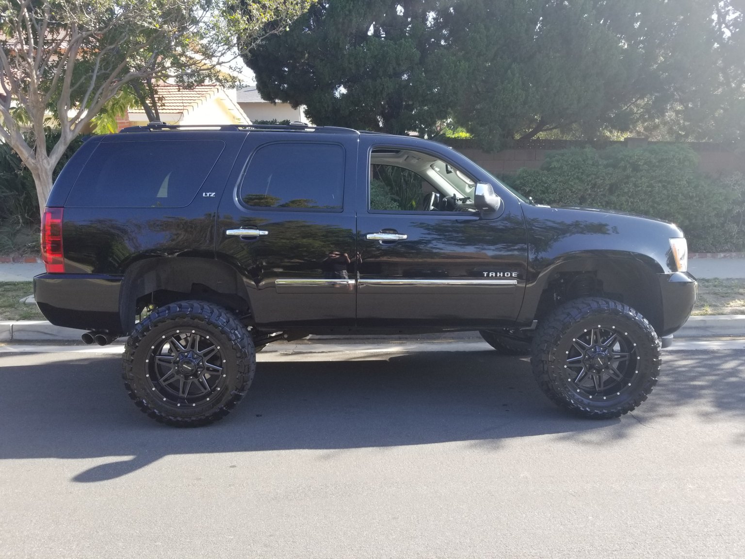

You can do both!! I have, a 3 inch body lift, 3 inch spindles, 4 inch suspension lift kit and 5100 struts. Ground to fender height is 46" front and rear.

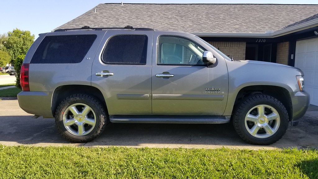

Those duratracs are awesome and look great! Good work
Thank you! I got an amazing deal on the set i couldn't pass up.
I really need to get the rear 1" on. It rubs pretty bad on the rear liners in and out of driveways. The fronts don't rub the liners at all but I was really surprised to get some sway bar rub at full lock. I don't know why that's happening with 275's.

It's the big sidewall lugs which make the tire wider even though the tread width is 275. Should be easy to drop in a 1" spacer to level and help clear the rear liner.

That makes sense. Hopefully it will clear up with the rear spacer. Is there no fix for rubbing the swaybar?

You could probably get a front and rear 3/16" wheel spacer and that would help clear the sway bar and rear liner. They will fit in between wheel and brake rotor sliding on the studs. You have enough stud threads to run these spacers.

I ran 1/4 spacers just fine. Plenty of lug. Wasn't quite enough to clear the 305s from the sway bar though, I would suggest hubcentric spacers though for safety.
