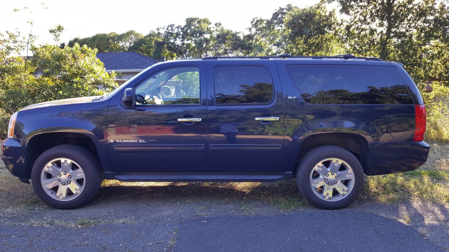

The after pick at the top of this thread was after the 5100's front and rear, but before the new rear coils. I discovered the broken rear coil when installing the rear spacers of the CCM kit. This pic is with the new moog coils.
10-4, thanks brother. Truck looks real good btw.
