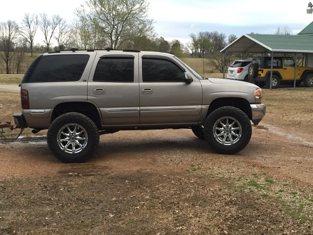

Looks like a lot more than a 3" lift if you are truly measuring in the 42" area. As I have a 6" and I am 43.5" now that was with half worn tired but still.
I am confused as to what lifts you actualy used as Superlift only makes a 6" full SUSpention and a 2.5" key set for this model. So what 3" kit exactly are you running.
The Cognito upper control arms add zero lift they only provide a better upper ball joint angle to go in combination with a lift.
As far as the rear springs. Did you simply call rough country and buy only the rear springs for a 6" lift? As to my knowledge they do not sell any "kit" for just the rear.
I am not trying to call you out by any means. Simply trying to dial in a more detailed account of the exact parts and total lift you have for future viewers to understand if they desire the same height.
Also it should be said that up front you have a 5.5-6" lift. Little things like this will help people in the future. Bc if someone sees your comment about 3" and thinks "sweet! I can be that big with a 3" lift yay" and in reality NO"
Also post current pictured tire size.
Thanks.
Looking good and will look even better with more meat under her.
So 33.8x12 ill re measure when my new 35s go on next month.
But yea mix match.
What did you pay for the springs themselves?
