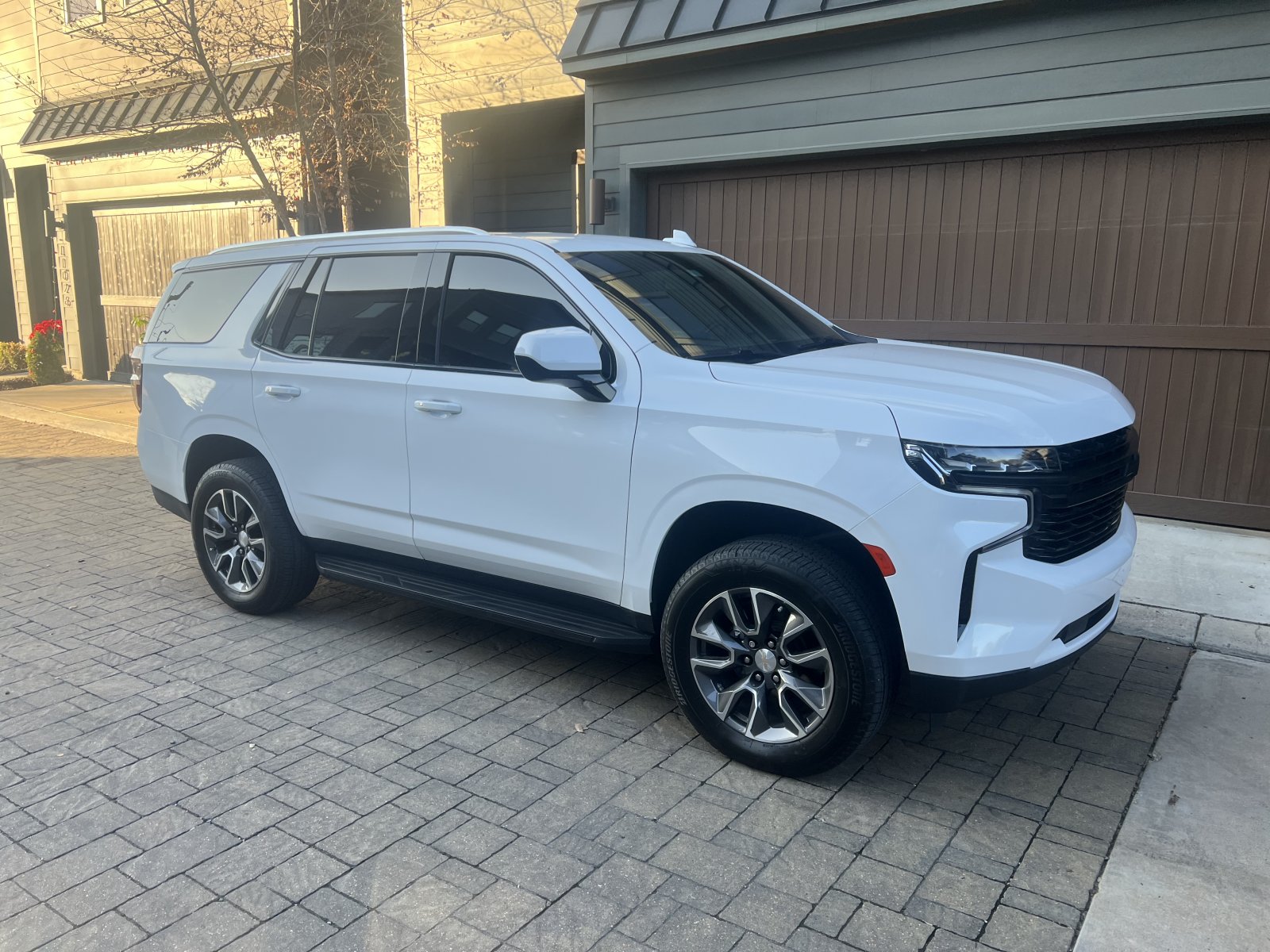

Well here it is. 2” rough country up front only with 33s and Amp steps. Honestly kinda wish I’d have put a larger tire on it and or went with a 3.5” kit. We will see how long this last. We came from a 21 Duramax Denali on 37s. So this thing feels small.

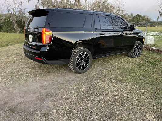

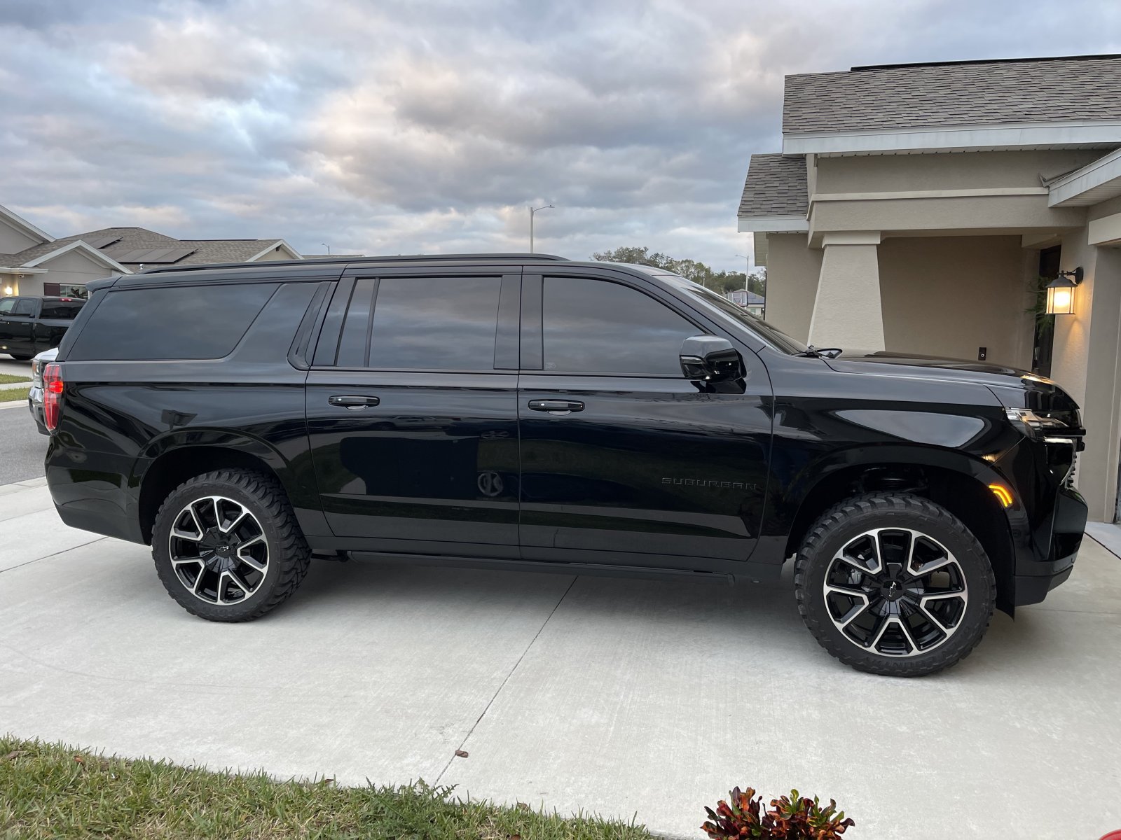

So I did the thing, went with 2.5 and 35x12.5x20 on 0mm… definitely gonna need some trimming and have to go back to get rear leveled out but i got called into work and had to schedule another day the border has slim pickings on tires.. and everything lol.

2” or 2.5” kit? The link says 2”. Also what are the brand/model tires?

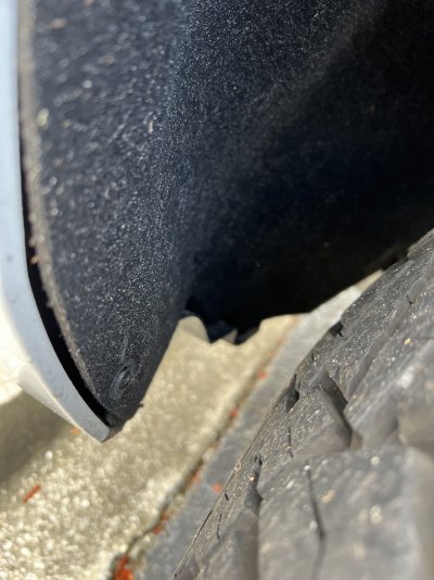

It’s a 2.5 inch I dunno why it tried to link anything, but the tires are mileking something I didn’t want them but that’s all they had. I myself prefer cooper. I do have a question I see where the rubbing is it’s toward the inside in the rear, what’s the best way to trim this or move the liner back? It’s not too bad but it’s there and it’s bothering me lol.

On mine, they zip tied the felt back. Not sure if they removed anything behind it to allow.

I removed these brackets, they were right behind the felt and causing the rub. Their shape and beefiness made them tough to trim in any way, and they protrude a lot. Don’t see any way around them for those that have them and have a decent amount of rub.
