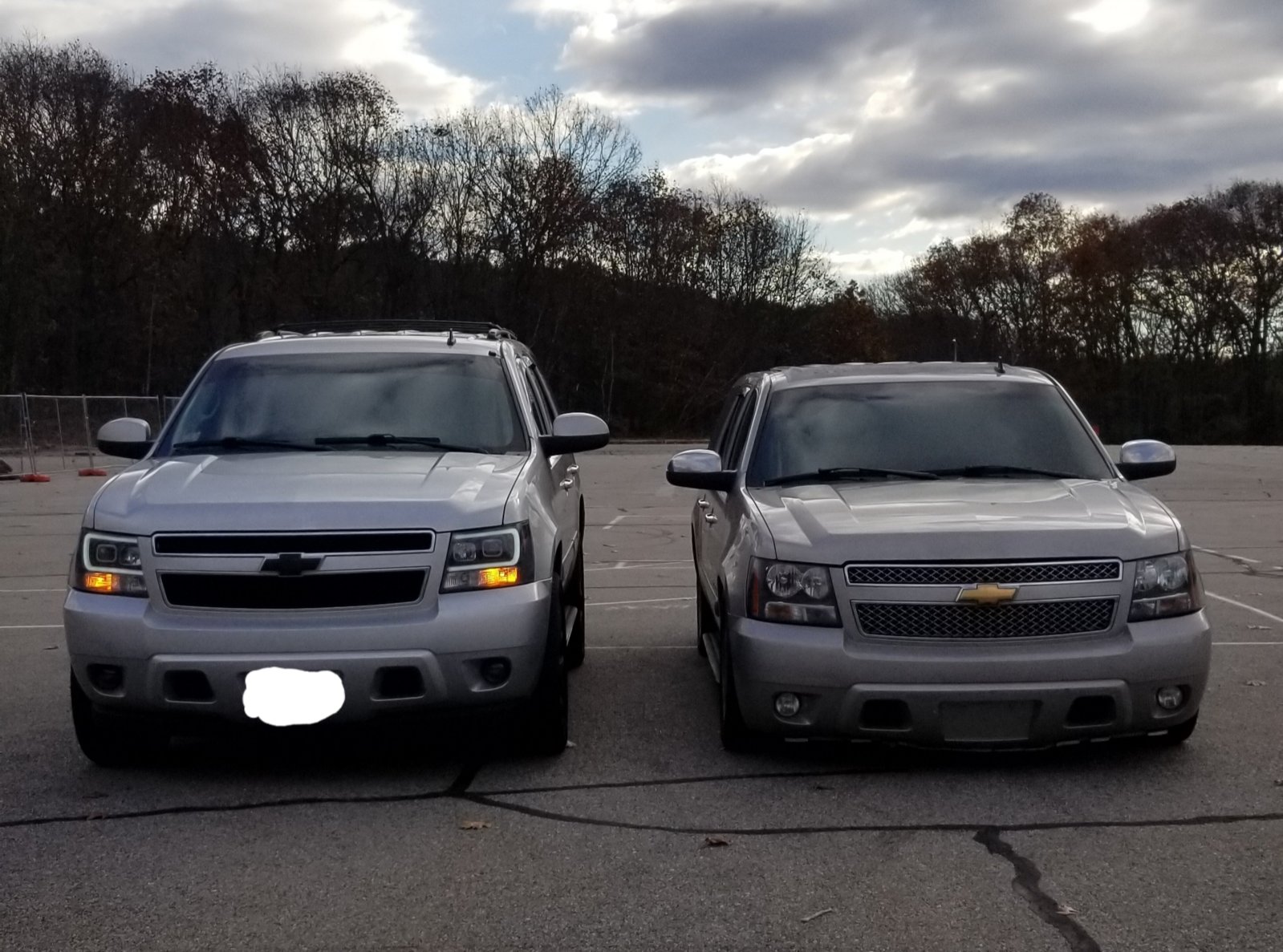

It’s 4/6 but it’s closer to 5/6. I’m having issues with the panhard bracket on the rear end hitting the frame and also with the front lower control arms hitting the frame. The new bumpstops in the rear were destroyed after the first 15 minutes trip home.
I had the same problem with the panhard bar hitting. I trimmed the bracket on the axle slightly and notched the crossmember for added clearance.
rps20180824_112822.jpg rps20180824_112907_863.jpg rps20180824_112947_533.jpg
You are running spindles and adjustable struts up front with no spacers I assume???
Same here but I don't have any clearance issues with the lower control arms... at least none that I am aware of... I will have to take a closer look the next time a wheel is off.
I know your running smaller tires so you are going to be slightly lower than me but overall once I notched the rear for the panhard bar she rides pretty good.

That last picture was exactly what I needed to see. I was going to do the same and box it back in but I assume you didn’t and haven’t had problems?
I just took some measurements and the drop is actually 6/6 after accounting for tire size difference. 28-7/8” front 31” rear
The tire is 1” shorter overall so that’s only equal to 1/2” drop

No problems... and no more knocking/banging from the rear.
