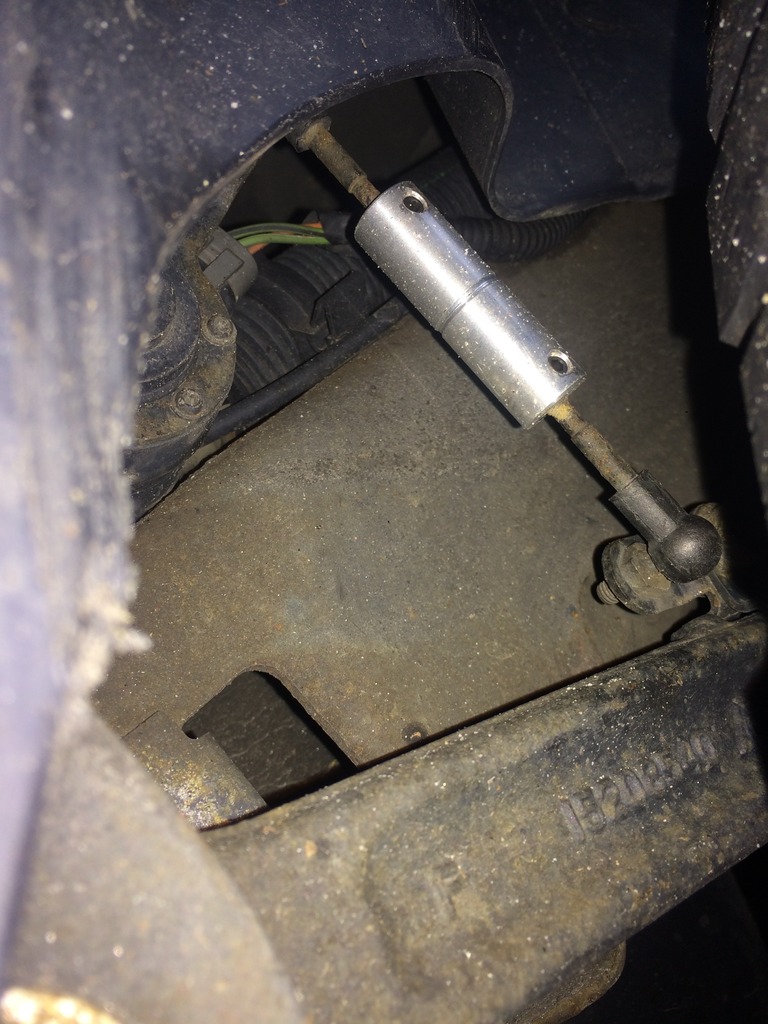

Did you turn the shocks or buy extensions for the top and bottom?
