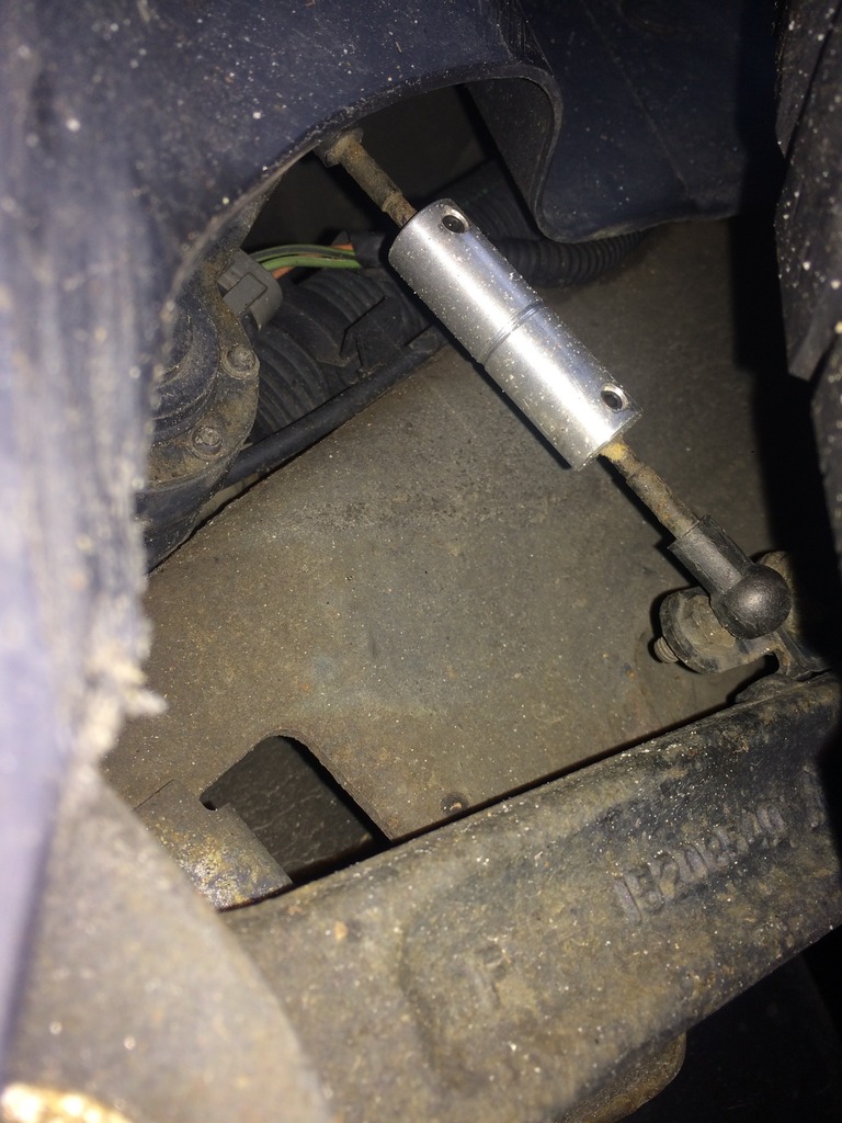

You can lift the rear and anything over stock height will mess up the ride height rods. When lifting it will cause the system to not activate to keep level under load. Any height over normal range will give "service suspension" message on dash. You have to get ride height rod extensions to correct the issue. I got 7" lift on my Denali with auto ride so ask me how I know to do it right

Yup it will work with or without a spacer just need to lengthen rod when adding a spacer.

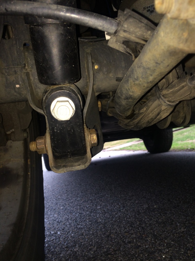

I have a 2" spacer lift on my 07 burb. I replaced the original suspension front and rear with replacement kits for Arnott using their non-electric front shocks with plugs to disengage the front magneride and their direct rear replacement shocks and air compressor. I also went up 2 sizes in tires to 275/65/R20s. Because of this, my burb sits about 3.5-4" taller than stock. When towing my boat @ 4k lbs, my burb squatted quite a bit, the 4" back down to stock. I just ordered the shock bracket extensions for the rear and the ride height extensions. I talked to Mark @ Full Throttle suspensions and he said this combo will eliminate the sagging on my burb while towing and the system will work properly again.
I should have the parts next week and when I do the install i will take some pictures and post them up.

Yup the extensions will set the ride height rods at the stock height so the rear performs as designed. Do you have any shock extensions on the rear with those 2" coil spacers?

Yes, the front shocks are regular passive gas shocks. The module Arnott tricks the computer system that everything is ok. The 2" spacer goes on top of the coil over so the shock is still stock length. The rear shocks are not coil overs so the shocks are extended too much. Because of that, I needed the shock extender @ 2" and the ride height sensor extensions, probably set them @ 1.5-2".
With the 2" lift and going up to 33" tires, my burb sits about 3.5-4" higher than stock but I still have the .5" rake back to front, mainly for level towing. Hind sight I should have just deleted the damn airride but I loved it when towing. The OEM system is just such a pain in the ass when it craps out.
