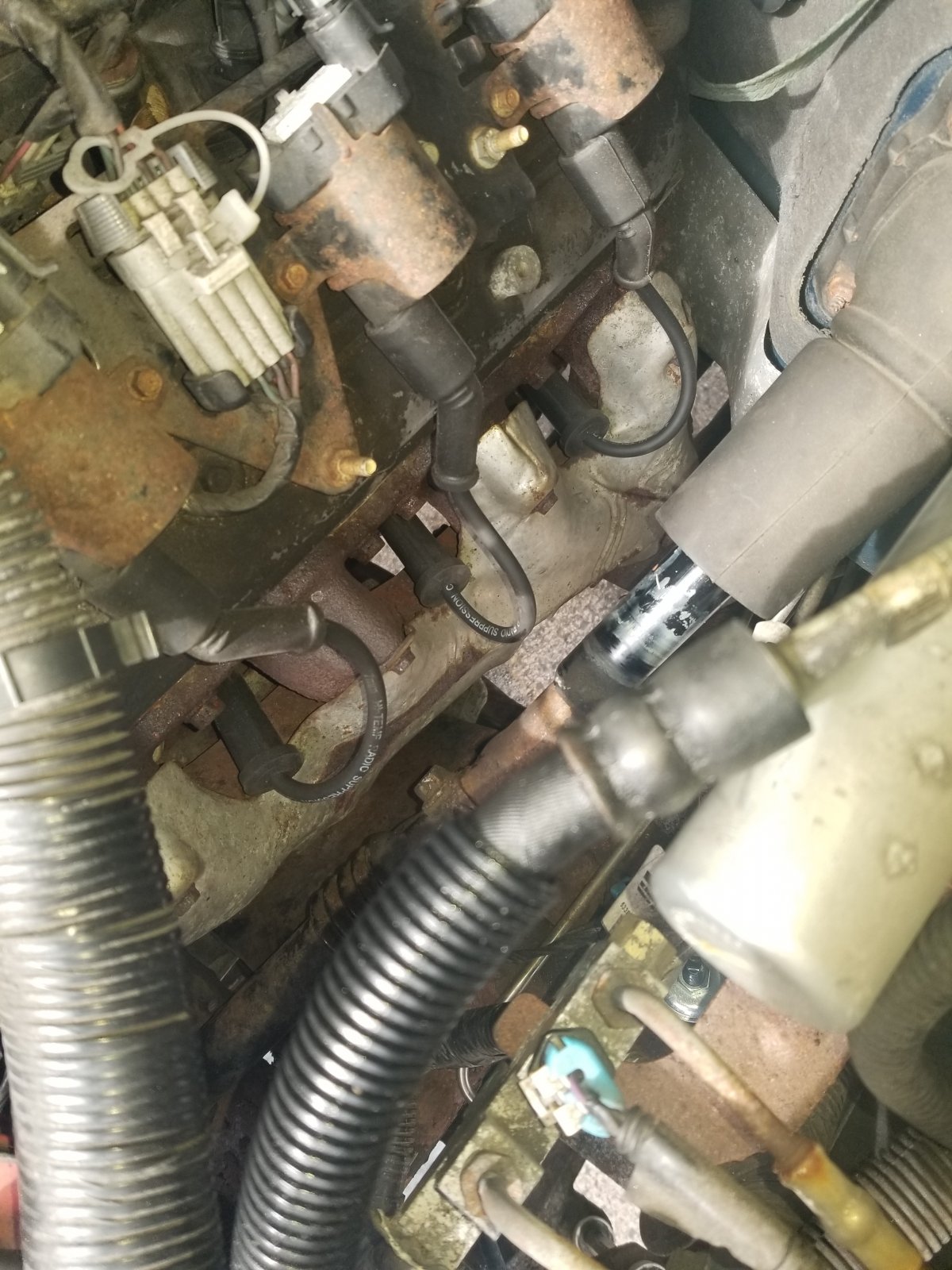

Ok so after replacing there was no play or anything? it's a small amount of play but it still wiggles enough. I wonder if it's causing a lot of my steering issues/loose steering.
