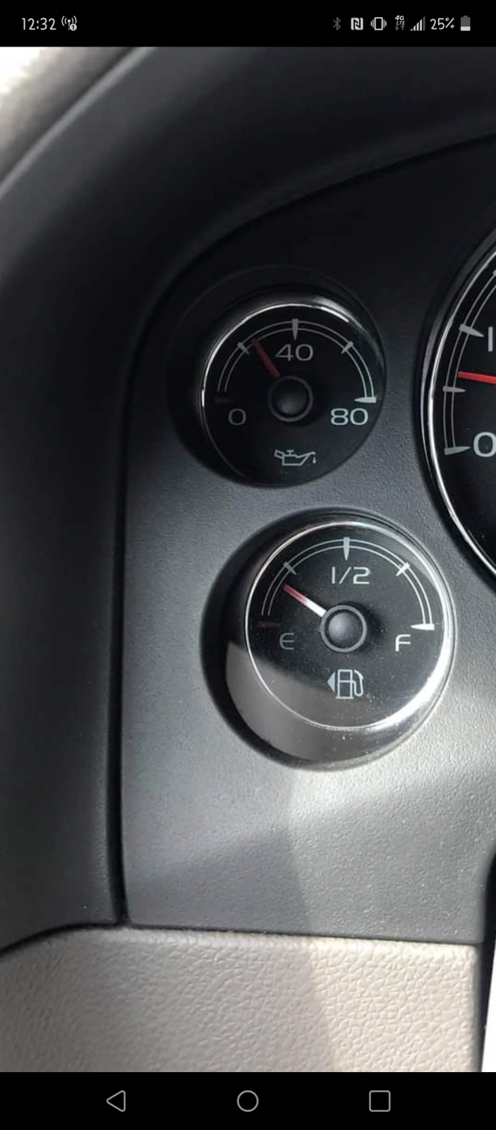

This is where im at my snap on scanner says its 25-26

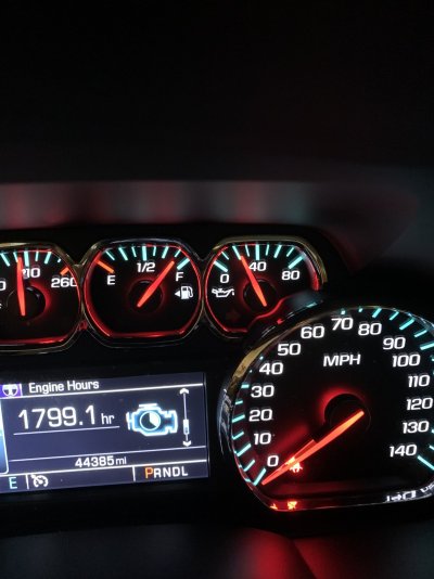

If it helps my 2018 premier sits just above 20 warm at idle
