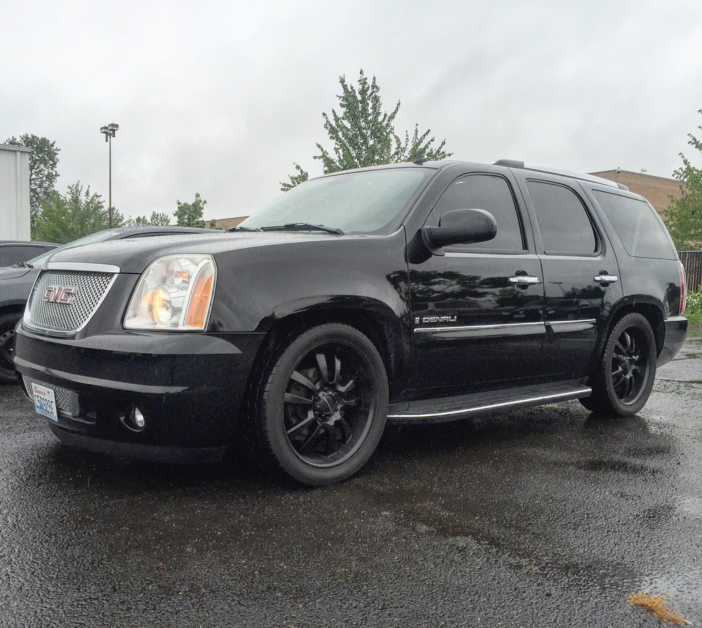

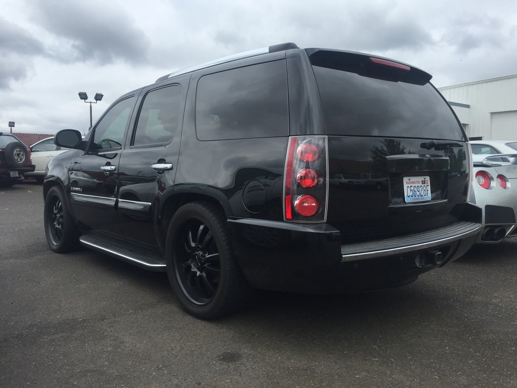

Has anyone done a 3 5 kit on a denali?
I went 3" in the front using the Belltech 2" spindles and McGaughy's coil relocators on the factory Autoride struts set to 1" drop.
The rear was supposed to be a 4" drop, but if I remember my measurements it went down a little more than that (probably due to worn out Autoride).
Anyway, here's a 3" front, 4-ish" rear drop on a Denali with 22's:
