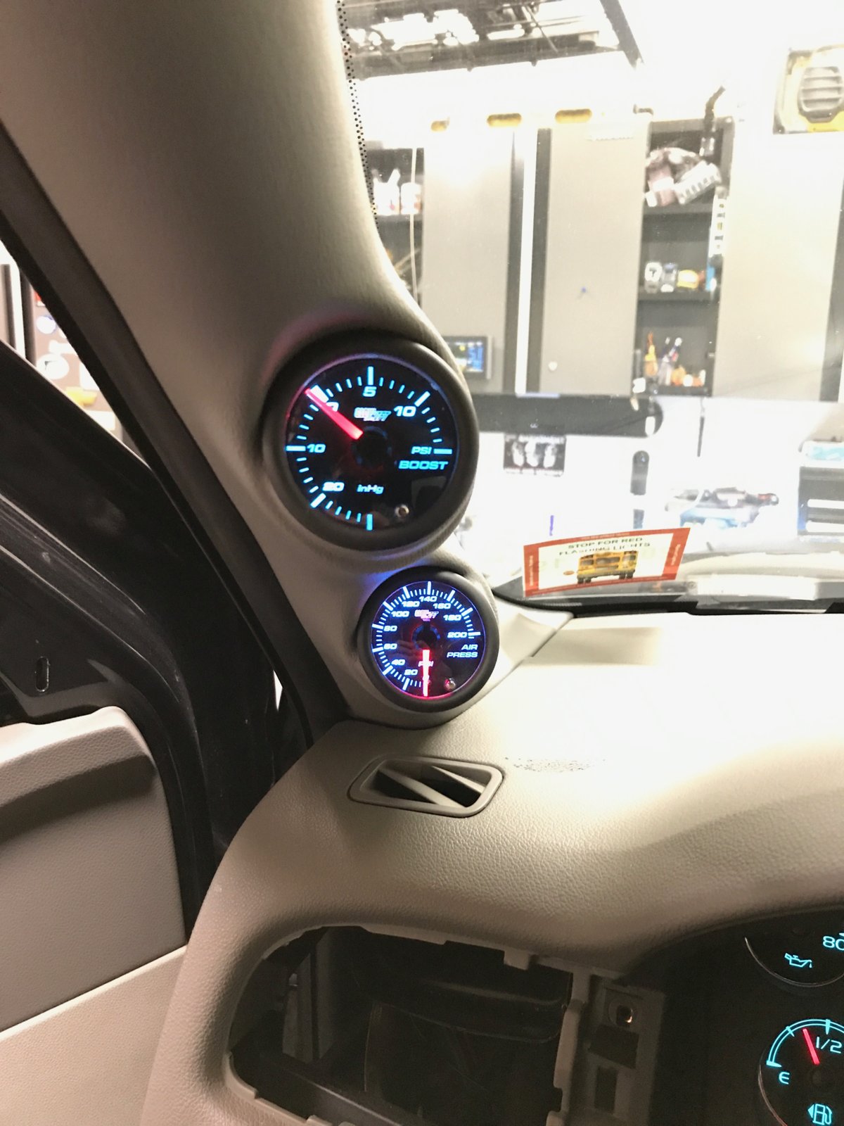

Good morning, as the original thread title says I was only going to slap Supercharger on and call it a day, well this is quickly turning in to bigger project. Many of you have asked me about supporting mods, so I have put a list of all parts so far, I guess I will update this at later time as I am sure this list will grow.
1. Magnacharger TVS1900
2. BlackBear Tune
3. Airaid 202-270 AIRAID MXP Series Cold Air Dam Intake System
4. Kooks Y-Pipe 28553200
5. Kooks Longtube Headers 28502400, *ceramic coating
* Magnaflow exhaust already installed
6. Moroso 85481 Air/Oil Separator
7. Auto Meter 17118 Triple Pillar Gauge Pad
8. GlowShift Black Gauges
9. Accel 9070C Extreme Ceramic 135 degree boot Plug Wires
10. AC Delco 12673134 Oil Pressure Sensor
11. AC Delco Ignition Coil D513A
12. ACDelco 12617944 GM Original Equipment Exhaust Manifold Gasket
13. Stage 8 8900 Locking Header Bolt Kit for GM Small Block
* Considering valve-train upgrade.
what do you guys think as far as dyno numbers?
