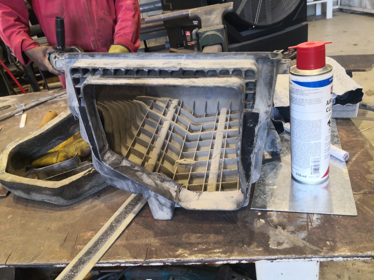

And I saw this S&B CAI for 400$. As in the summer it gets really hot so I think a closed box intake might be good. Or get a K&N filter and put some holes in the Stock air box?

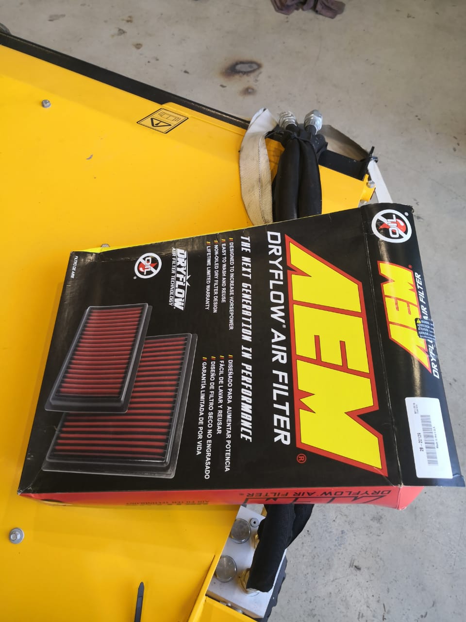

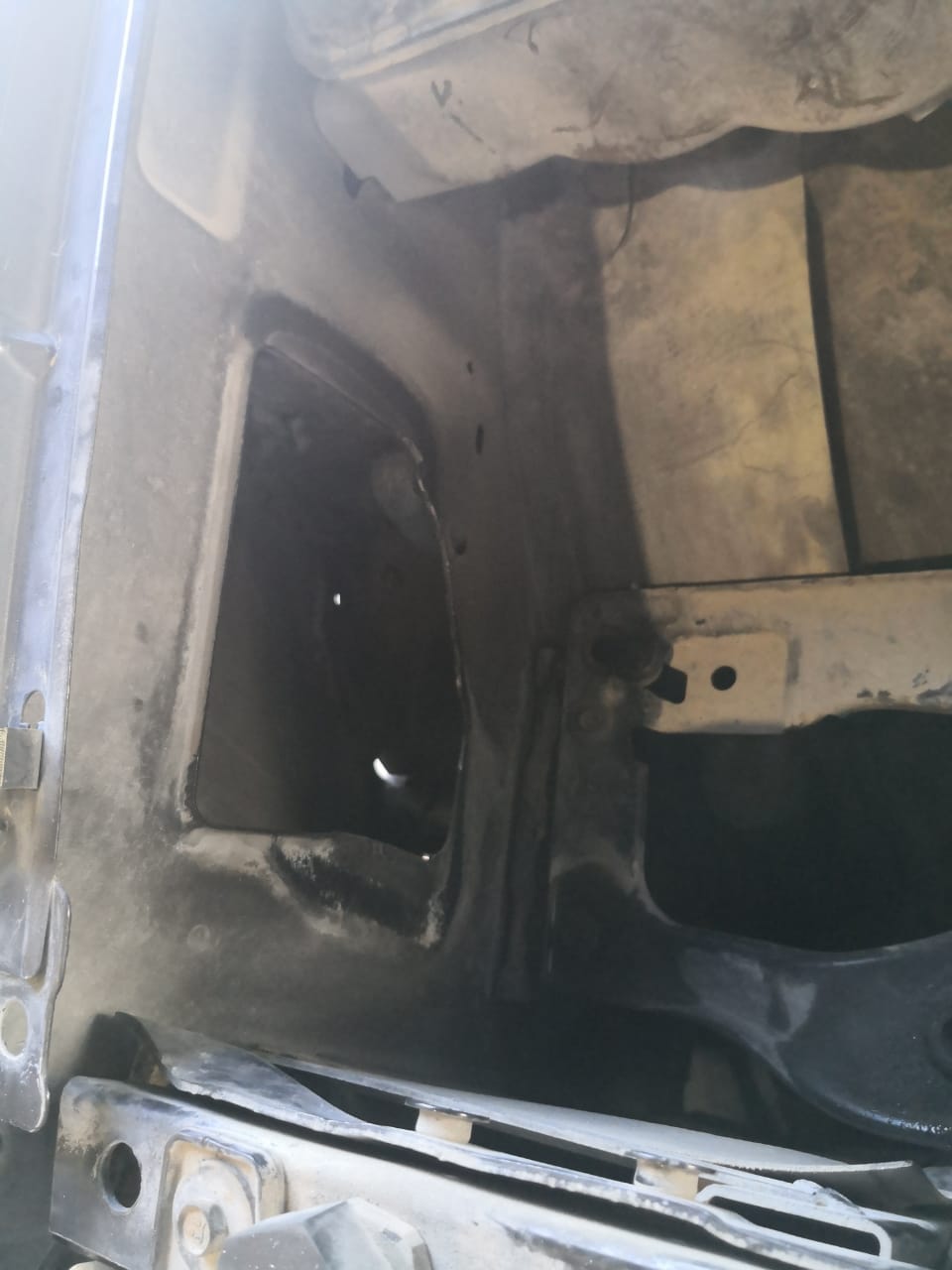

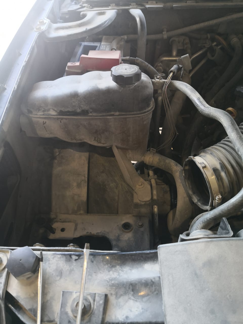

The factory airbox is a "cold air" setup. It draws its air from the cooler fender area.
Just get a good oiless type of filter, like an AEM dry flow. Oiled filters tend to coat the air flow sensor elements and can cause problems if not kept clean
I was planning to buy K&N filter. So this is better? I live in a dusty area. With sand everywhere.

As @gooffeyguy said, just get a good filter. The factory air box IS a "cold air intake" and you already have it. It will flow more air than what that engine can suck at full throttle at 6,000 RPM. It is NOT a restriction. Sure, it's not as pretty as an expensive aftermarket one, but is appearance for something under a closed hood worth $400? The only functional improvements the factory setup could use is a good seal between the filter box and fender and a smoother duct to the throttle body. The original foam seal is thin and loses it's effectiveness with age, especially after the adhesive fails and the foam falls down, exposing the air box to the hot underhood air. Why would anyone in their right mind drill holes in a box designed to isolate the intake air from the hot engine bay air?! Here's a quick, simple and cheap solution for that in my build thread: https://www.tahoeyukonforum.com/threads/growing-up-doesnt-have-to-suck.93510/page-68#post-1451013
To give you an idea of how well the factory setup works, my intake air temps are consistently in a range of 1-4 degrees over ambient, depending on cruising or idling. Also, I have an AEM DryFlow filter. K&N bought AEM or AEM bought K&N, so these filters are the same regardless what's embossed on the rubber seal. Just don't get the oiled type. The dry one flows and filters GREAT. I've had it installed for over 50,000 miles and have removed it for cleaning twice with the first time after 20,000 miles at least. The duct to the throttle body was CLEAN, as in, nothing to show a streak when I wiped it and nothing on the paper towel.
