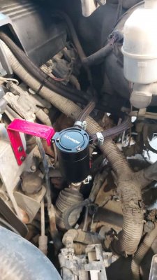

Should I get an oil catch can ?
I can see one in your pic.
