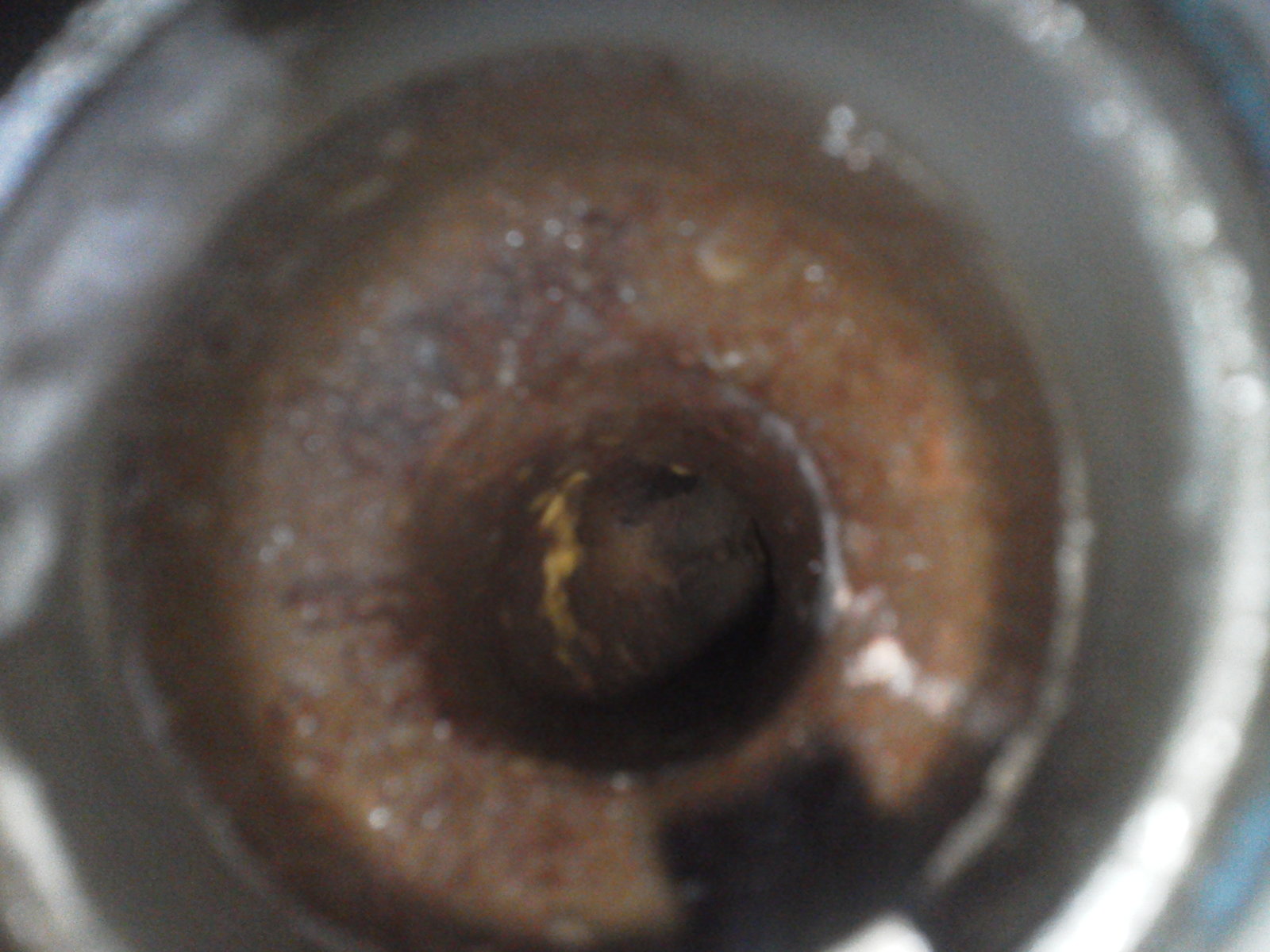

Last weekend, I had the engine running in Park for about 15-20 minutes. I noticed after a while that there was a wet spot right below the tailpipe from a drip. Is this a tell tale sign of possible cracked head? My 04 Tahoe Z71 5.3 has "862" casting # heads and I haven't seen any reference to this particular head being a usual cracking candidate. Tahoe has over 250k on it, so who knows. I do have to top off the water every so often, but I also have a water pump leak that I've been watching. I will be replacing the water pump soon, but haven't done it yet so I just assumed the missing water was from the water pump weep hole, however, it now has me wondering if the moisture/drips out the tailpipe may be pointing to other, further issues. Thanks.
I think that it is condensation. When I drive, I frequently see moisture coming out of the tailpipes of cars in front of me. It is normal. My understanding is that all cars need to be driven on the highway occasionally for an extended period in order to eliminate, or at least reduce, the condensation in the engine.

I'm surprised with all the replies that no one has figured out the cause. No it's not a "cracked head", it is perfectly normal and is caused by the ethanol added to the gas at refinery. Nothing to worry about except shorter life of the exhaust system .
