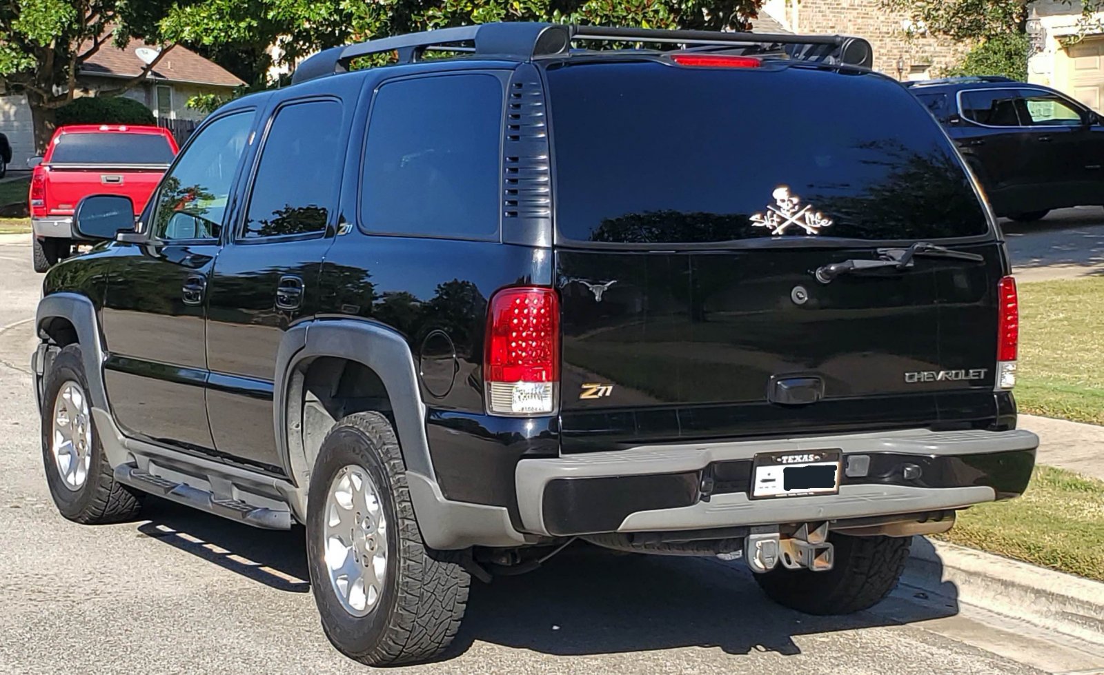

Mike, can you add a shot down the side of your Tahoe so I can see what kind of effect the 2" spacers provided? Also, did you notice any turn-radius or other driving differences?
Sure thing! here you go. The turning hasn't seemed to change that I can tell, but I do have a little rub that I'm going to need to fix that I didn't have before. It's not on the fender flare like I would have thought. It was the plastic wheel well insert. I'm going to have to trim it about 1/2 and inch and it should be fine with my 285/70/17 tires.
