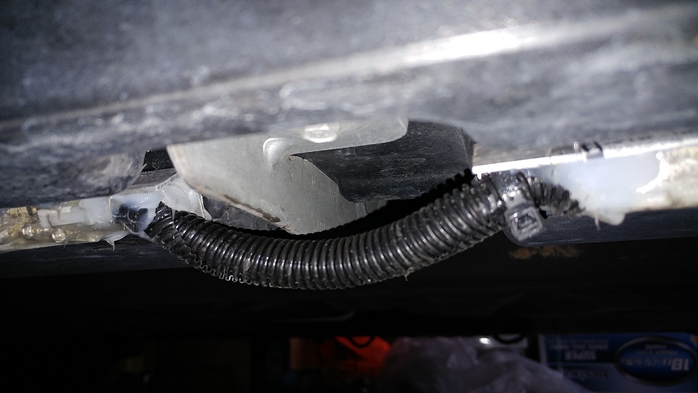

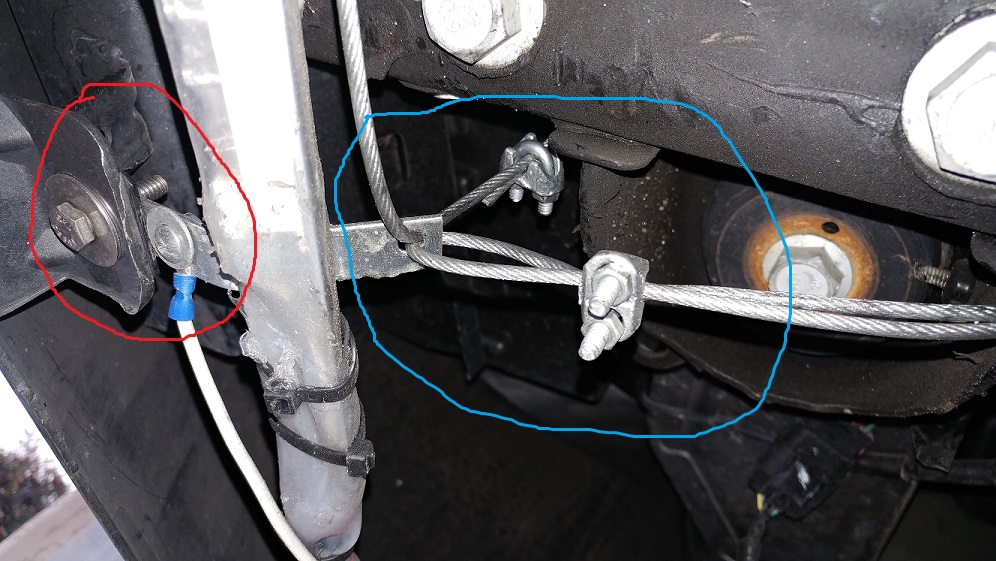

Here is the major departure from my original plan. Originally the outside lighting was to be tied to the dome circuit. Since the dome circuit builds power slowly and dims out, I was getting noises from the relays. So rather than tying it to dome lighting I tied it to the Exit and Approach lighting. Simple fact, parking lamps are powered for 20 to 30 seconds on unlocking. So I tied the under board lighting to that (Left Arrow, Fuse 26 Right Parking). To keep the under lighting from coming in during normal operations, I tapped in to Fuse 43 (Right Arrow) to keep the relay open when the Ignition is on. All wires run from the front to underneath thru the outside. No need to tap or drill thru the body.

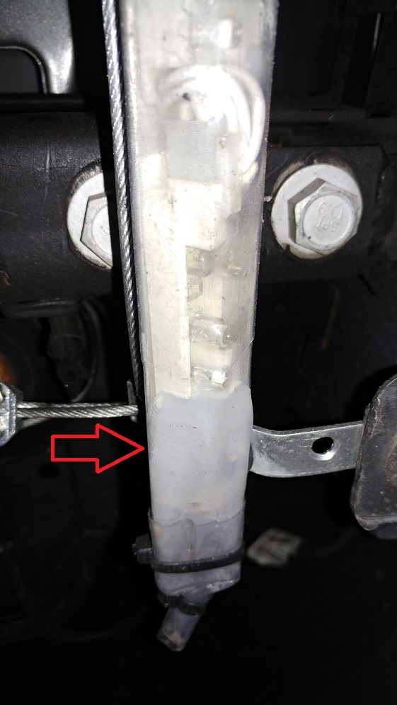

Here you can see the result of the lighting Left and Rear. A side not is this. The rear bumper lighting is an independent run all the way to the engine compartment at is attached to 5 amp fuse. We do go to the lake some times and the truck does get submerged. Hopefully it will only that 5 amp fuse if it shorts. But these lights are packed with silicone and I am not expecting any shorts. (Fingers Crossed)

There are some drawbacks with this wiring solution. You don't get puddle lights on approach with remote start and while exiting with engine running. However, the idea of keeping all the wiring on the outside is tempting.
I calculated some time ago that if you change all interior lights to LEDs, the spare capacity should be enough for BCM's dimmer to handle outside LEDs as well. At least I remember I did. Will check again soon...

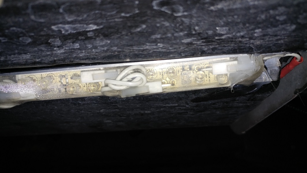

How did you install the lighting underneath your running boards, etc?
That was supposed to be my secret. :).
I just came back from a long drive. Took the family out. To me the effects looked amazing. I will post the pictures soon, within a day or two, just to make sure it shows how I put it together.
Besides I am really tired right now :)
