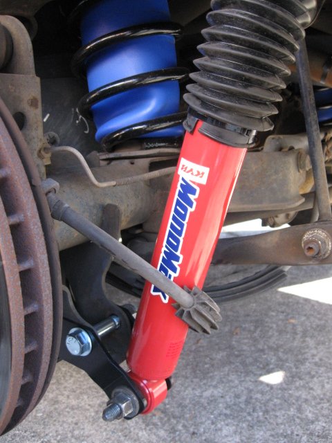

Haven't decided about getting different springs just yet. If I do, I don't know which ones to get. Everyone said the bilsteins are softer. I don't need softer. Worst case would be take the originals and cut them down.
As far as lowering springs, they should state they’re compatible with the Premium Smooth Ride that your truck has. Cutting down your originals will result in unknown ride quality and height. I know you said your doing a budget build but suspension and steering should be priority. It’s pretty important. Here’s some Belltech that are advertised for a 3” drop with your truck. They’re not cheap but if you’re getting a high speed wobble you could lose control in the wrong situation and that would really cost you.

I totally agree with @Rocket Man , I would not try to save a few bucks on a supper critical component.
We have had at least one other member here I can remember who had a similar death wobble after he put too soft of springs in the rear. It makes the read end feel “squishy” and it starts to sway back and forth iirc.
Makes since. I'll have to check out the other lowering springs and see if it makes a difference. Its ok in town for right now. But worry about highway speeds would intensify the issue.
Thanks so much for the link. The price of just those springs is the total price of my Crown kit with the drop spindles...lol Would like to get them and try them out. But what to do with the other ones. Plus I have my air bag system in the springs. Be a challenge to get them out out of the springs.
