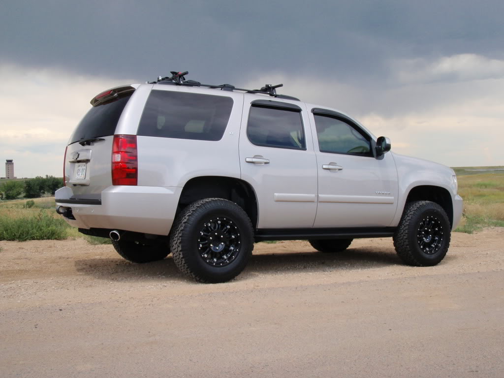

I would recommend that you go with 2.5" up front using either a spacer(CCM,ReadyLift,Zone Offroad) or a combination of small spacer and height adjustable shock(Rancho Quicklift, Bilstein, Belltech). For the rear go with a 1" coil spacer.
With this combo you can fit 33's, but you will have to keep the tire width close to stock such as a 275/60-20...to fit a wider tire 305/55-20 you will need to trim both some plastic and alittle metal, many have done this its not as bad as it may sound. A good compromise between the to would be a 285/55-20 which would fit on stock wheels, but may require some plastic trimming on aftermarket wheels.
Your best bet is to stick with an all-terrain style tread design to keep road noise to a minimum yet still provide a good "look" and good performance. I run Nitto TerraGrappler's on my tahoe and travel with it just about every weekend(200+ miles) and it is louder than stock, but not an annoying level.

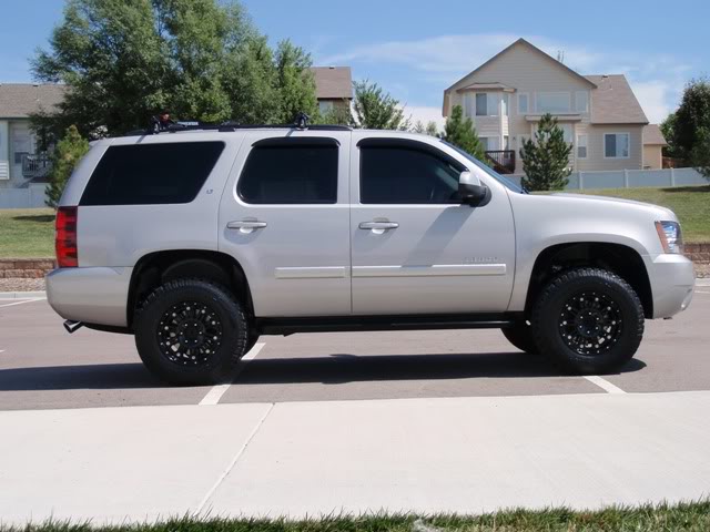

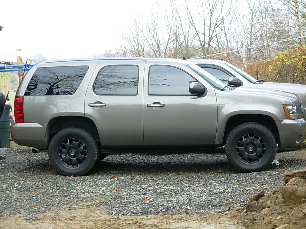

TRUXX kit is a 2.5" front spacers and 1.5" rear.
Rides like stock. You don;t have to change your shocks out. You will need a front end alignment though.
You can fit 33" tires on there with zero rubbing....even off road. My wheels are 17 x 9 XD Hoss with 5.5" back space. Tires are 285 (33") bfg at's.
..although I need to go see max so I can get my 35's on there. :driver:
---------- Post added at 10:02 PM ---------- Previous post was at 09:59 PM ----------
side shot.
..and just becasue we got the grille painted and dent fixed. :)

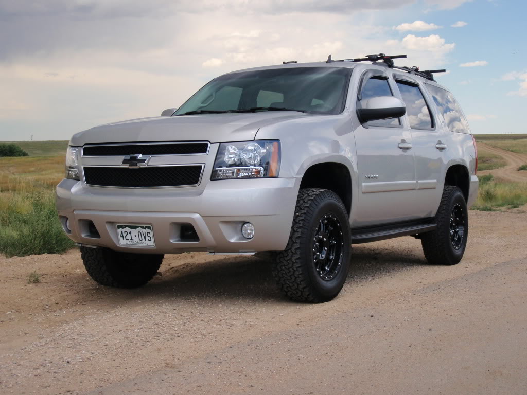

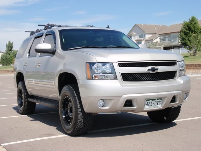

Just a quick pic of mine...CCM 2.5" front spacer with 1" rear coil spacer wheels are 20x8.5" with 305/55-20 Nitto TerraGrapplers
K
KSwizzy
Nov 18, 2009
12
You and Timgco's are basically the same lift height just you have more wheel and tire filling up the fender well?
How dark are your windows on there? Can you see backing up at night good enough?
