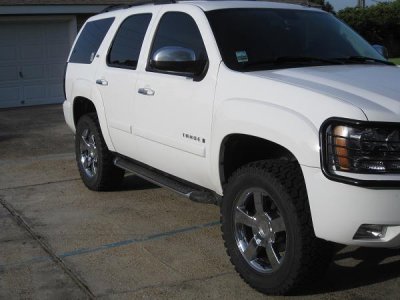

Since everyone is showing there level kit, here is a picture of my Z71. I need new tires soon...
