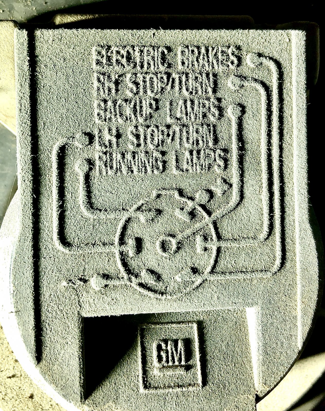

Look for a trailer 7 way trailer connecion near the license plate. If the vehicle has this connection, one of the terminals is battery positive and one is battery negative. You can try to power up the vehicle via these connections, maybe charge the battery, too.
Interesting approach I’ll check it out.
