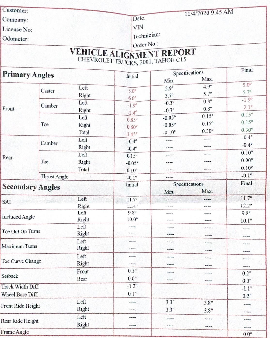

Truck has not been aligned yet, it was aligned a week ago. I had 2 degrees of negative camber, caster was perfect, toe was perfect. I installed the moog problem solver upper arms which offer 2 degrees of positive camber. the wheel sits perfectly level now according to my camber gauge which mounts to the hub. That problem has been solved by swapping to the offset bushing upper arms.
jounce stops are like new, they are belltech jounce stops, and have been installed for several months.
when in reverse you can install the camber gauge onto the hub, and watch the wheel physically lean in 4 degrees. I have a video i can post a link to so you guys can watch this happen.

You can see the wheel roll in and out, that is for sure. To get that much movement, there either has to be something that is not tight or something not seated properly. Have you checked your toe angles? If the front is toed in, it will want to pull the bottom of your wheels in going forward and pull the bottom of your wheels out going backward.
Personally, I'm not sure I would spend much more time trying to diagnose it as you should get it aligned again no matter what. I know you think that the only "change" is your keys, the fact is you replaced quite a few components up there and it needs to be re-aligned properly.
