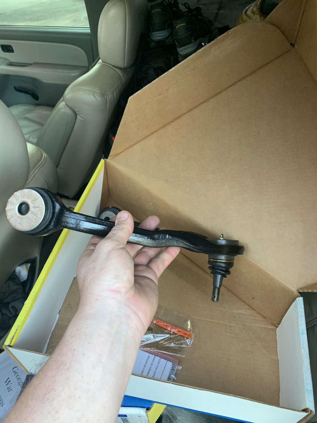

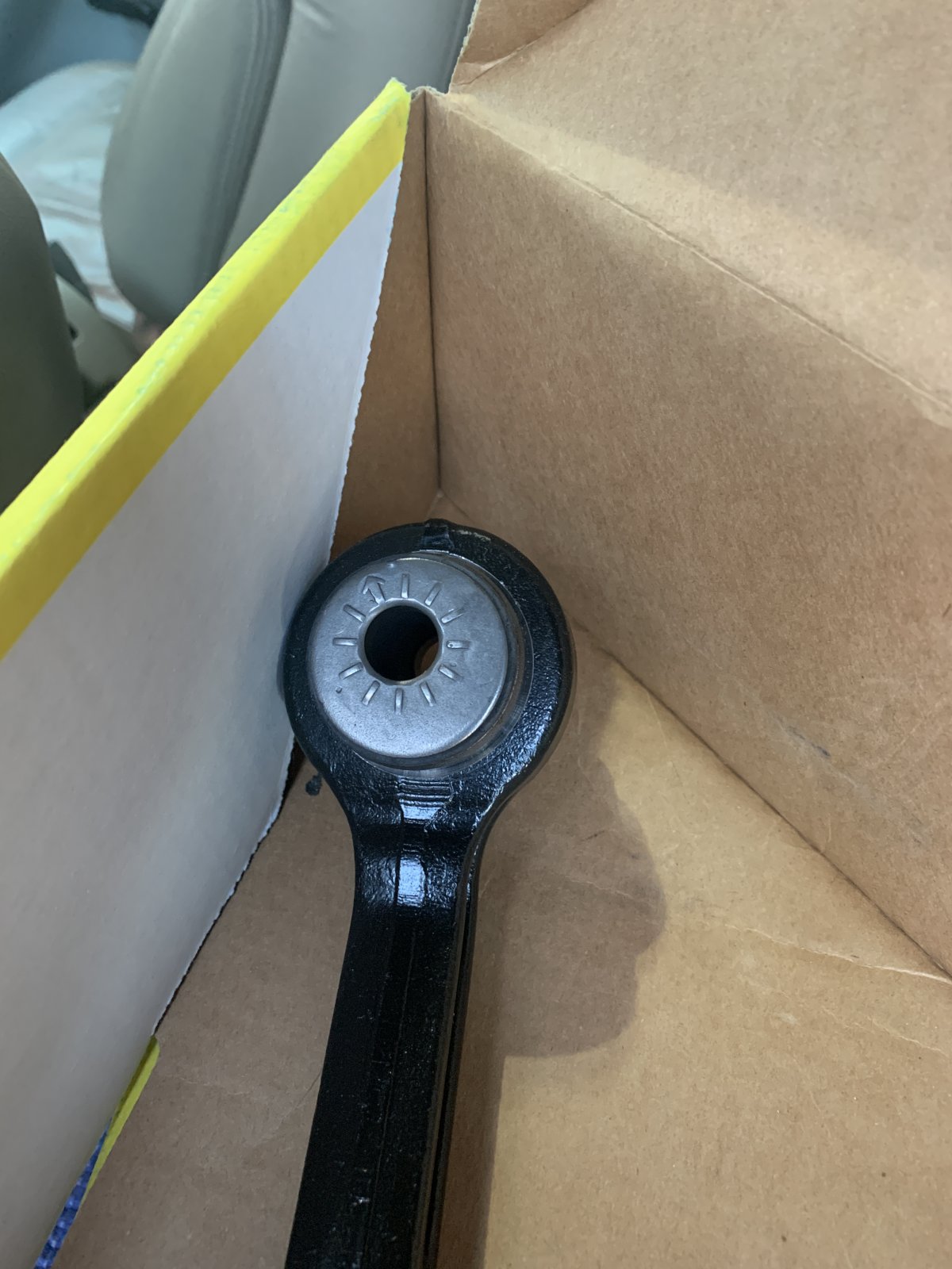

I started to think maybe the offset bushings were installed incorrectly, but if I’m reading it correctly, you purchased the moog UCA with the offset bushings already installed, correct? You should be able to get spec camber and still have good caster. But there’s been several horror stories over the years with these rigs not being able to get aligned after lowering.
Did the toe adjustment fix the camber change?

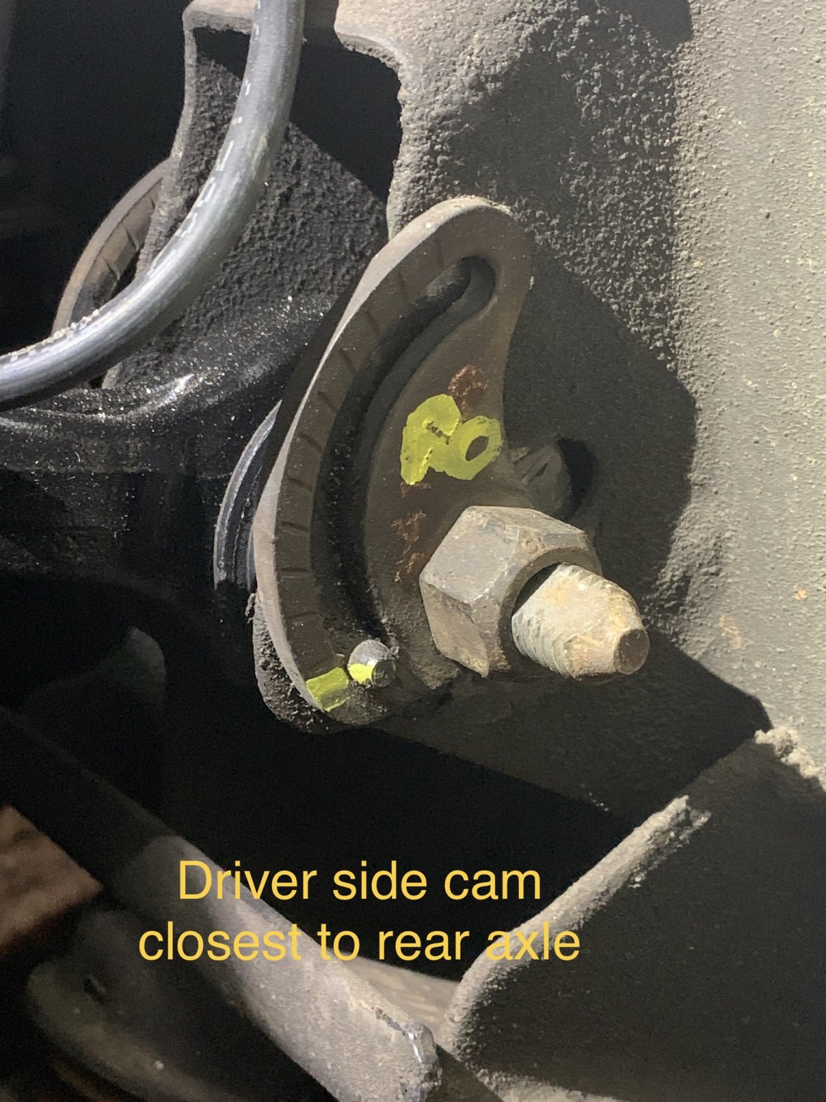

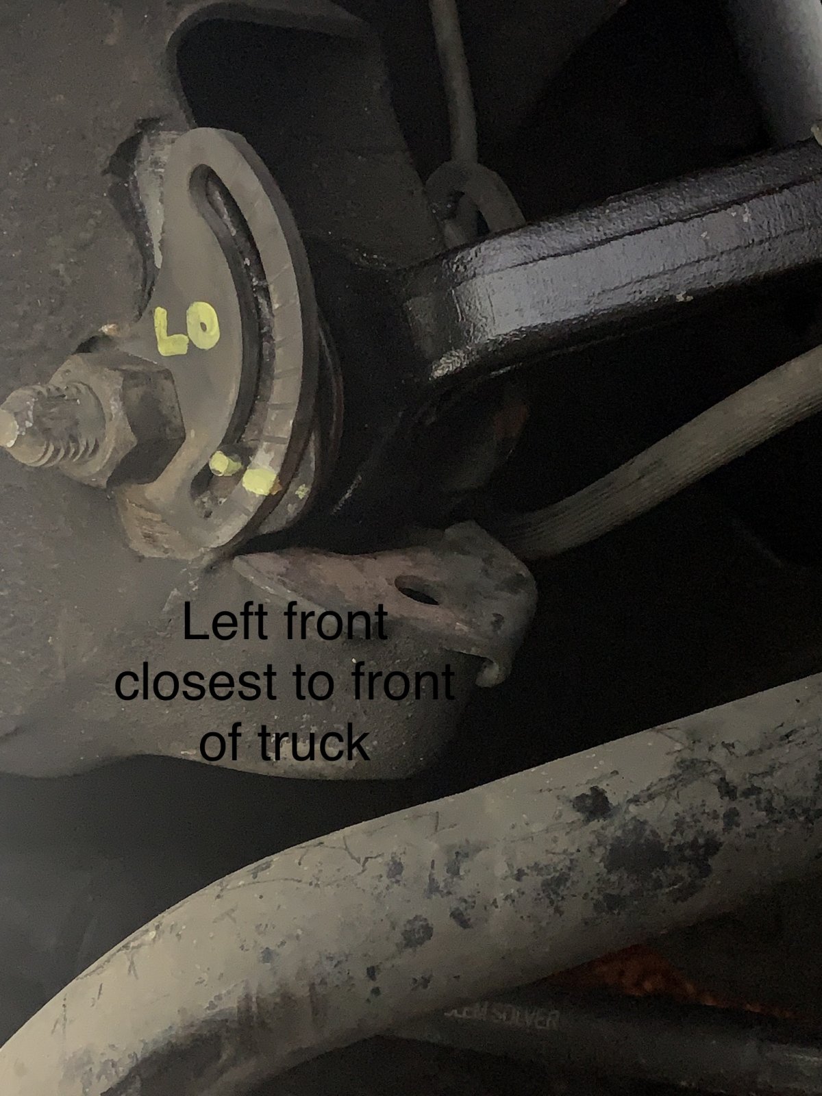

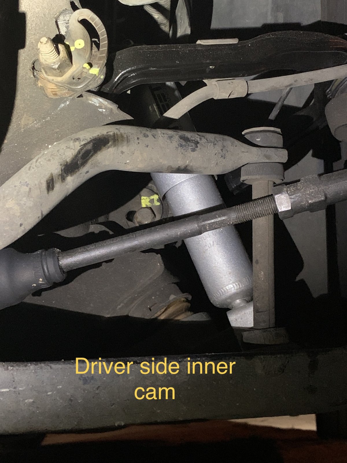

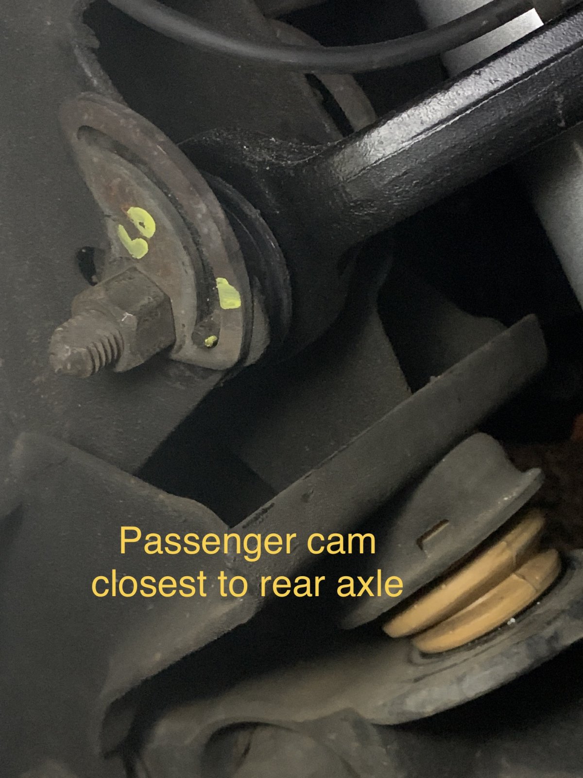

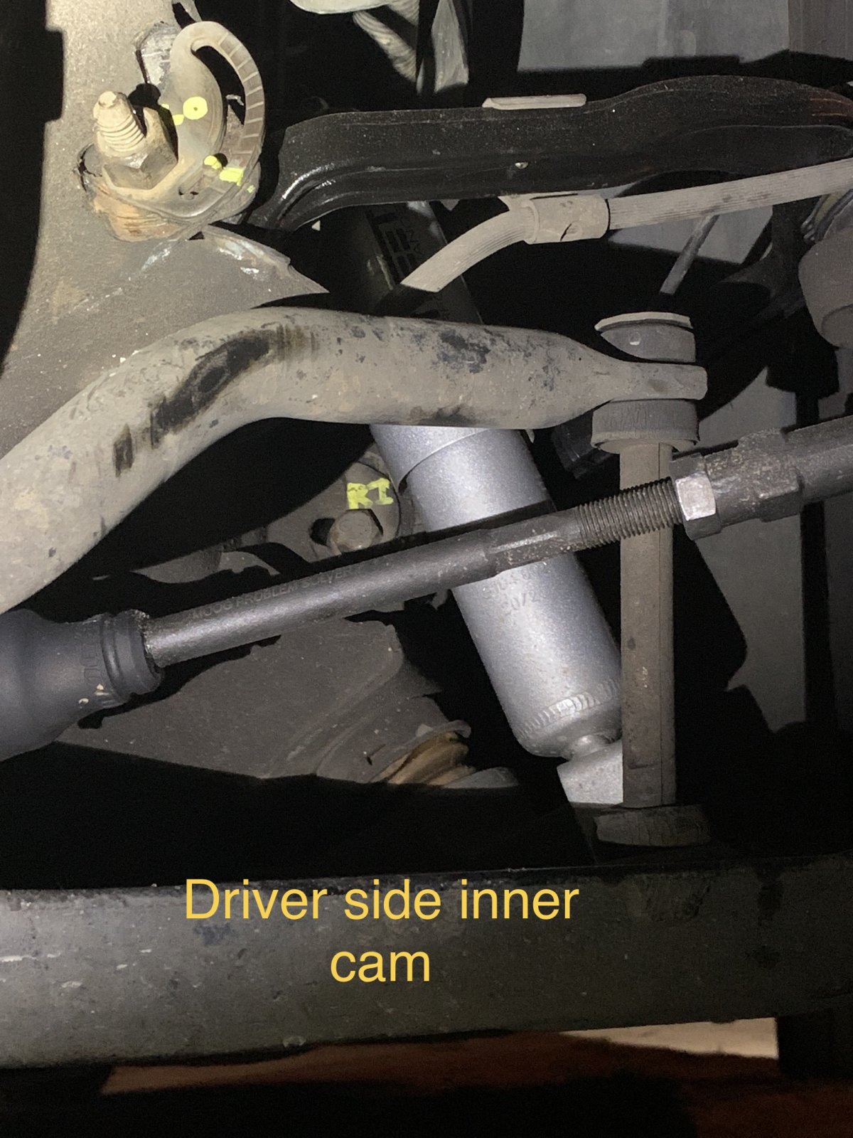

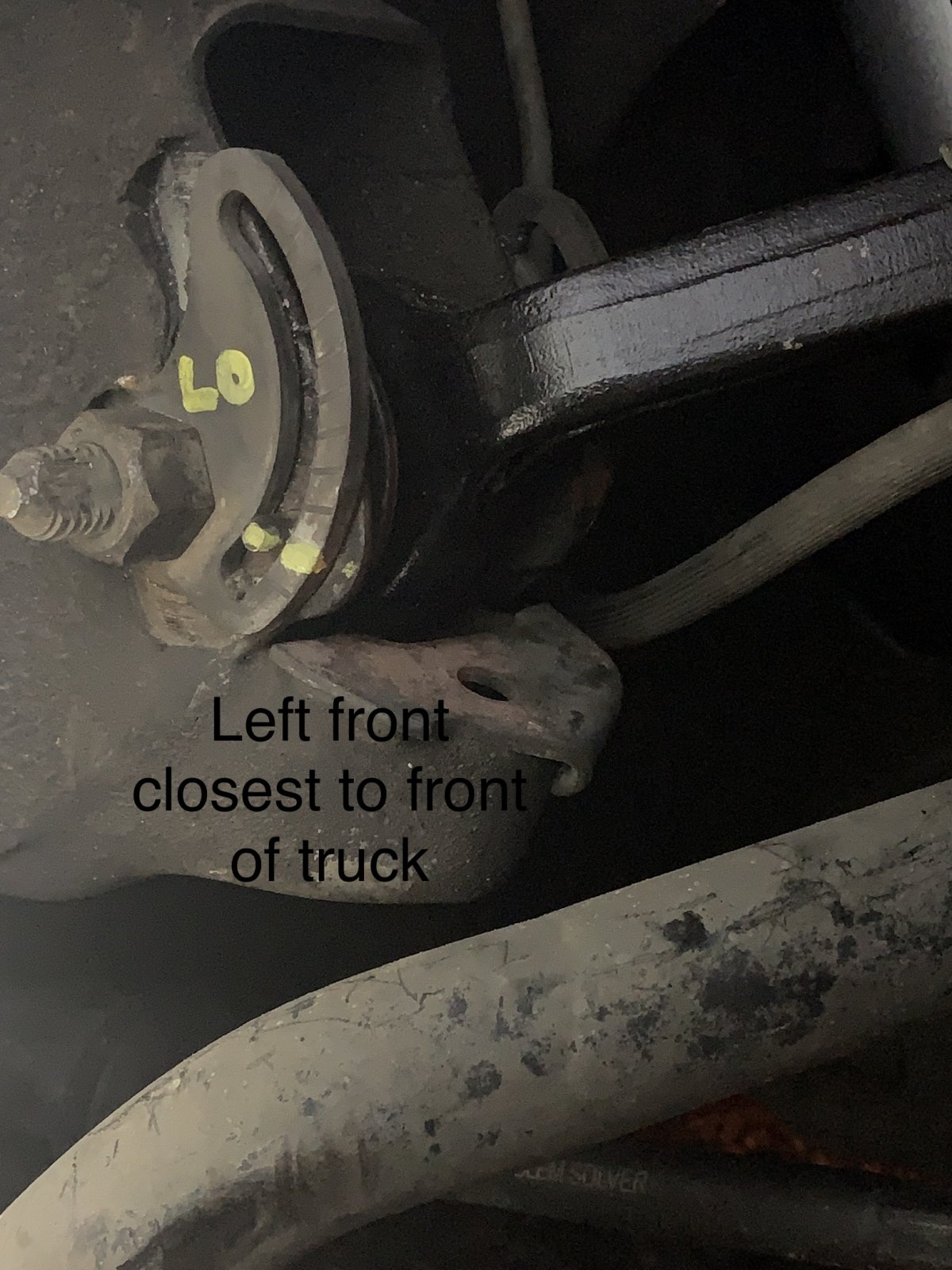

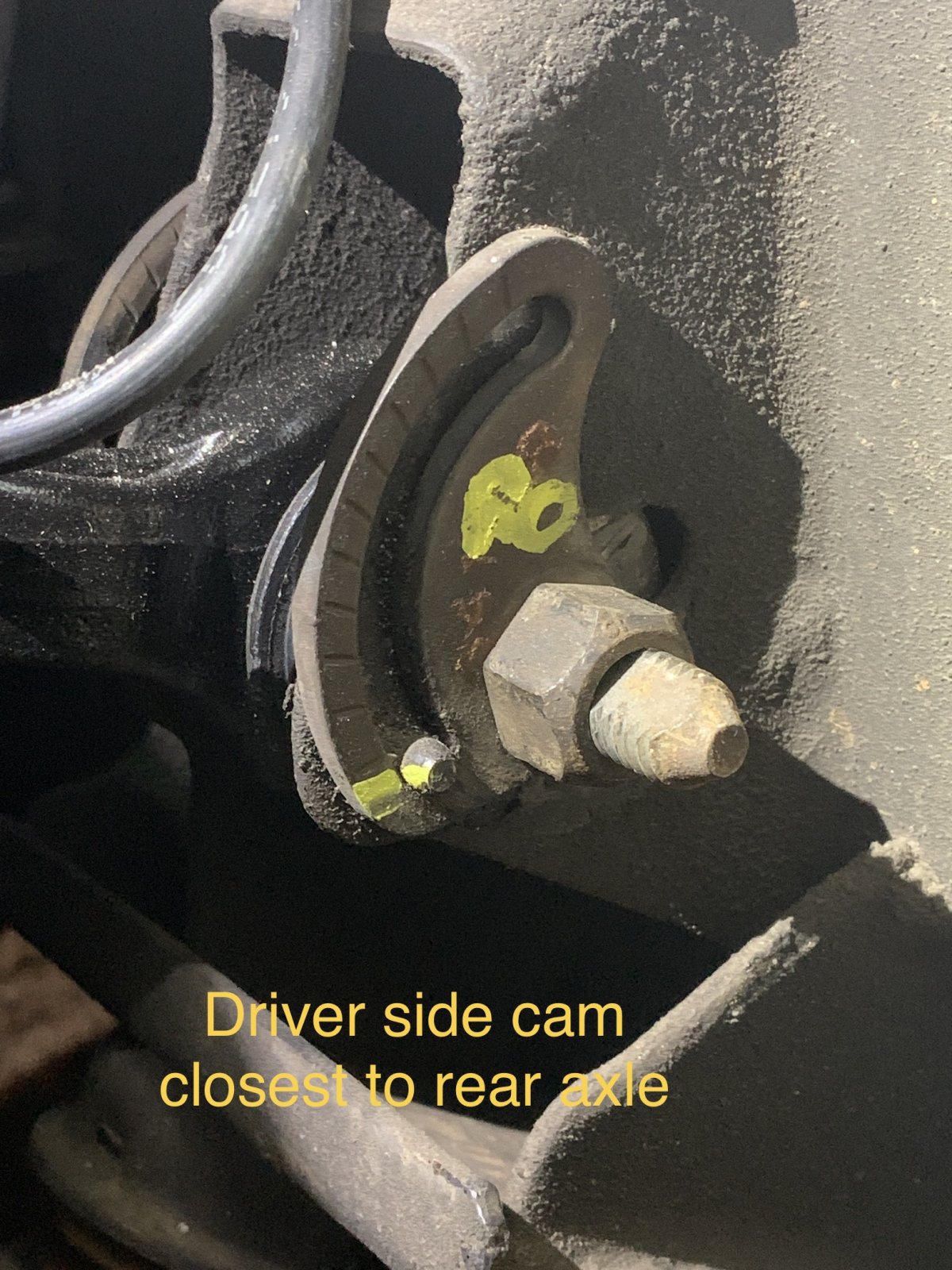

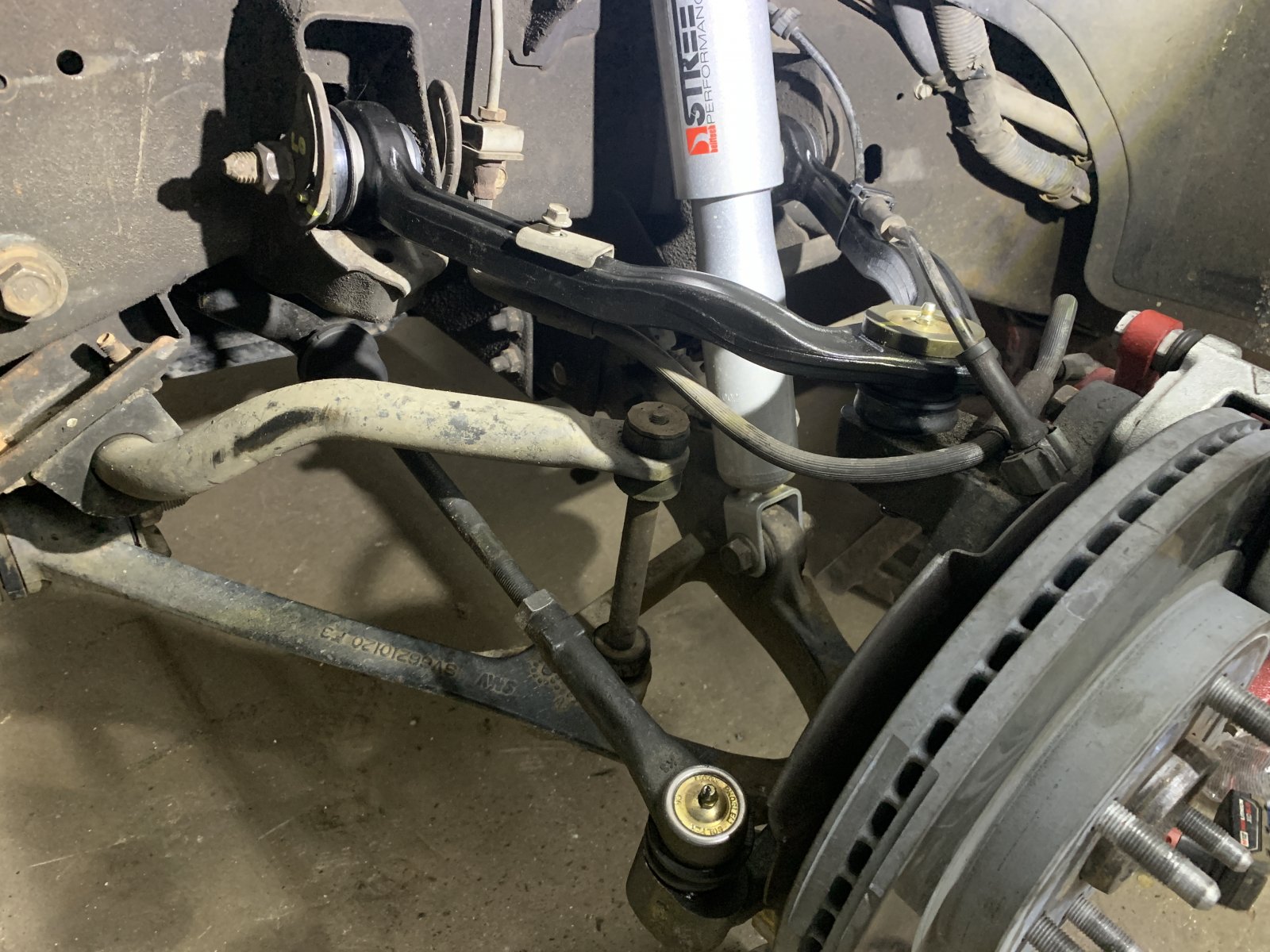

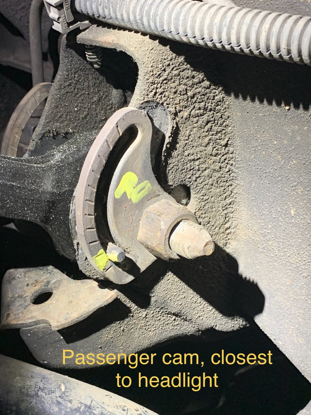

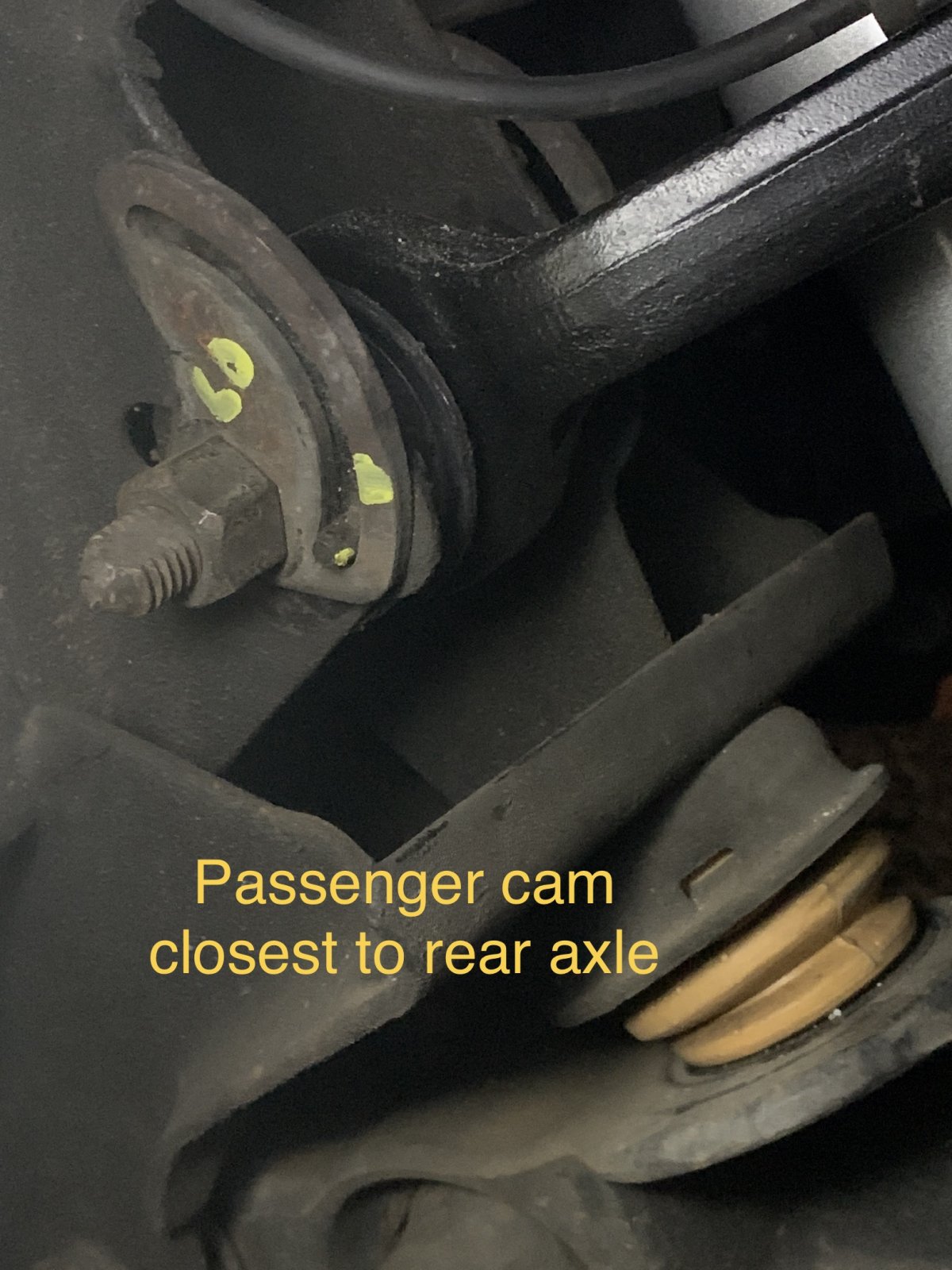

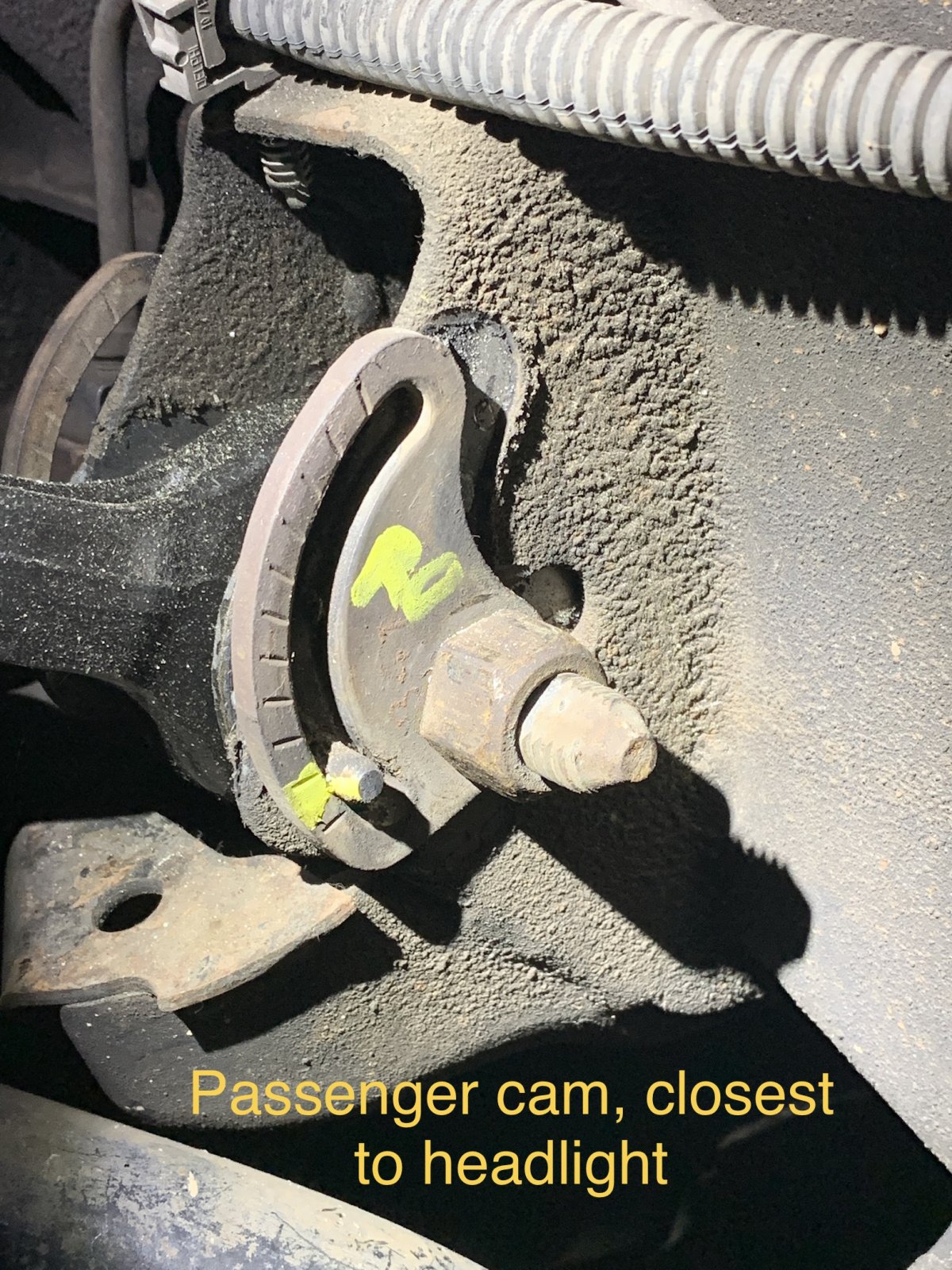

Can you also provide pictures of all 4 UCA brackets to see how it’s orientated?
