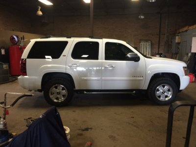

Went 2 in the front and 1 in the rear. (Insert joke here) gives it just a slight rake.
Word of advice for the install. Rent a spring compressor for the rears. It was a pain in the ass without it.

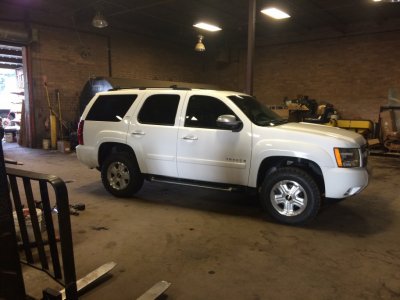

Update on my current measurements. Just went out to re-check. Front is 38", rear is 38.25". When I was out there I put my floor jack under the vehicle and lifted the body only up 3/4" to a rear ride height of 39". Doesn't look too bad with 1" of rake. ( also I currently have only 1/4 tank of gas with these measurements taken.
