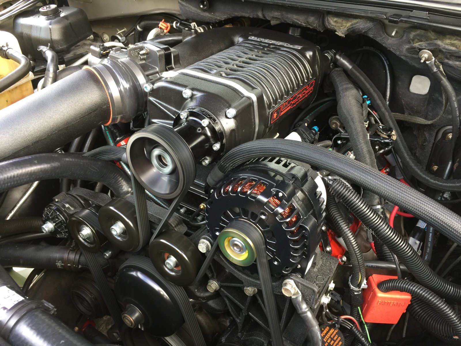

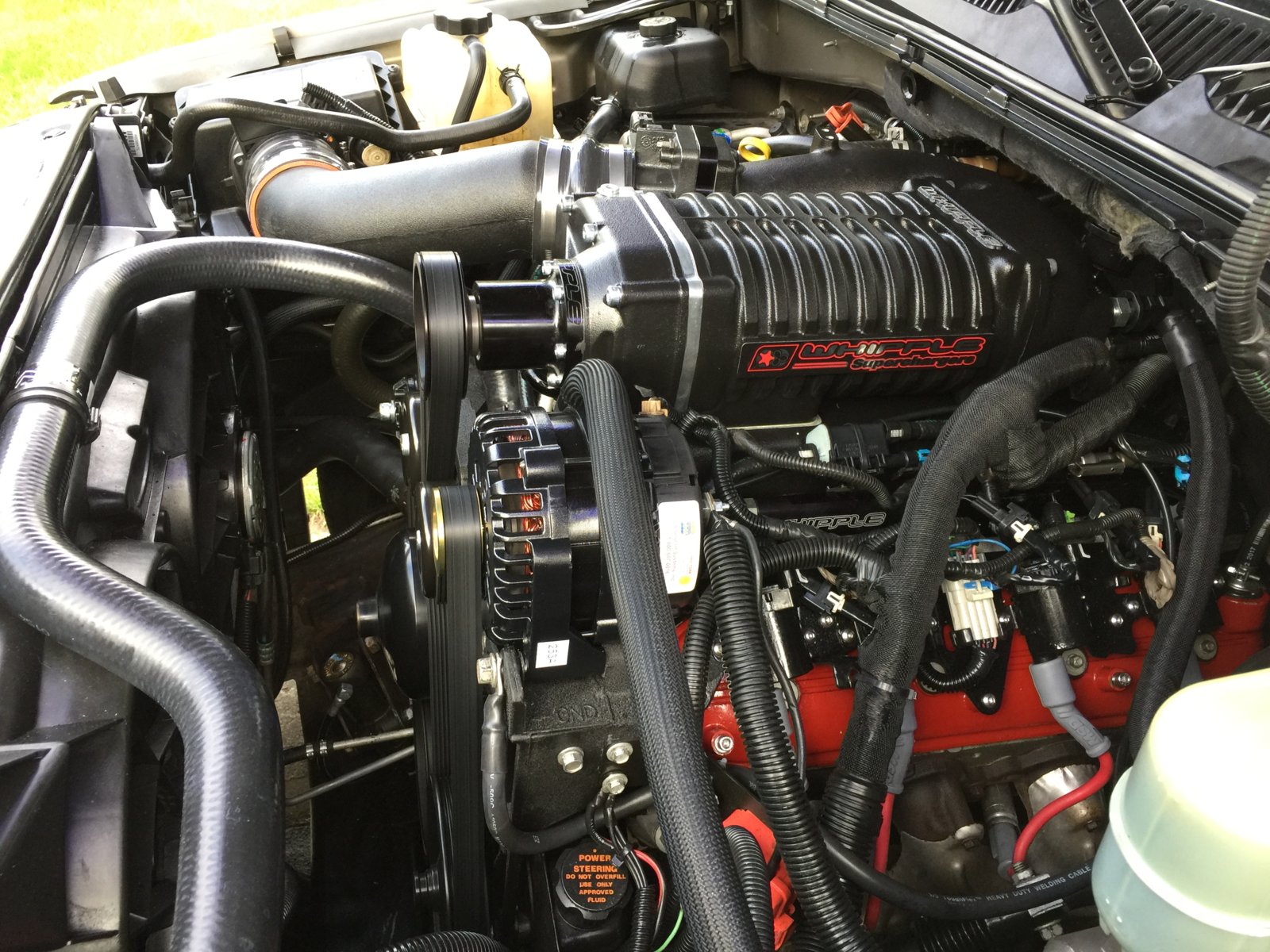

The LT1 is a 450 HP car engine. Not sure how it will perform in a truck twice the weight of the cars it was designed for. A new Titan makes 390 horsepower. One from 2010 made 317 horsepower. A tune and mods of course can dust a stock 5.3 in a Tahoe. But a supercharger added to a stock 5.3 and that Titan will quickly fade in your rearview mirrors, even a modified one. An LMG with a TVS1900 is also rated for 450 horsepower.
