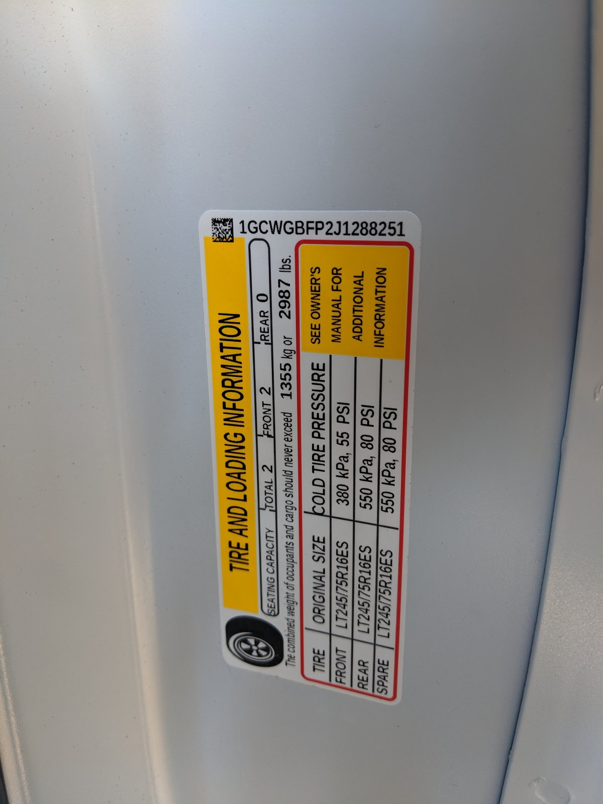

My door stickers say 30 PSI on my '07 and that makes my BFG AT's look like they are half flat. What is correct? If I go to the tire shop they refuse to put more than what the door says. I don't mind running that pressure just the tires look funny at that pressure and make a lot of scrubbing noise at that pressure during sharp turning like in a parking lot.

I have Mickey Thompson LT tires on my 'burb and run them at 40psi. The door sticker is for a P rated tire, not LT and when the LT's were run from the previous owner around 32 they were wearing the sides down more than the center and rode pretty bad. At 40 they are sitting perfect and ride greate.

I heard so many arguments that I called the Goodyear Tire Co. The max pressure printed on the tire is the max for mounting a tire. It is never to be exceeded when seating the bead. The operating pressure in the door jamb is what you go by. You can exceed that number by a few pounds when carrying a heavy load. Running a tire at max mounting psi, especially here in Florida, will greatly increase the risk of tread separation.
