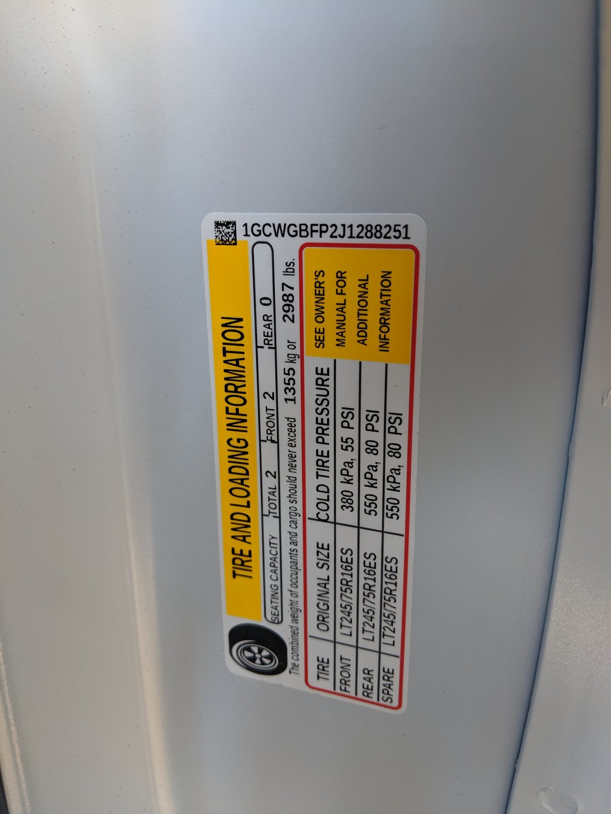

I heard so many arguments that I called the Goodyear Tire Co. The max pressure printed on the tire is the max for mounting a tire. It is never to be exceeded when seating the bead. The operating pressure in the door jamb is what you go by. You can exceed that number by a few pounds when carrying a heavy load. Running a tire at max mounting psi, especially here in Florida, will greatly increase the risk of tread separation.
So what about a case where the door sticker for the rear tires is the same as the max pressure for the tire!!
Stbentoak
Jul 20, 2020
1,857
2,160
You didn’t buy the right load range of tire then. You must’ve bought a passenger tire and you should be looking at a light truck type heavier duty with more plies tire….
TJ Baker
Mar 5, 2018
194
183
Colorado
The tires are the exact same tire sold with the truck as new. The door sticker is factory supplied. Are you suggesting they manufactured the truck with the wrong tires!!??
