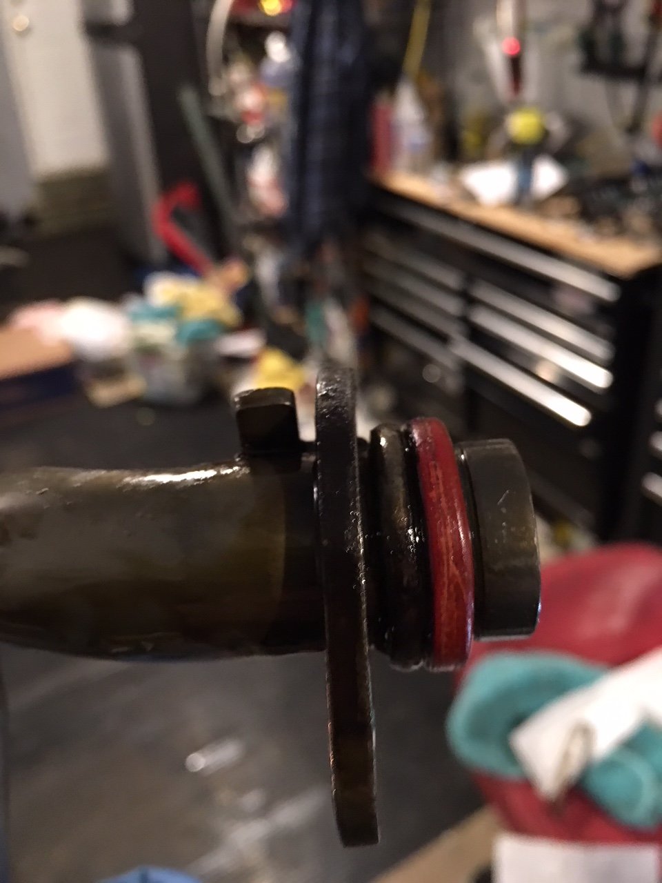

I'm going to say a prayer, sleep well, and hope that I find a similar issue. Just bought this, and dang it I never saw that at idle it'll drop down to zero. Goes right back up when I get going, but now I have a new rig and A LOT worried to drive it. 2007 Denali, so I'm hoping 4x4 won't be an impossible task...
Would appreciate any help... Thanks folks-
rook
Oct 17, 2012
79
20
Alright, I'm getting myself psyched up... Any confidence builders for dropping the oil pan on my AWD Denali? I'm thinking I can get it down and do this - there is also a little plate up at the front of the pan that might give me a little window to the pump? Anyone know?

rook, not sure which part of that thread is your issue.
i had sudden no oil pressure and i took steps in the op post #1.
i had about 200klm on a gold FRAM high mileage filter, and some really cheap oil. up until this point, i had been running quaker state DEFY it is a high mileage oil with zinc and other additives. I do NOT know if there are rubber swelling agents in this oil but here is my theory on my situation. my oil pressure is back to normal now, it idles at 45-50psi. it takes about 2.5 seconds to "build" up to 45-50 psi. it clearly has "bursts" of pressure build meaning the needle is not steadily building. i would suspect the stepper motor on the dash cluster (known issue for this gen of chev) BUT i regained my pressure when i put a new pressure sensor on, dumped my cheap oil and went to the qs defy again, and dumped my fram filter and went to wix.
but there is still the strange pressure buildup behavior.
i suspect it is the oring as was the case in the op post. there must be something in the qs defy that helps seal the oring.
to be honest, it may have always been like this.
i will drop the pan, clean pickup screen, and replace the oring as soon as the 85corvette project is out of my garage in a few weeks.
rook
Oct 17, 2012
79
20

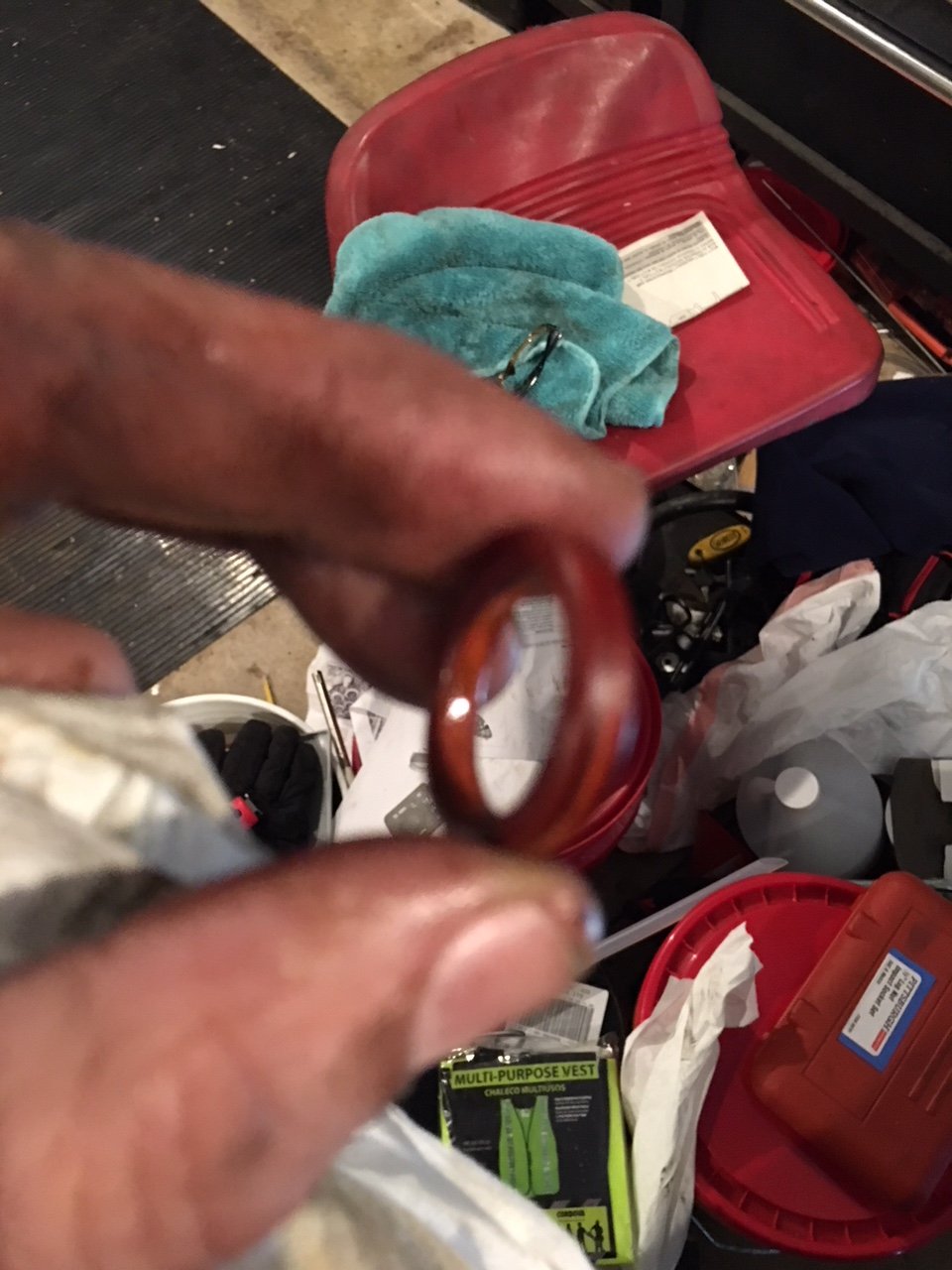

My problem was the o ring. It was hardened and in no less than 5 pieces bleeding oil. All fixed, good as new. It's weird how it threw the stabilitrack warning, but that is working too (we just got snow last week)
