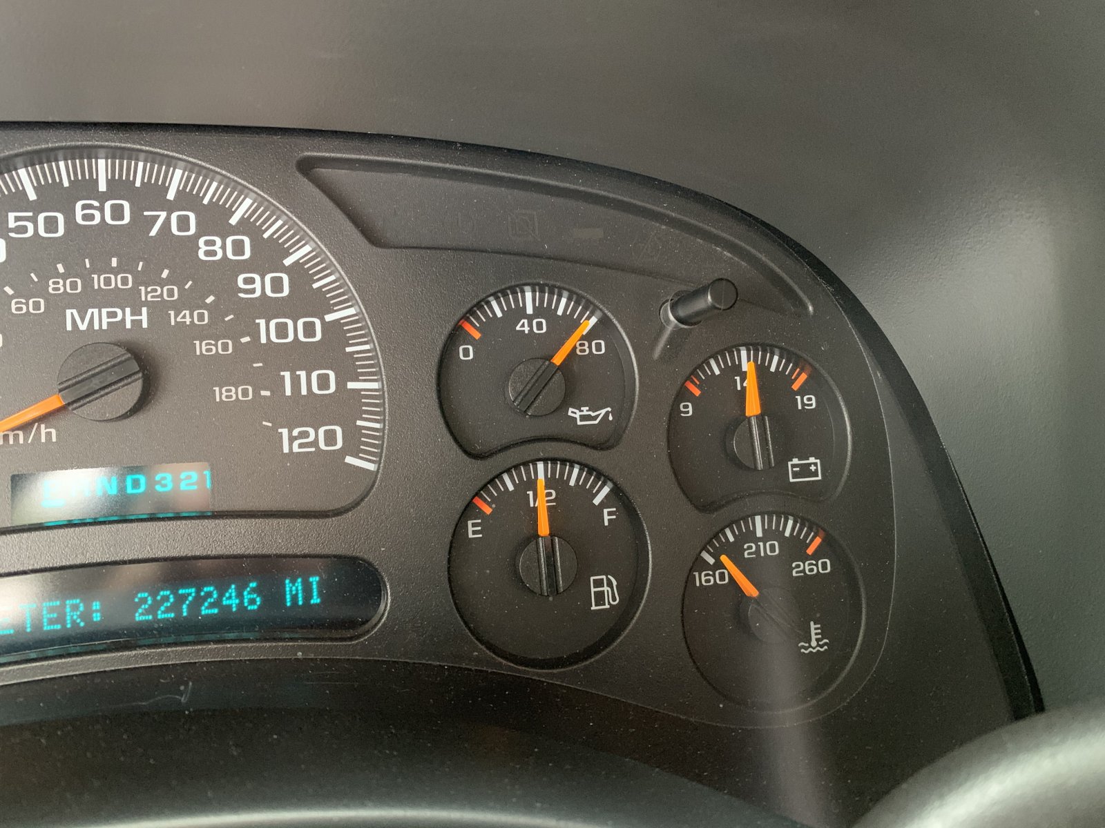

Shit dude... If you're pushing 300k and the most you've had to do is drop the oil pan, you're in good shape!!!!
With 4 wheel drive the front Differential is in the way of everything and makes the job much more time consuming than a rear wheel drive truck. I spent most my time cleaning the oil pan which was a mess inside and out. The Crossmember is located halfway under the oil filter so that had to be cleaned as well. I was surprised to see that the Timing Chain is just a tiny little single roller chain. I had every tool needed plus floor jacks and still had a tough time getting the truck back together but it was all worth it as now I have my oil pressure back the way it use to be.

Mine was literally cracked and very flat on the outside as well as the inside, someone asked if I went with a High Pressure pump, I did not, only Hi Volume. 60# is pretty sweet with an engine with 220k on it now !! The hard part was the Harmonic Balancer, luckily I found a Chryster 3 jaw and got it off, putting it back on was another matter, eventually welded a big socket on a air chisel and a few bumbs of the trigger she walked right on like it was greased! Whole job took me 9 hours, included a new Water Pump/Thermostat, Idlers, belts and 2 tensioners.
You did that job in record time. I spent several hours just cleaning the inside of the oil pan and the bottom of the engine. Plus all the pan bolts and the crossmember.
