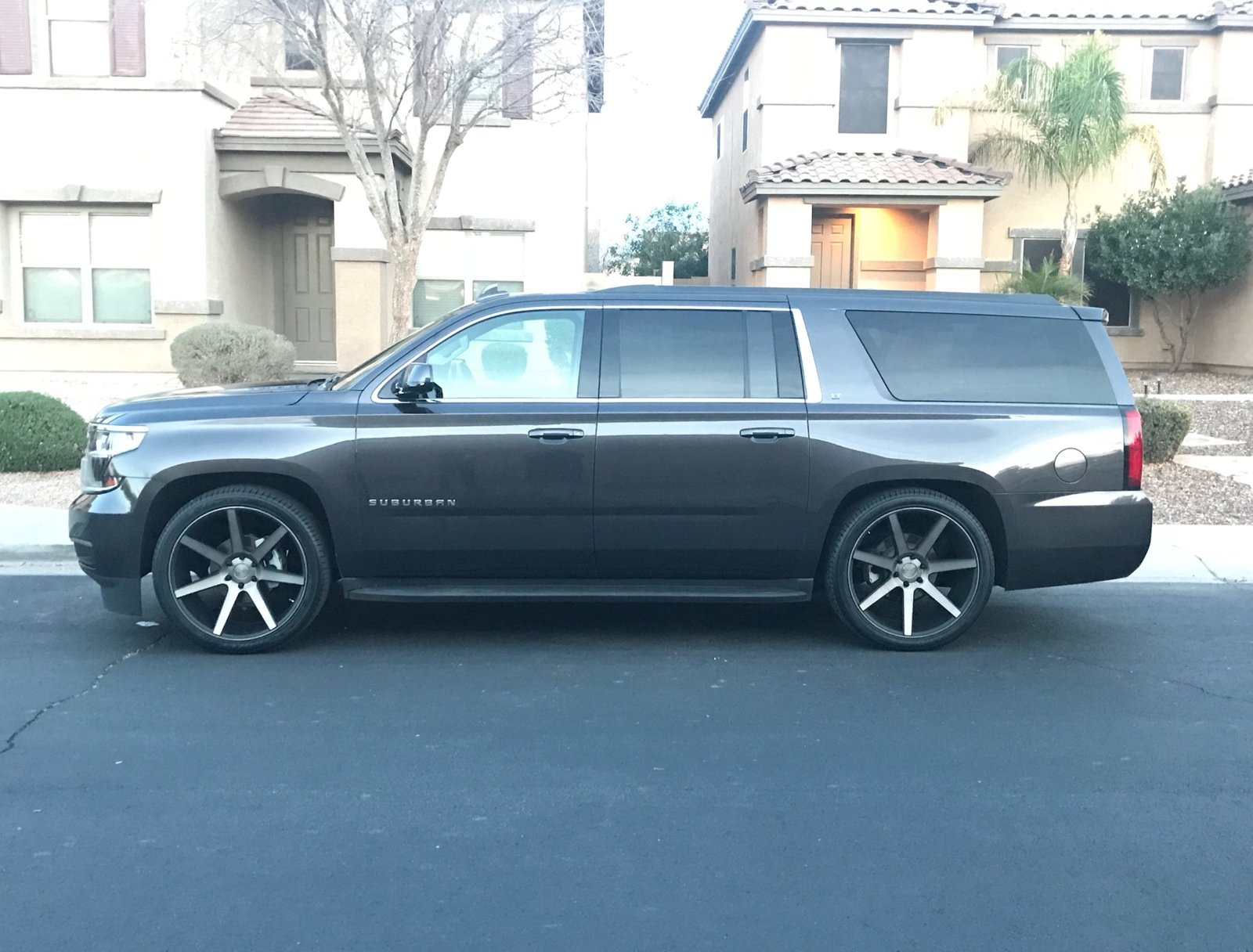

Tony,
Stock 2016 Suburban LT, so no Air Ride.
the rear sets pretty high. I lowered one of my previous Tahoe's using your kits, but wife doesn't want to take this truck all apart until she is out of the 3yr/36wrty.
Will removing the rear isolator & doing the heater hose mod "level" a Suburban? I just want to lower the rear a bit, and maybe get the running board to be level to the ground both front & rear.
"REAR LOWERING
  • Heater Hose??? Yes 5/8 heater hose. On the 15+ the top insulators are pretty thick"
