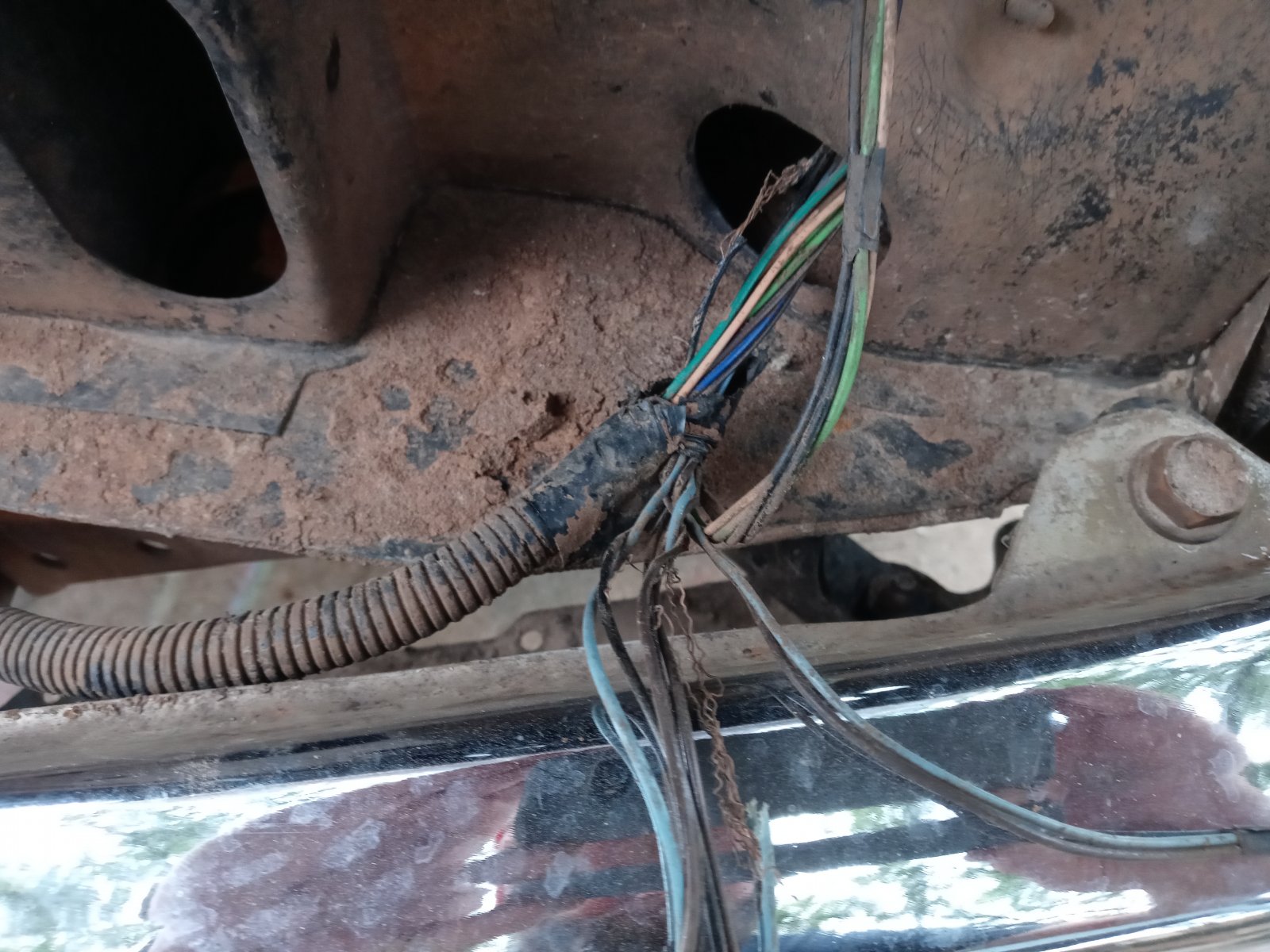

Those and breathalyzers! You did the best thing. Hope they didn't damage the wiring too much. I hate seein them, Always big problems.
