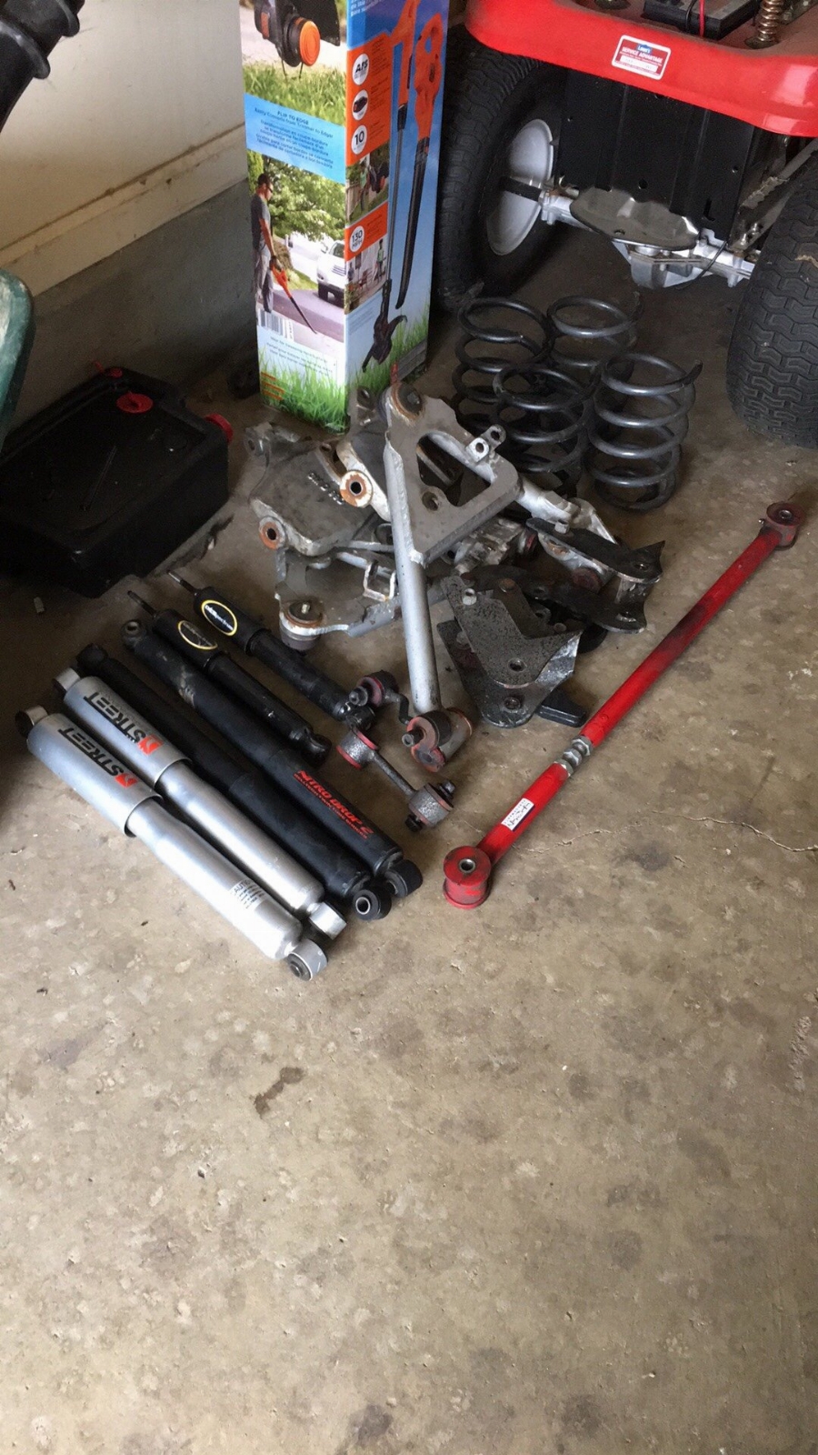

For best ride I will do Spindles in the front, and 3" coils in the rear. Also the free travel mod and the DJM sway bar end links. You'll be very happy with the setup.

Believe it's the Belltech kit was 759SP, make sure it's Street Performance shocks.
No keys in front; only spindles IMO. To many complaints regarding the ride quality.
