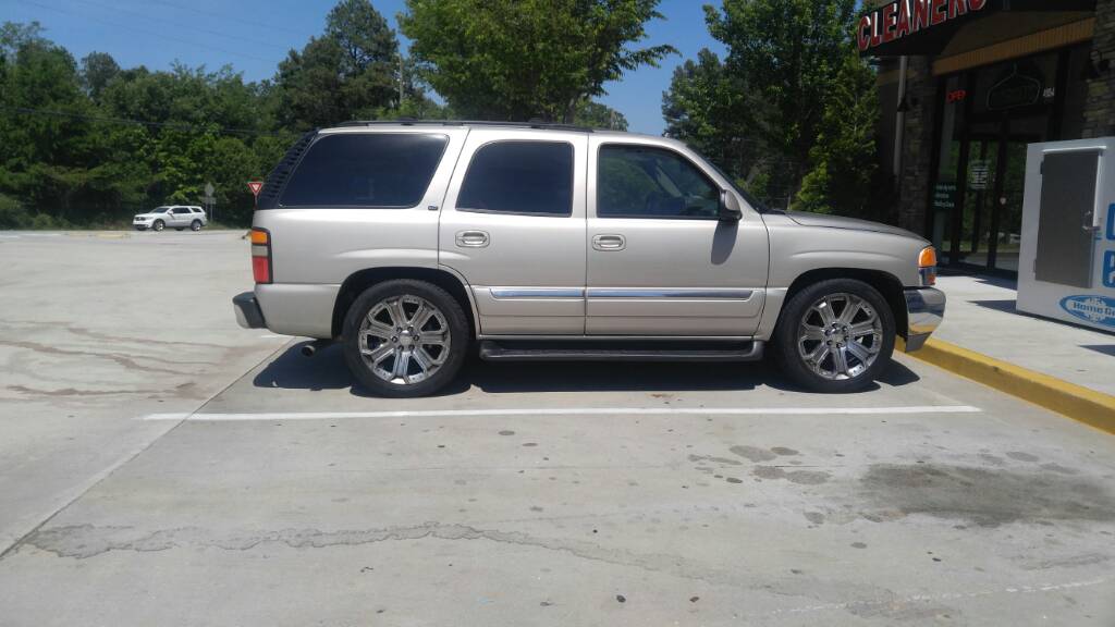

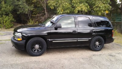

Mister H12

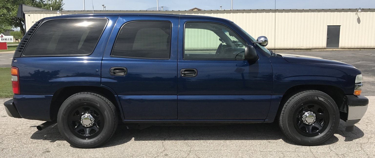

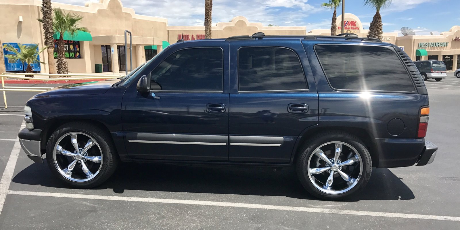

Model/Year/2x/4x/AWD:
- 2005 Tahoe LS 2WD
Advertised drop:
- 3"/6"
Fender height front/rear:
- 32.00/32.00
Front:
- LCA's : DJM 3" Drop
- UCA's : Stock
- Spindles : Stock
- Sway Bar : Stock
- T-bar keys : Stock
- Shocks : Belltech Street Performance
Rear:
- UCA: Stock
- LCA: Stock
- Springs : Norcal SS Custom 6" Drop Spring
- Panhard : Stock
- Sway Bar : Stock
- Shock Extenders : Yes
- Free Travel Mod : No
Wheels & Tires:
- Wheels : 18" Titan wheels, Powder Coated Black
- Tires : 265/60R18 Michelin Latitude Tour
Brief impression of setup:
NEED Free travel Mod (Ouch)!! Very noticeable change in handling characteristics. More of a "sporty" feel than a rocking boat. Takes curves like a dream, potholes.. not so much.
Future Modding:
Free travel mod.
Larger Sway Bars
Spohn adjustables.
22s
Etc..
Far from done but just had to jump on this post as soon as I dropped it! Too eager lol

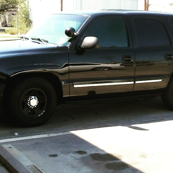

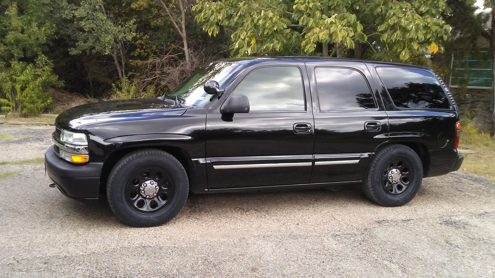

Looks good man, i too have the same drop. But i went ahead and added the panhard bar and djm swaybars also did the free travel mod. How does yours drive? Mine is good except abit bouncy in rear. And thats without the bumpstops (removed). Hit me up.
Mister H12
Undercover Racecar
May 12, 2012
217
West Tennessee
It handles much better being low to the ground. I STILL haven't cut off the bumpstop brackets so the rear hits on big dips, just keep putting the project off. I'll be putting the panhard bar on for sure but I really want the full kit, just working on other stuff at the moment

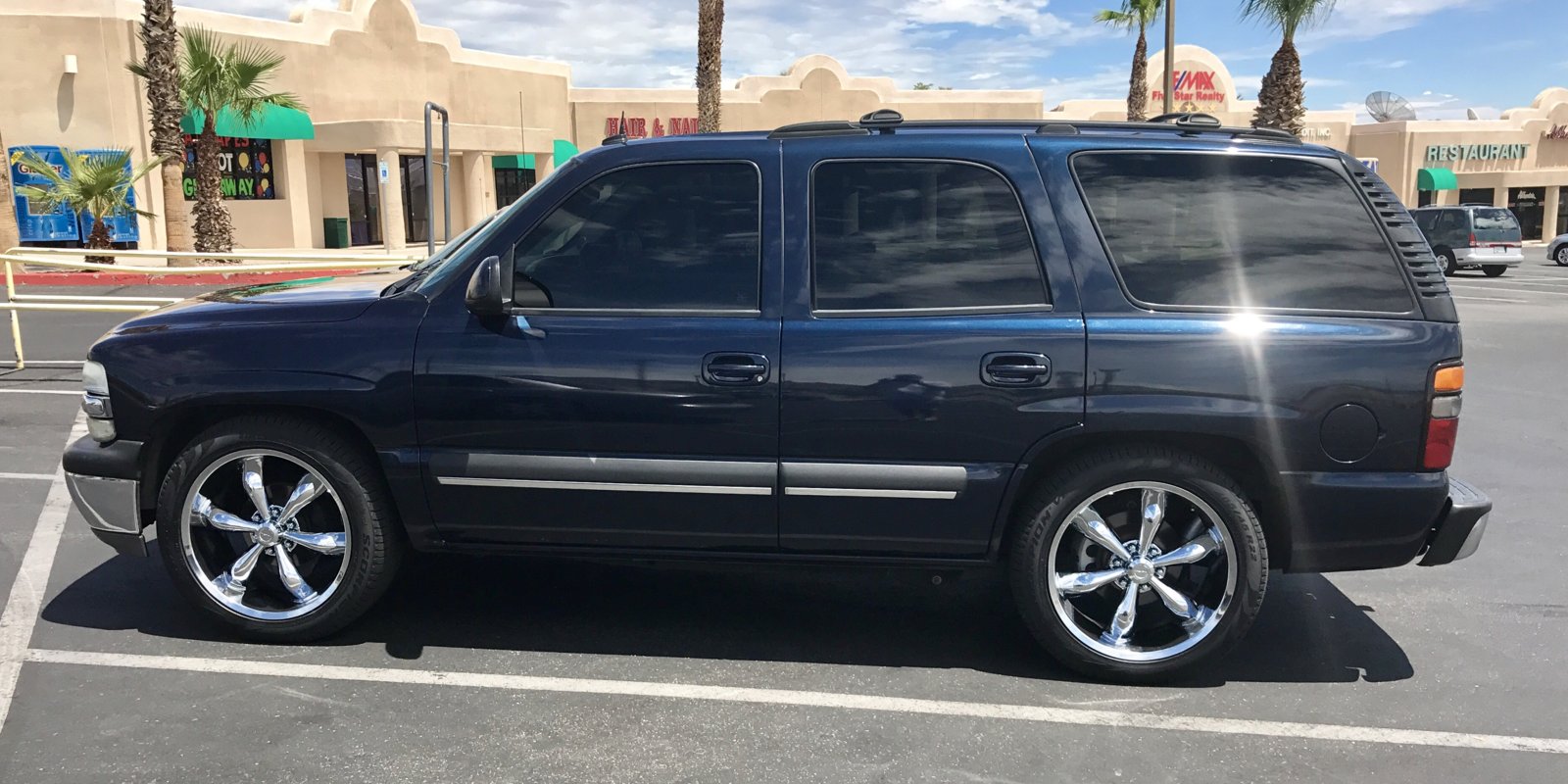

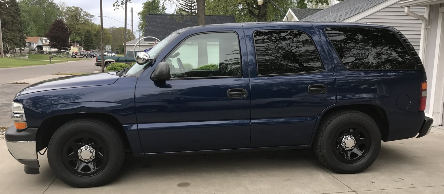

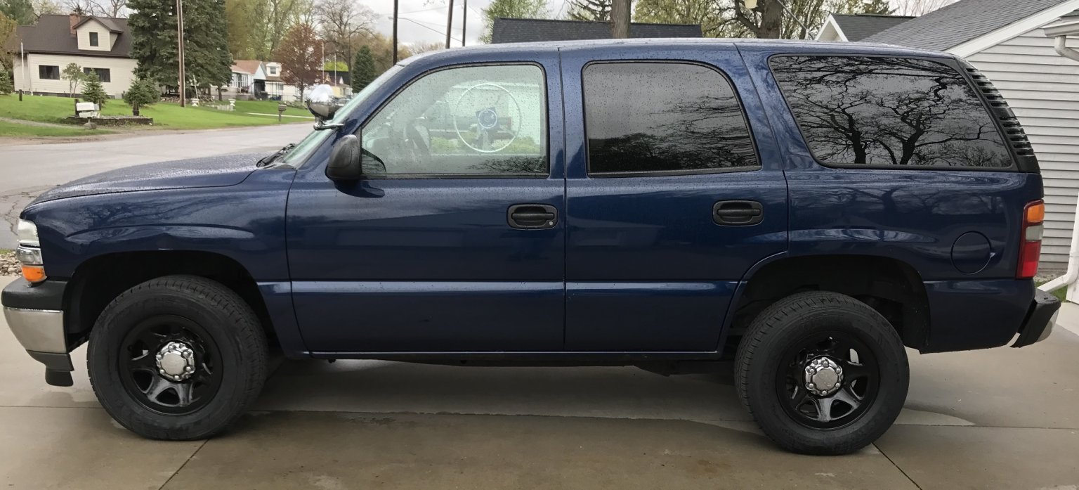

chipf
Dec 13, 2015
Shorewood Il

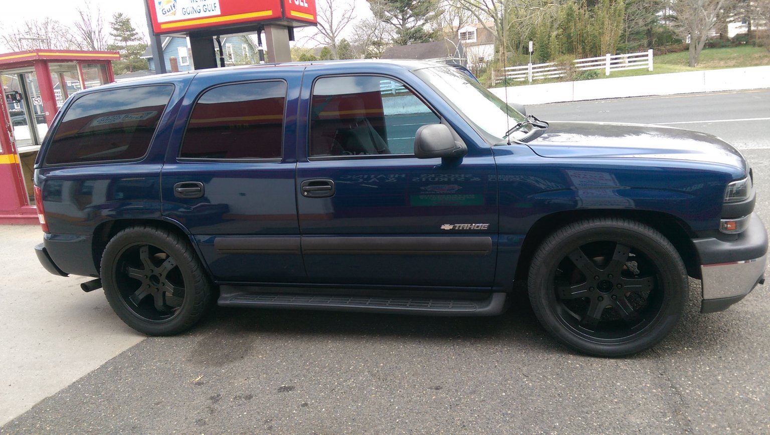

2002 Tahoe
Front: Upper and Lower DJM control arms
Rear: DJM TB springs
Tire: 275/50/20
Front shocks: DJM
Rear shocks: Belltech Street Performance
DJM rear hardware kit and free travel mod

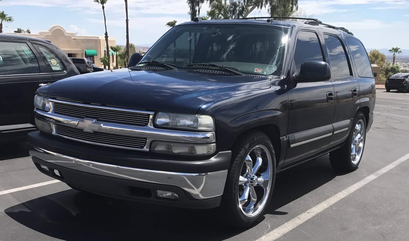

great looking truck. whats the drop on it ?
Thanks

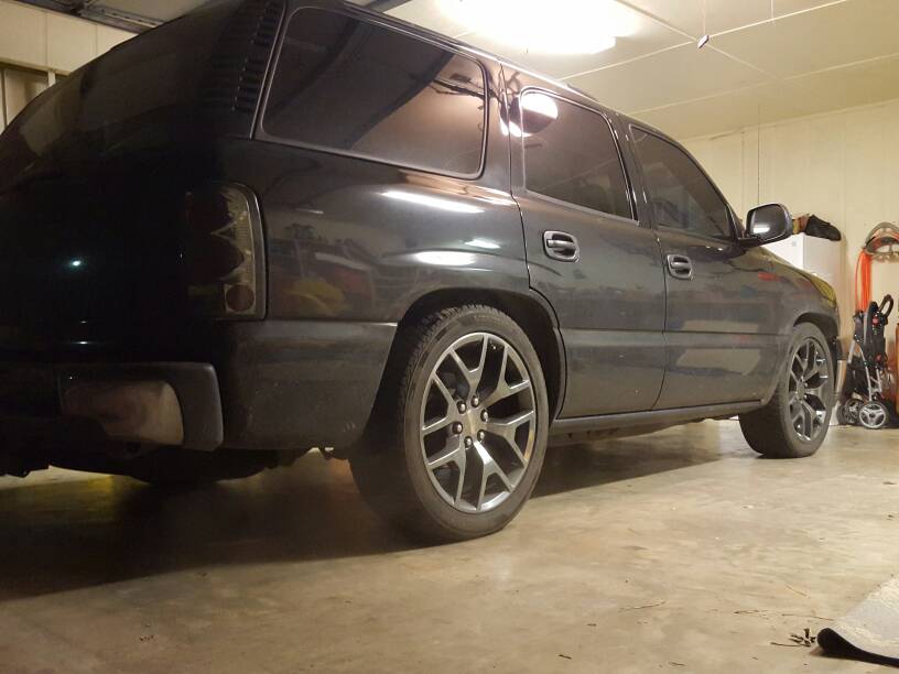

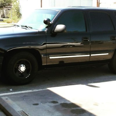

nharkey85
May 24, 2015
282
112
Alabama

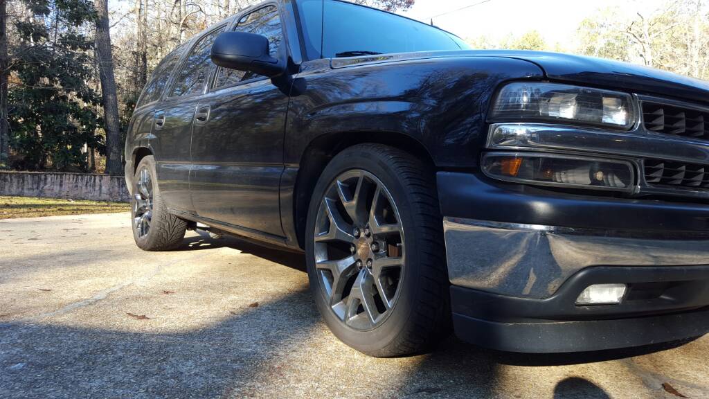

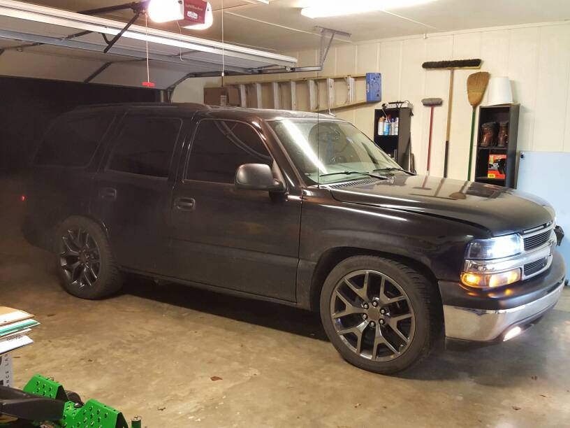

2005 Tahoe LS 2wd
22x9 et31 replicas
275/45 22 Hankook Ventus ST
NORCALSS custom 3/5-6 drop + extras
Ground to fender averages 32.25". Got a touch of chevy lean by .25". A tweak of the key might fix all that. Im almost positive im going down to 265/40 22 for the next set of tires. I need to do a little plastic trimming in the rear.
Front
DJM 3" drop LCAs
DJM UCAs
Belltech SP shocks.
Rear
Norcalss 6" spring
DJM trailing arm relocators
DJM shock extenders
DJM sway bar links
Belltech SP shocks
Spohn adjustable lower arms (delsphere joints)
Spohn adjustable upper arms (delsphere joints)
Spohn adjustable panhard bar
Free travel mod
Norcalss' rear bumpstops
Updated pics as of 2/11/15

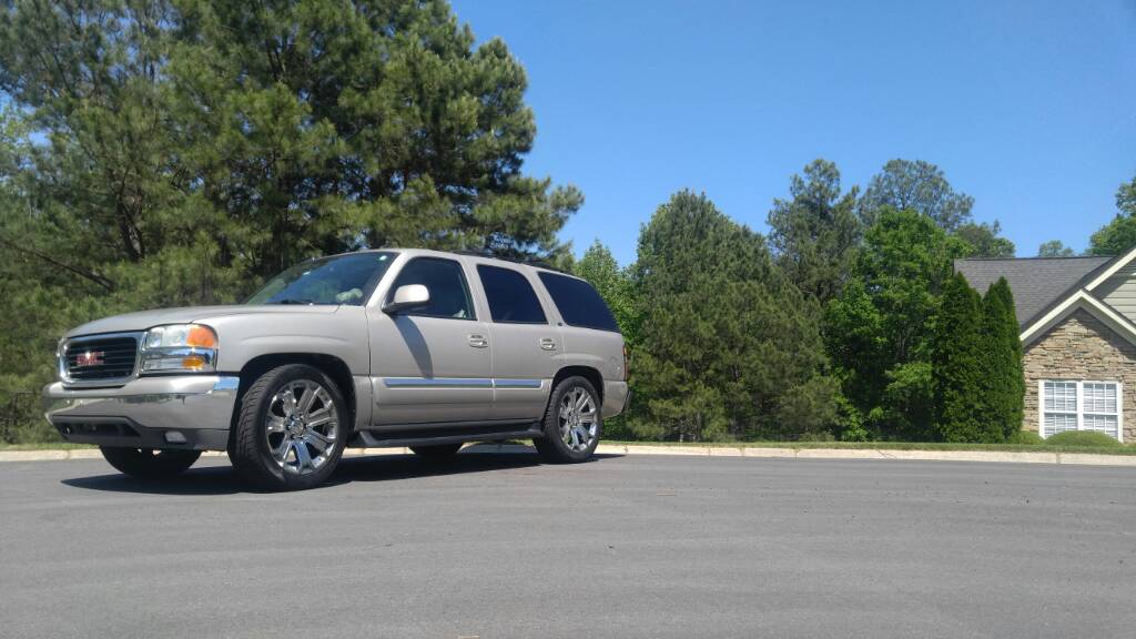

06' GMC Yukon Denali
22x9 CK375's wrapped in 285/45/22 Bridgestone Duelers
Truck is stock minus the components listed below:
Belltech 2 3/4 Kit Ended up going no spacer so 2/4.
Details:
-New Lowering Springs(part of the kit)
-New 2" Drop Spindles(part of the kit)
-New DJM Rear End Links
-New Spohn Adjustable Panhard Bar
-New Axel Bumpstops
-New Shortened Autoride Links
-Completed FREE Travel Mod including grinding/painting
-Added Airlift Helper Bags 60742
Current Measurements(Ground to Fender Lip):
Front : 33 1/2"
Rear: 34"

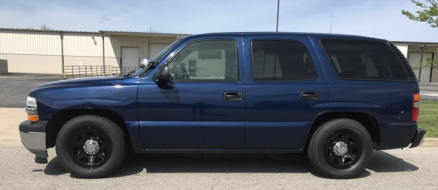

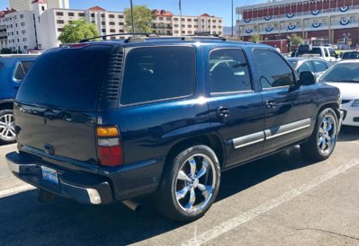

sammy6659
Apr 29, 2016
Tahoe What's Stance

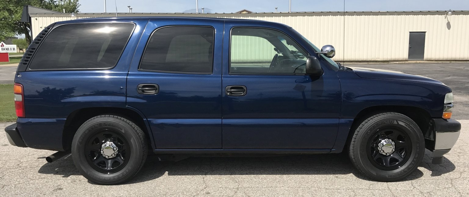

- 2005 Tahoe LT
Advertised drop:
- 3"/5"
-32.00/32.00
Front:
- LCA's : stock
- UCA's : stock
- Spindles : Mcgaughys 2" drop
- Sway Bar : Eibach
- T-bar keys : Gone
- Shocks :QA1 Coil Overs (custom brackets, etc) No more Tbars
Rear:
- UCA: Spohn adj.
- LCA: Spohn ajd. w/ Mcgaughys relocator kit w/ endlinks
- Springs : Beltech 5305
- Panhard : Spohn adjustable
- Sway Bar : Eibach
- Shocks : QA1 adj.
- Free Travel Mod - Yes
Wheels & Tires:
- Wheels : 20" GM SS chrome rims
- Tires : 285/50/20 Nitto420
Brief impressions of setup:
Rides good for being lowered. Firm setup, but handles 100x better. (with old setup)
How low is that....and would you be able to put 26s
Tahoewhat
Ballin' on a Budget
Sep 20, 2009
3,720
24
TX
It was about a 3 and 5 inch drop. I don't think you would be able to put 26' on it. 24's were close. With the right back space maybe but not sure.
