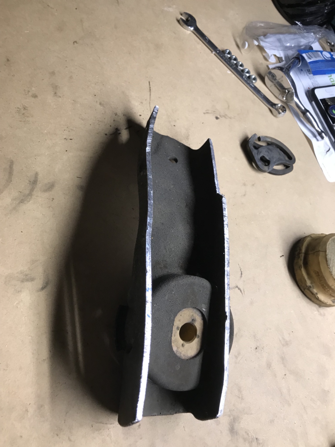

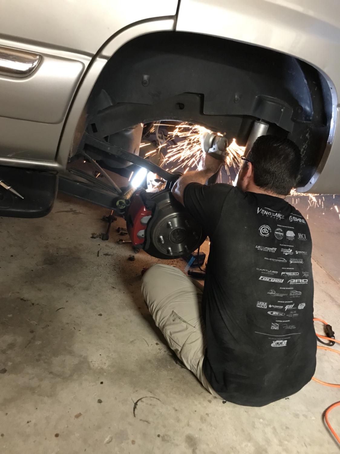

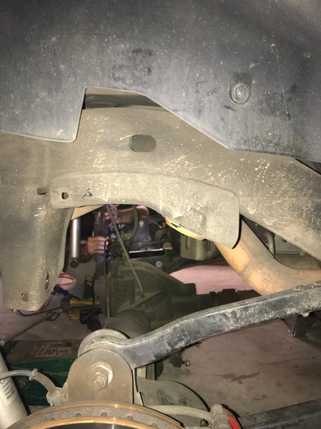

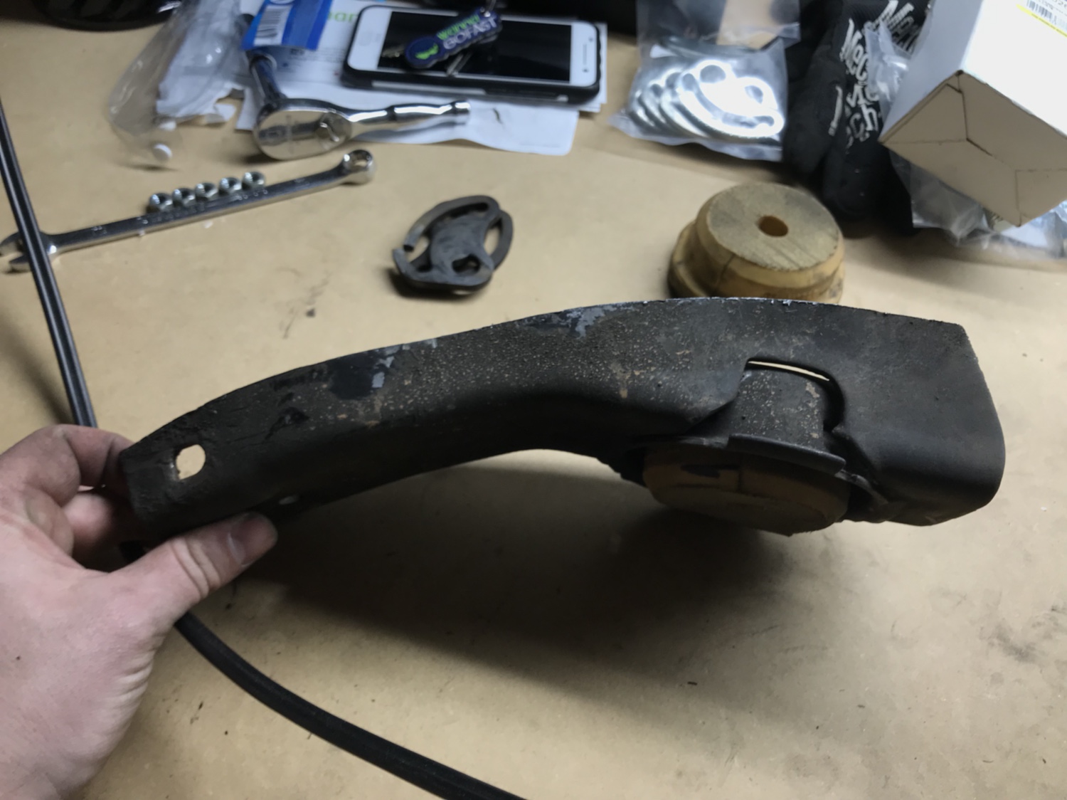

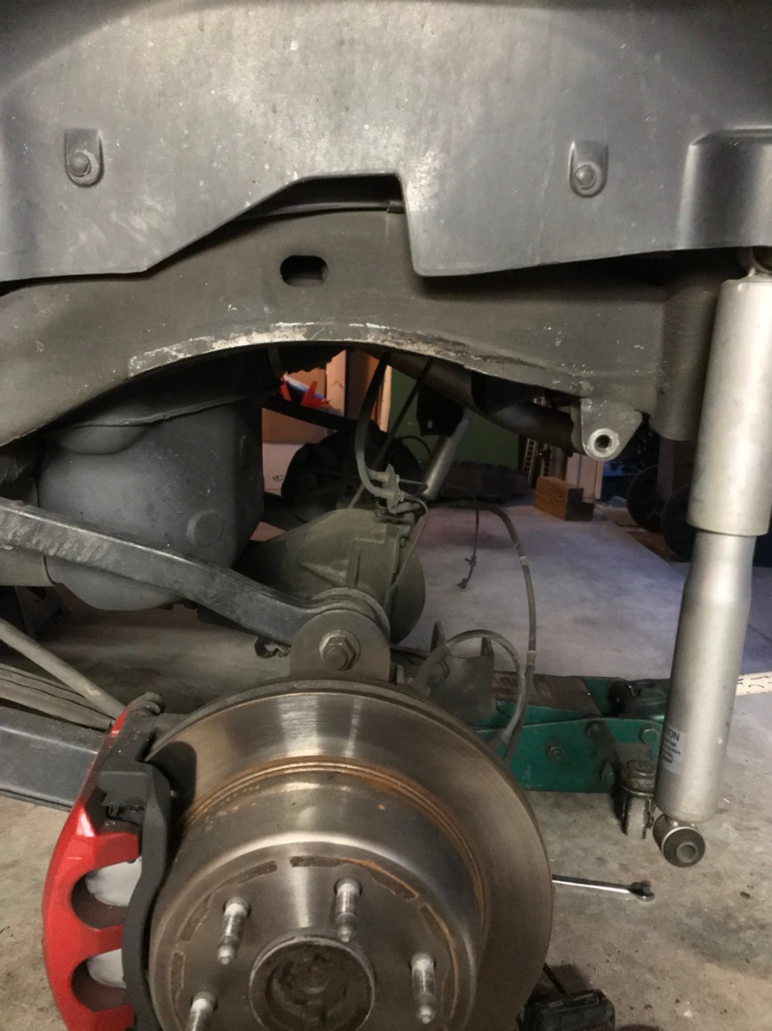

Should be no effect on the alignment pulling the spacers. Can't recall on the rear springs, but that free travel mod is must if you haven't done it. It will ride like crap if you don't cut that bump stop off. That is more key than the spacer or the springs in the rear. @04charcoalhoe

Yes definitely did the free travel mod. Getting alignment tomorrow.

Free travel mod

@Fosscore how far away are your rear bump stops from touching in the rear? With the 1" spacer in the rear and the free travel mod done it looks like I'm only 2 to 3" at most from touching now.
