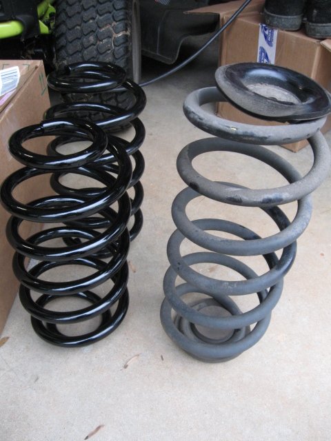

-Stock keys, passeneger taken completely out. Drivers only cranked 4 turns to even out measurements.
-Belltech 3-4" rear spring kit with bumpstops, shock relocators and cups. Need to trim the bumpstops or do the free travel mod cuz I only have ~1/2" of travel right now.
-Belltech SP shocks all around
-Belltech sway bars front and rear
-GMC Denali 22s with 285/45/22 Toyos

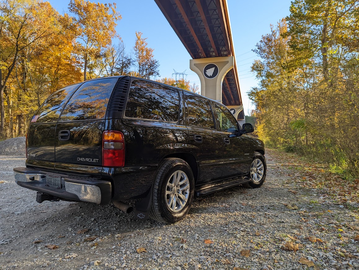

Did you use the 1inch spacer on the rear coils? I'm bout to get same kit. Thanks
Yep, those pics are with the spacer in. A year later, still have not done the free travel mod. It rides ok, I put the stock bumpstops in and trimmed them to where they’re about 3/8” out of the pocket.
I’ve got 2” spindles, just gotta get an adjustable track bar and pull the rear spacers to go down to 3/4. Might trim the springs and leave the bars decranked to be closer to 3.5-4/5
