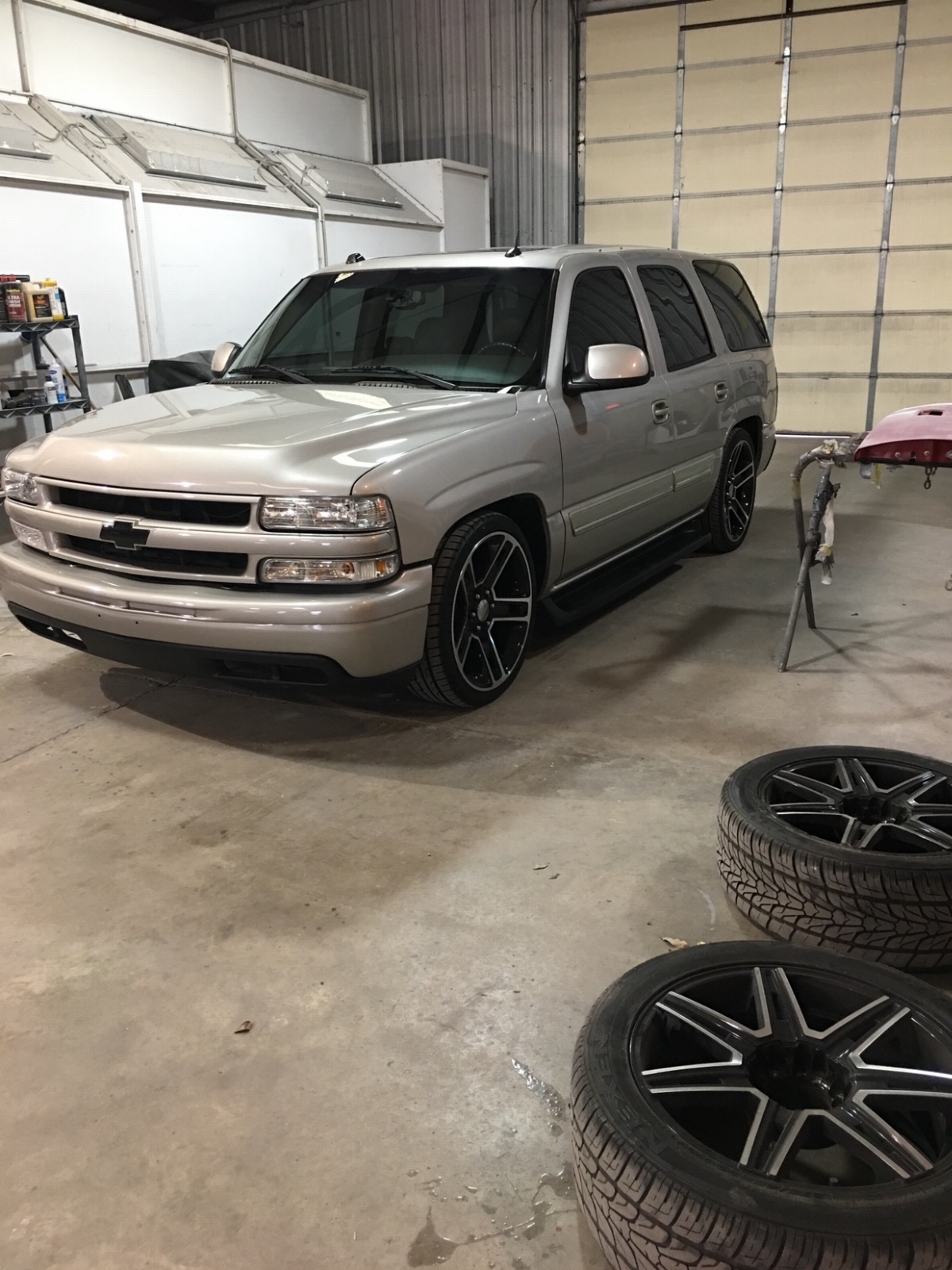

05 2wd Tahoe
Front :
2” spindles
3” DJM lower control arms
3” keys
Monroe OEspectrum shocks for a 97 Nissan hardbody ( tried many shocks including belltech, cal max etc and these rode the best for me )
Rear :
Tony’s 6” ( half coil cut )
DJM Trailing arm kit with shock extenders
DJM sway bar links
Spohn panhard bar
Belltech Street performance shocks
Free travel Mod
Cross member notched ( above driver side mounting point of panhard bar )
Tires - 265/35/22
Front 30.5
Rear 31be577ae4509d6a917d64a133bef5ab67.jpgdf7d20f5023273518bf3e62ed78d07f3.jpg19051041e6cd27bf67876780e3187496.jpgce078e3ac40051f98a3ecc3f180a13a1.jpg
Was this tonys 3/5-6 kit?
